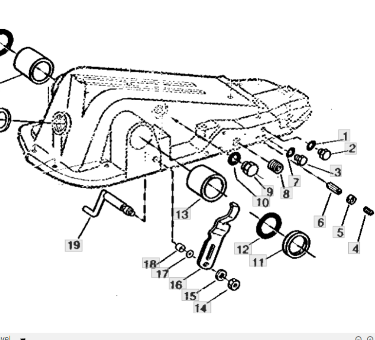

I had fired this tractor up after sitting 10 years. I changed all fluids, filters. power steering works, pto works, the 3 pt hitch worked fine before I changed filter/fluid. now it may lift, it may not lift, when I try to lower the 3pt it will not lower by the lever, there is a little handle under seat. if I loosen that the 3 pt will drop, not sure what to check next. thx

You can download an operators manual for free at Search for Equipment Publications - Technical Information Store. There's a short lever(item 16) under seat called load & depth control lever. Have you attempted to relocate lever to a different position? Have you turned rate of drop bolt a round CCW?

thx sir, the short handle directly under front of seat what is its purpose? thx
did not touch 16, is rate of drop bolt the short lever with a bolt through 2 nuts directly under front of seat, i did take that out to see what was in there. thx
