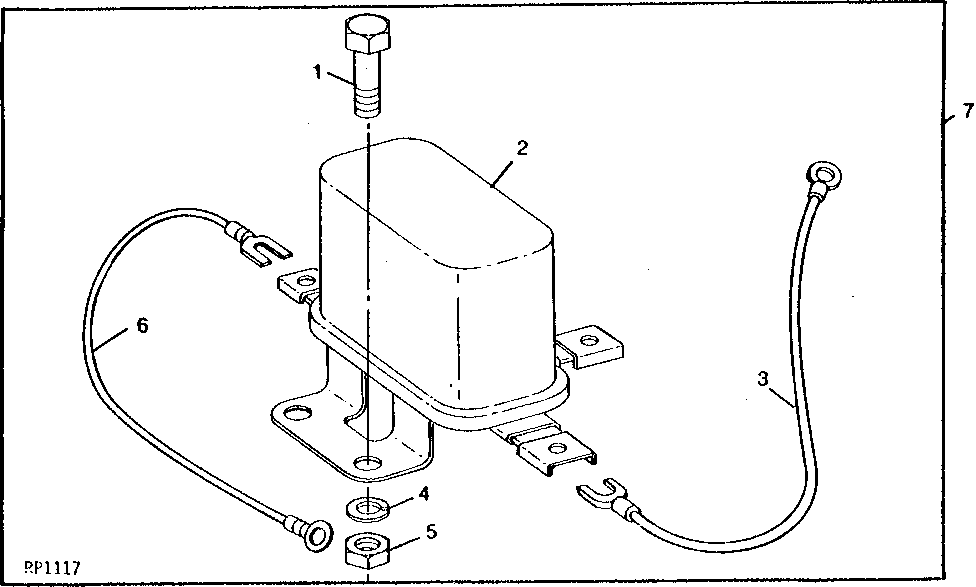

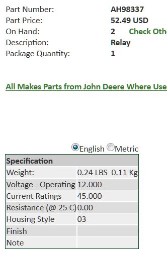

I agree that the amperage draw shouldn't be too high. JD calls the device a relay not a solenoid but I don't know the difference in the nomenclature.
AH98337 Relay ADD 52.49 USD
Here's the spec's on the JD relay.

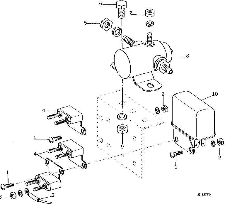

Did old relay resemble parts key #8 from a 4020? AR46334 Relay ADD 37.79 USD or from an A&I dealer A-AR54484 Relay - 30.82 US
/ 1971 4320 cab electrical issue
Yes that is what it looked like. Thank you very much!

The AH98337 is the one you want. The other solenoids are starter circuit relays. They are not designed to be engaged for extended periods of time. The windings quickly overheat when left on for more than a minute or two at a time.

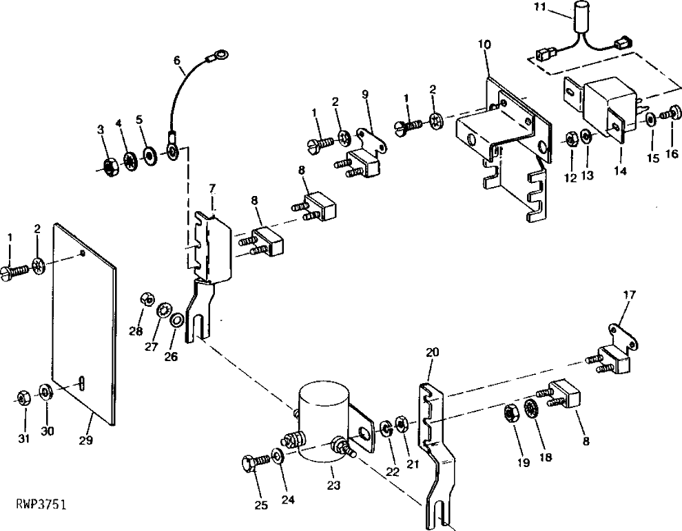

JD also utilized the AR46334 for accessories. Here's a parts photo for one used on early 4430 HFWD & cab accessories
