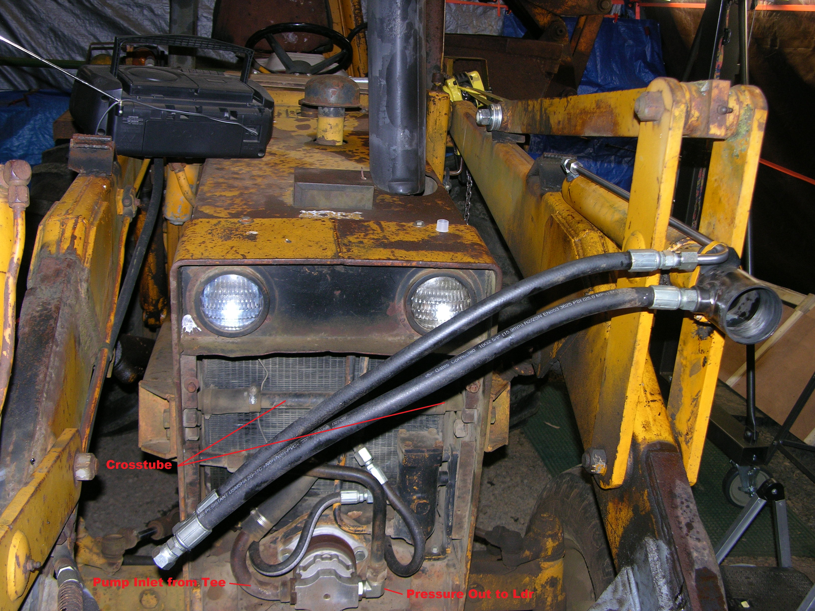

Here's a marked up pic showing the crossover between loader frames, etc DSCN3278MkUp.jpg

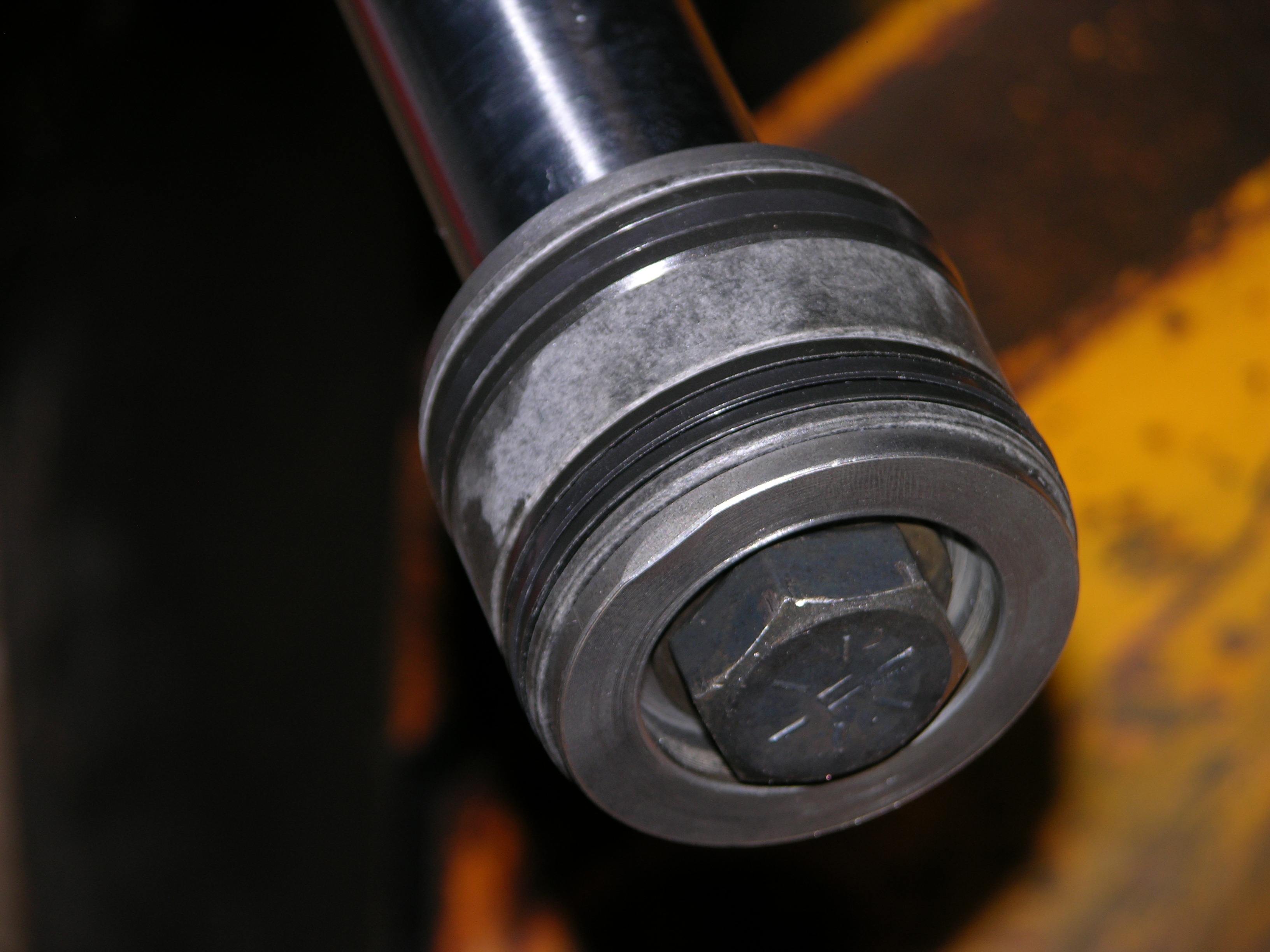

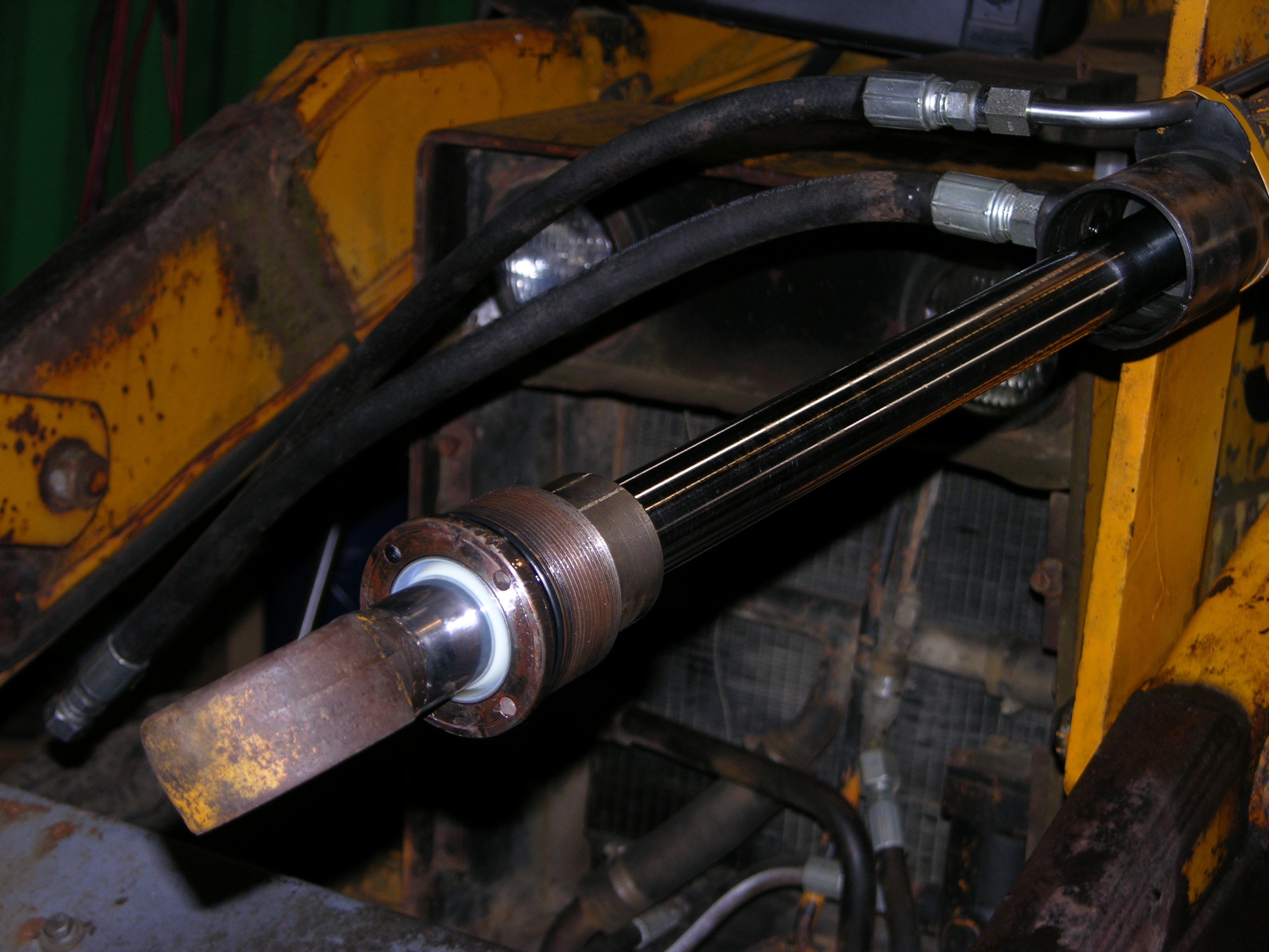

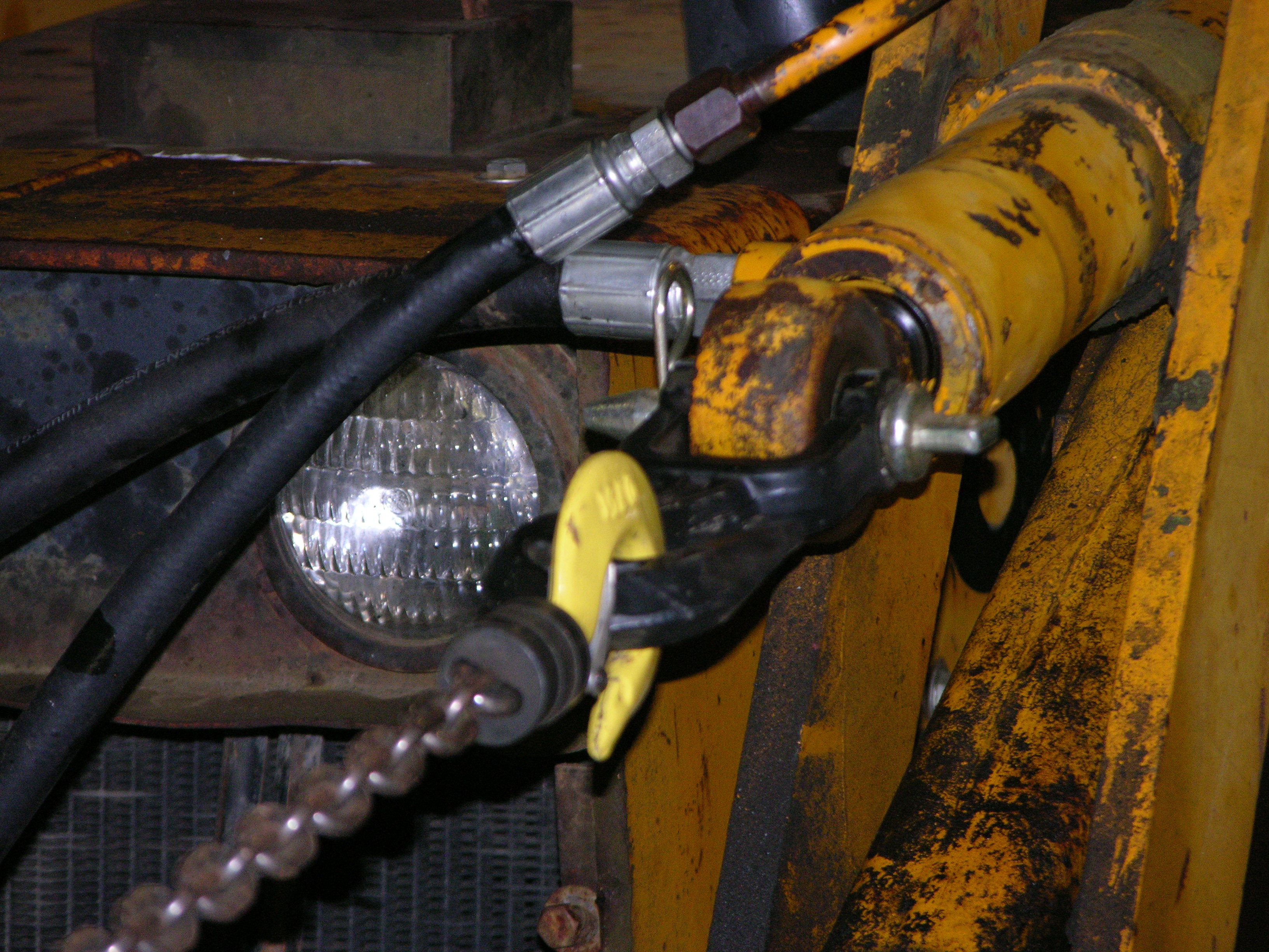

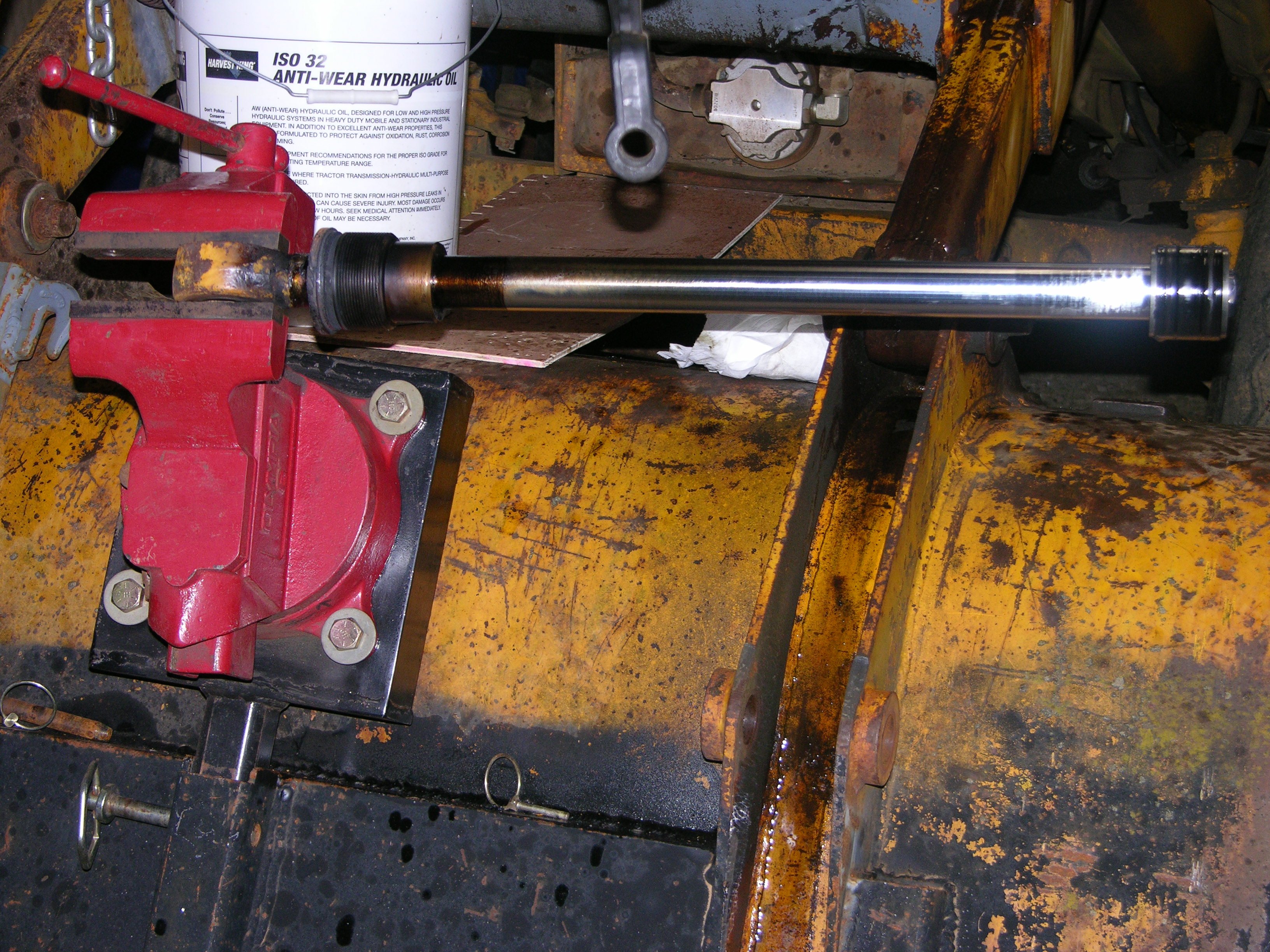

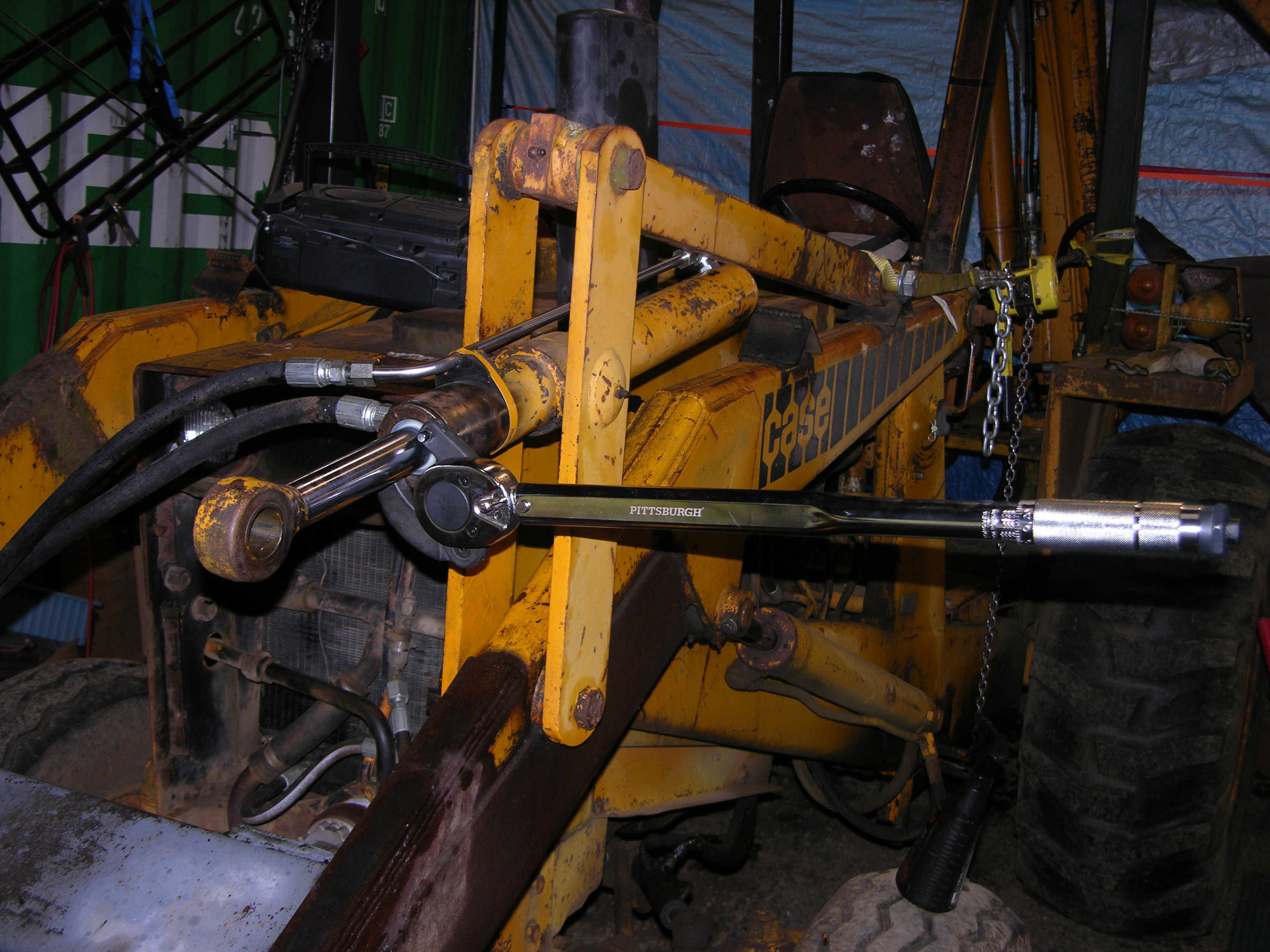

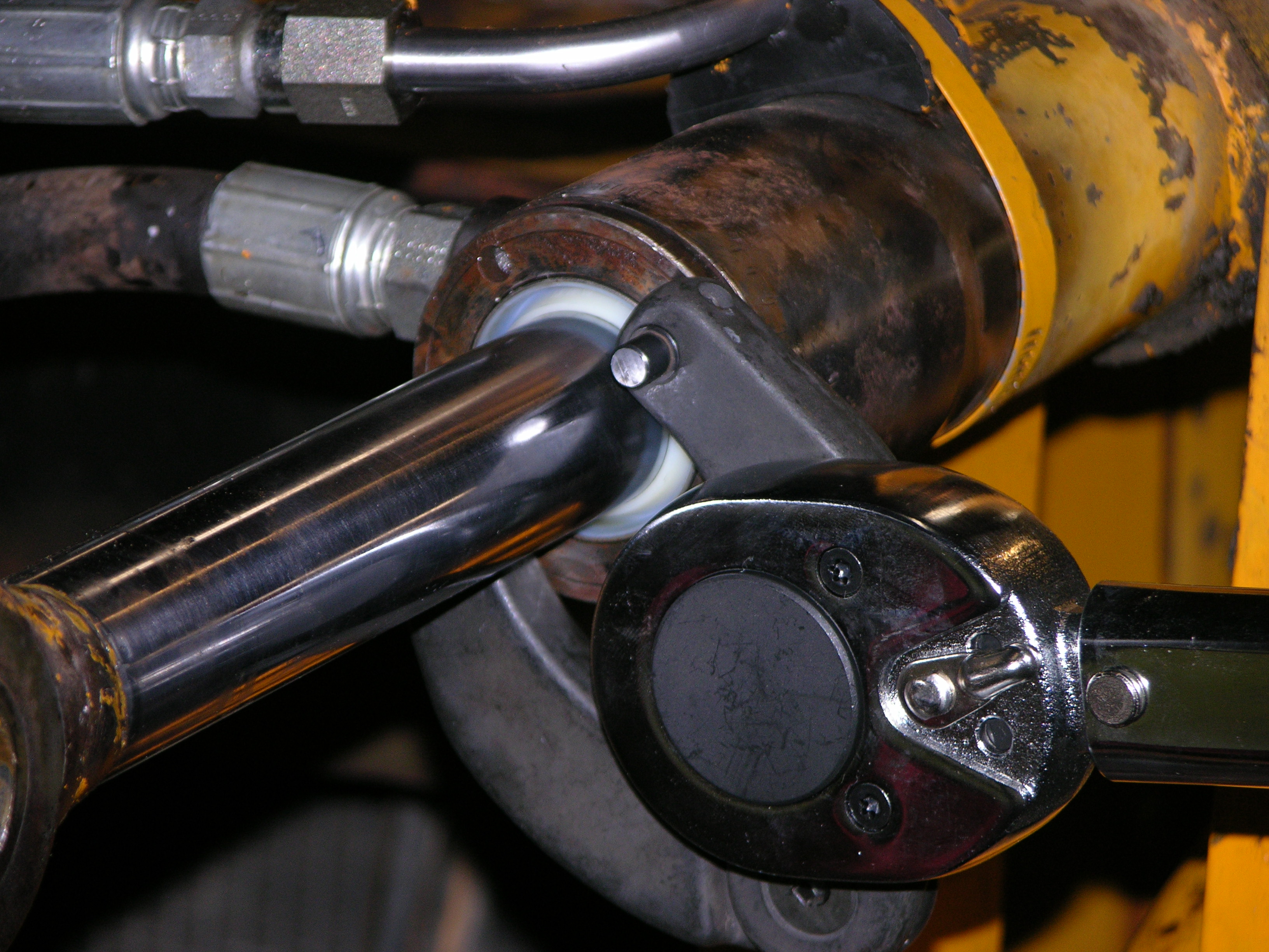

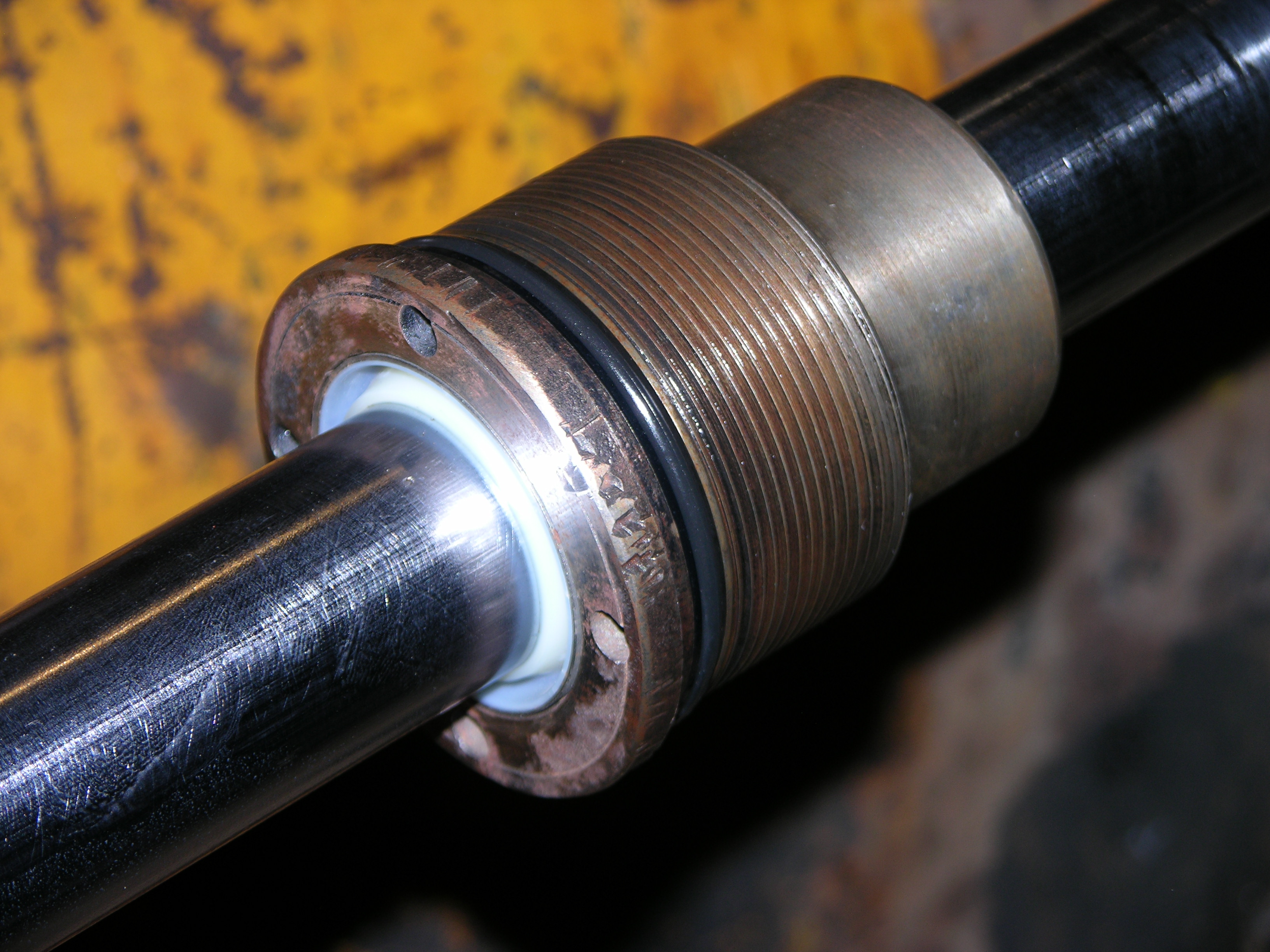

Here's a few shots of my rebuild of one of the curl cylinders on my 580B; they'll probably GENERATE more Q's than they answer, if you're curious ask away :laughing:
DSCN3261.JPG DSCN3263.JPG DSCN3272.JPG DSCN3275.JPG DSCN3281.JPG DSCN3282.JPG DSCN3283.JPG DSCN3285.JPG DSCN3286.JPG
Oh, and yes there's even a torque spec for tightening the gland nut; if you don't have a manual I'll have to look it up, let me know... Steve
Oops; hydraulic oil - I use generic AW46, it's a bit heavier than recommended for NEW machines but works fine, maybe doesn't leak QUITE as much til you get ALL cylinders resealed :rolleyes:
