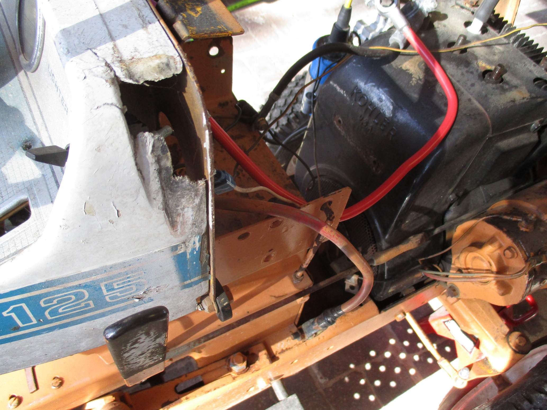

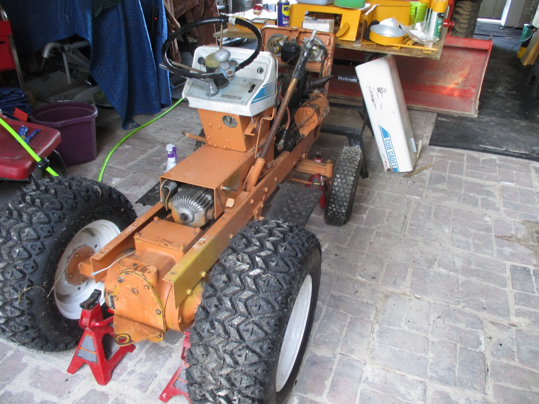

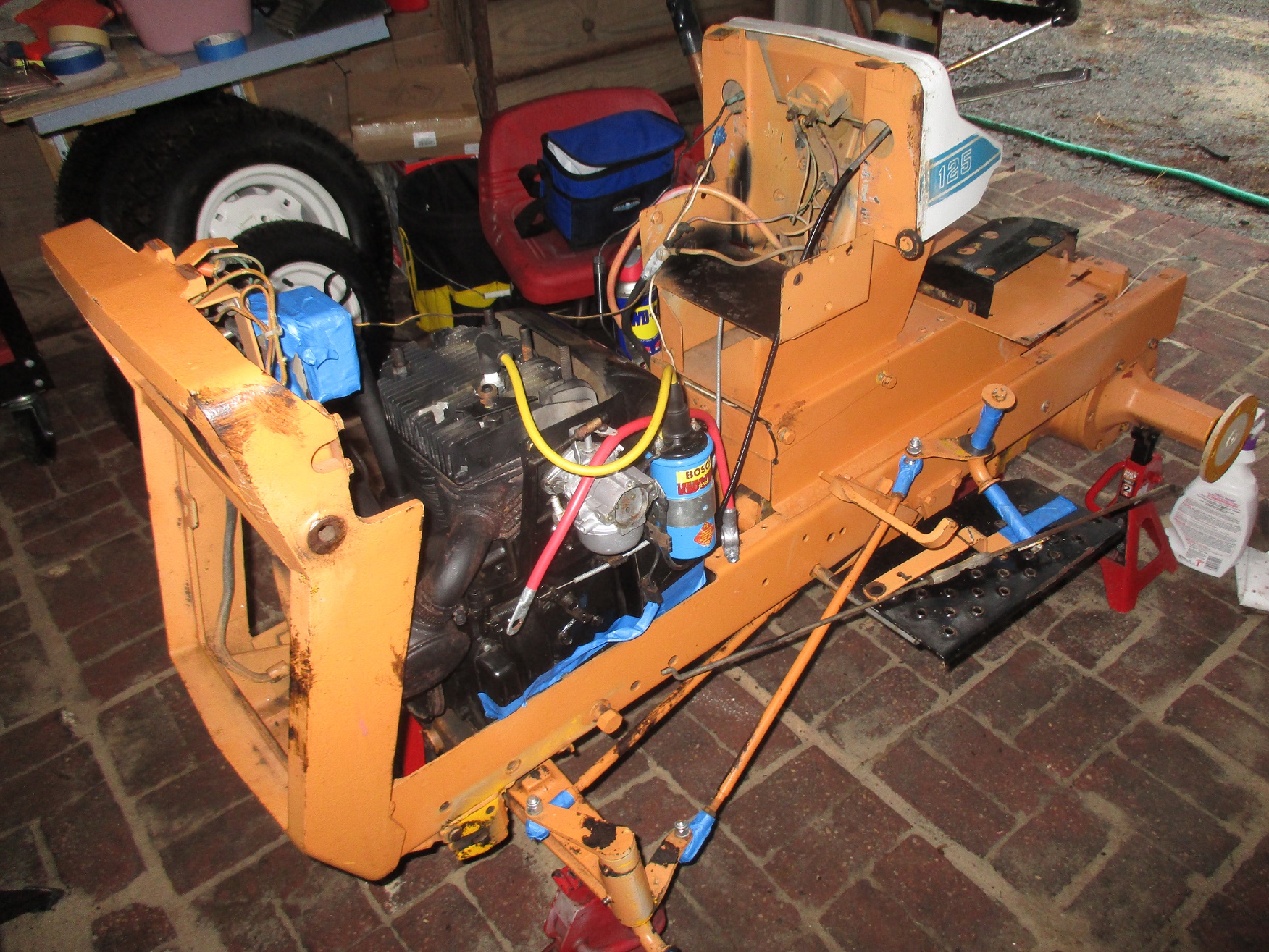

Over three years ago I had to put aside a partly finished renovation due to family problems.
Now I'm finally restarting this project, and have quite a bit done, but a long way to go.
The engine was rebuilt shortly before I got it, by a mechanic in a shop, and has only a few hours on it. It ran fine, and the
hydro trans shifted fine. And then it went to sleep.
My initial question is with the Kohler engine color. A K301 12 hp flat head. I think the oem color was black
and this poor thing has had black paint slathered all over it.
Need some major TLC. But I've seen these old CC's with yellow engines too, with black
circular cooling air intakes. And I've seen the air cleaner painted
a variety of colors.
Yellow paint means you can see what's going on in there. Black paint means it's a dark hole.
Anyone know if CC ever did paint their engines yellow, or part yellow or are these all owner mods?
And yes, of course, does it matter?...this isn't going to the Grange Show but I also would like it somewhat authentic.
This tractor will be a lawn queen, I have two others, so I kept with the original period skinny front tires, which should do fine for a water cart puller.
New Bosch coil and condenser, new spark plug wires, new battery cables, decals, throttle and choke cables, fuel line, carb fully redone. And tires. No intentions of messing with the hydrostatic drive other than
changing oil and filter. Would likely do more harm than good and there are some unusual instructions on these first gen hydrostatic adjustments.
And for sure I have some fiberglass work to do.
So, black engine or yellow? Which would you choose?
tomorrow's project is taking off the motor generator and giving that some separate TLC.

Thanks, I knew I had seen a yellow engine somewhere

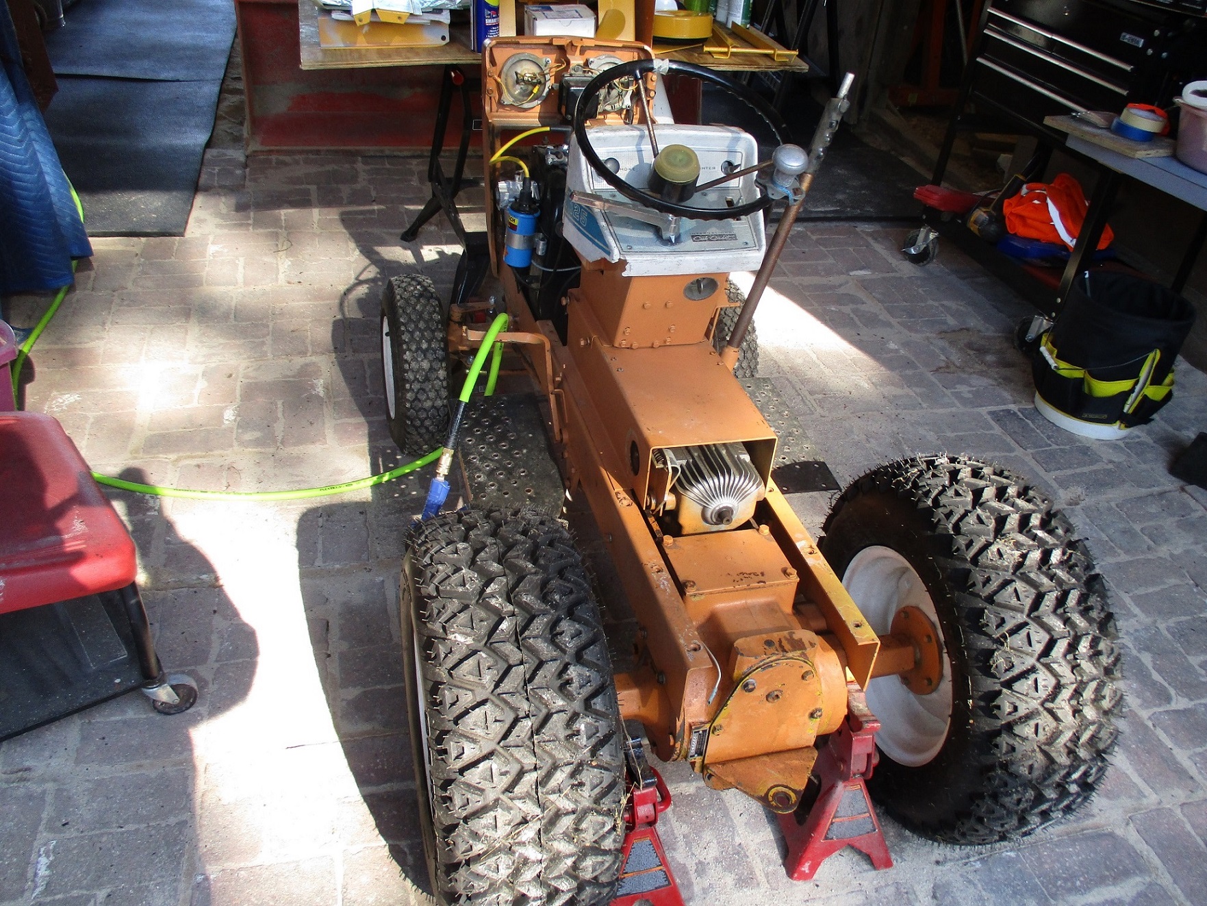

wheels are off and cleaned, disappointing to find rust on the rears even though they were painted three years ago and sat in a garage. So much
for Rustoleum's magic powers...
Generator off for cleaning and painting. The thing weighs a ton, remarkably heavy. Must be a lot of copper in there.
I have some wobble in the front spindles. Plain wear I'm sure; this CC had a tough life. Trouble is there aren't any bearings or bushings in there which one could replace to take up the slack. Wear pattern is clear on the spindle but I'm not replacing the spindles for a tiny bit of wobble on a barn queen.
More pics to follow. Very rainy weather coming in and I might get a chance to get some serious sanding and prep done. I've degreased it once; now I need to get on the creeper and get underneath where it makes sense. With all of the mower apparatus off, it's pretty simple underneath.

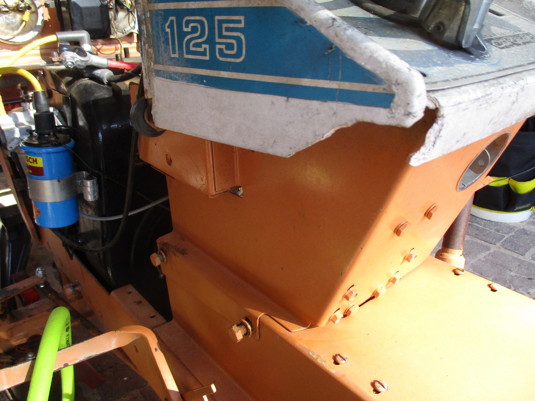

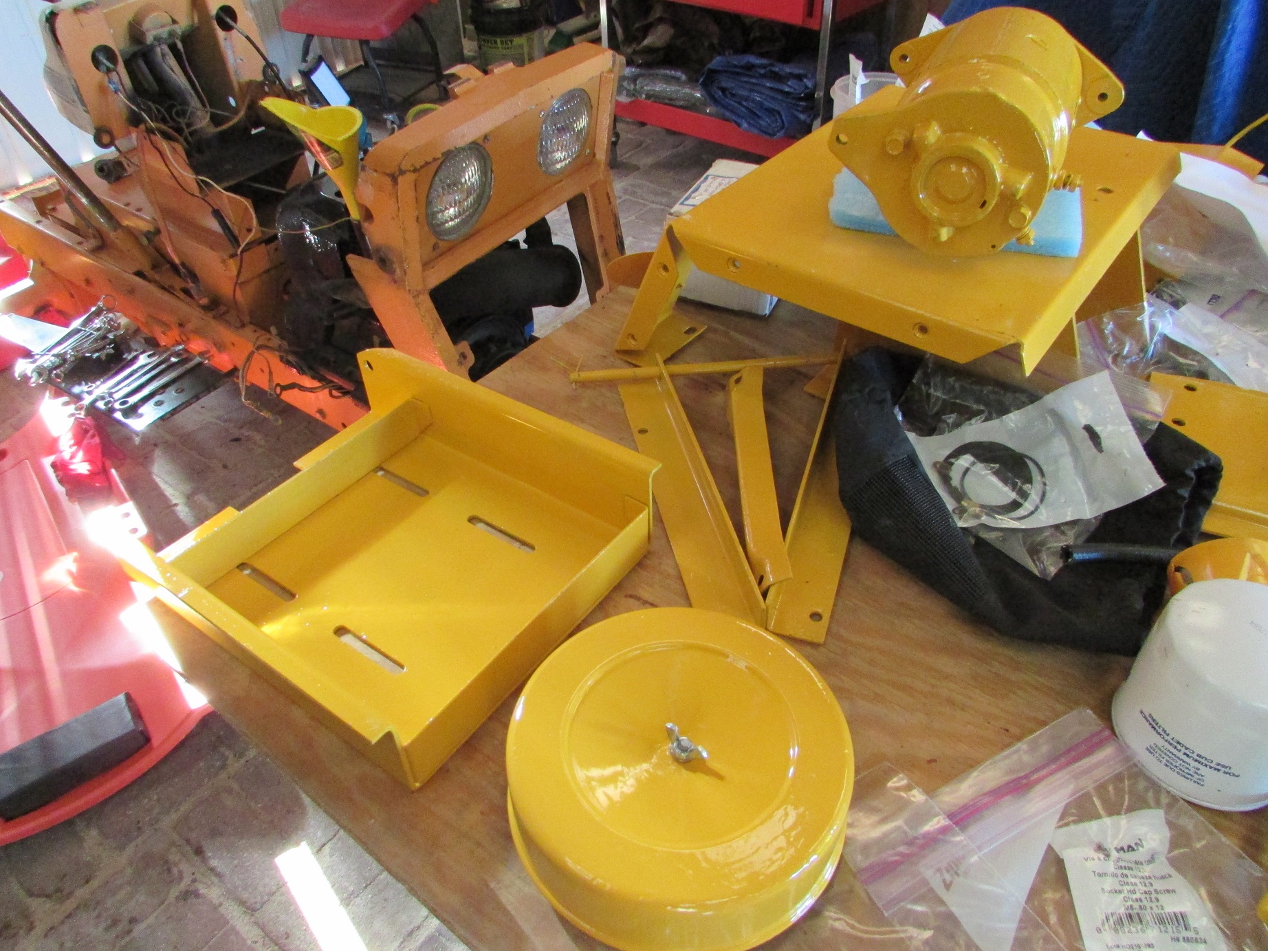

made good progress today while it poured down rain outside. Got the entire unit clean enough for now, will wipe with isopropyl alcohol just before I paint.
And then got a little blue tape time in.
Decided to leave the engine black. It is well painted except for one shroud, which is easily done, and if I repaint, it's three more layers of paint on top of an already thick layer of "legacy" paint redos. At least the air cleaner will be yellow, and I am taking the time to get the bolt heads painted the right color.

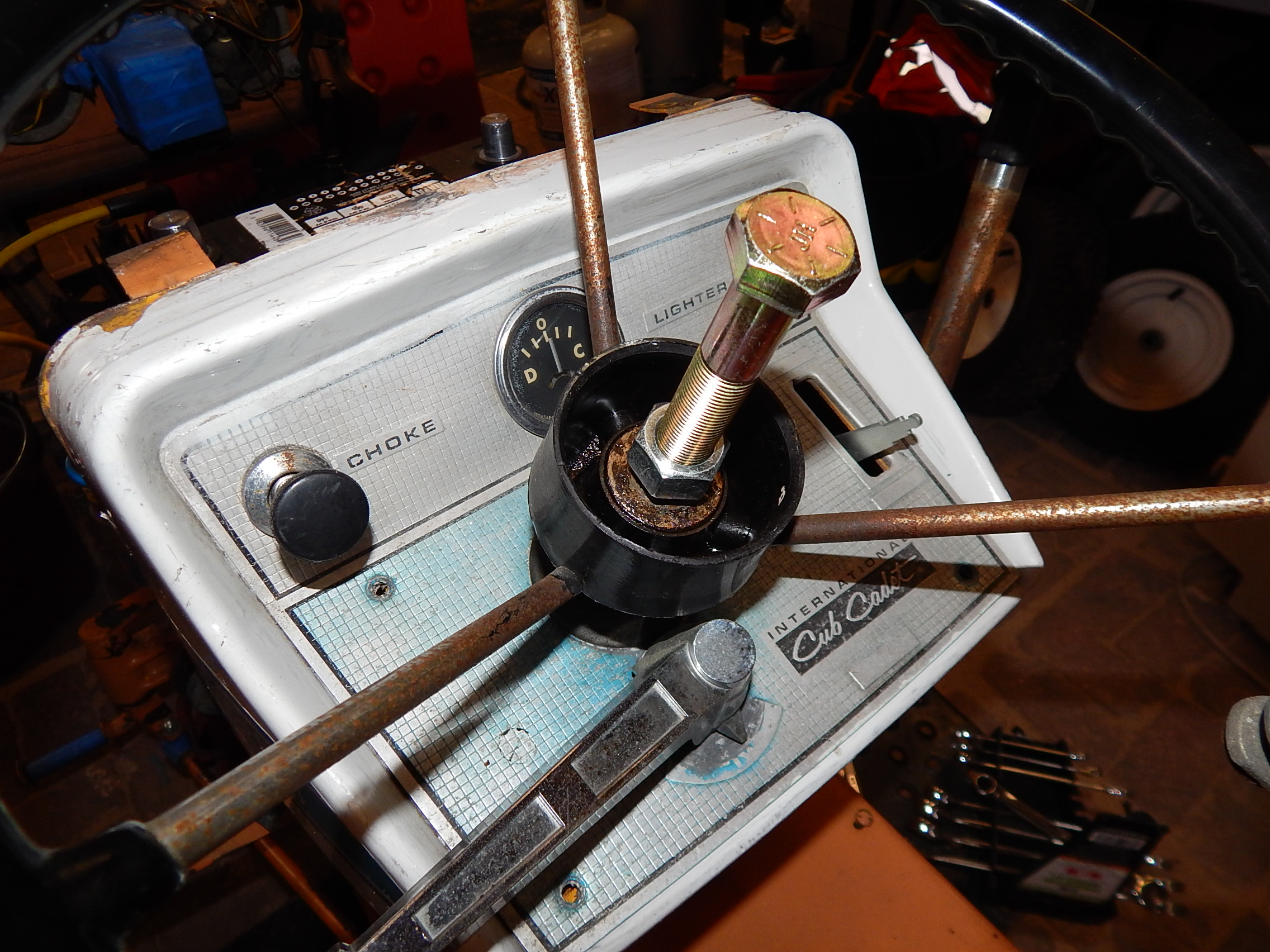

Ok, now I'm stumped. How do I get this steering wheel off? What kind of puller can I use that won't wreck all the surrounding plastic and fiberglass. My understanding is that it's a press fit and for sure rusted on. I really need to get the wheel off to do the new decal on the instrument panel properly but that decal is not worth wrecking the steering column. And I've never used a bearing puller in my life, if that's what I need, and could use some advice. Thanks.

Could you make a vertical cut in the decal from the bottom to the bottom of the steering shaft hole? Maybe then you could flex the decal enough to slip it over the steering shaft. The joint wouldn't be all that noticeable.
Bob B.
/ 1968 CC 125 Renovation
Bob B.
thanks, exactly Bob, that's my backup plan. Having never used a gear puller or steering wheel puller, not sure of which tool to use if I'm going to get the wheel off, but know I'm starting with several days of PB Blaster, etc. and let it soak. Anytime I see that much rust, I want to take it apart and clean it out but not sure that will happen here if I do more damage than good.
/ 1968 CC 125 Renovation #8
Don't use a puller on the steering wheel as you will probably ruin it. The easy way is to use a bolt and nut with the same threads as the shaft. It is a fine pitch and I use to have one but haven't seen it in a long time. The procedure is to remove the narrow nut and replace it with a wider one in which you can put half of the threads on the steering shaft into the wider nut and then screw a bolt with the same threads into the other half of the new nut. After that and with play between the steering wheel hub and the nut, you tap the end of the bolt you inserted with a hammer. It will break the hub loose.I hate to send you elsewhere but you need to go here and check the FAQ Topics - IH Cub Cadet Forum

well the steering wheel is soaking in Pb blaster now and I'm going to keep all this good advice in mind while trying to rig up a puller.

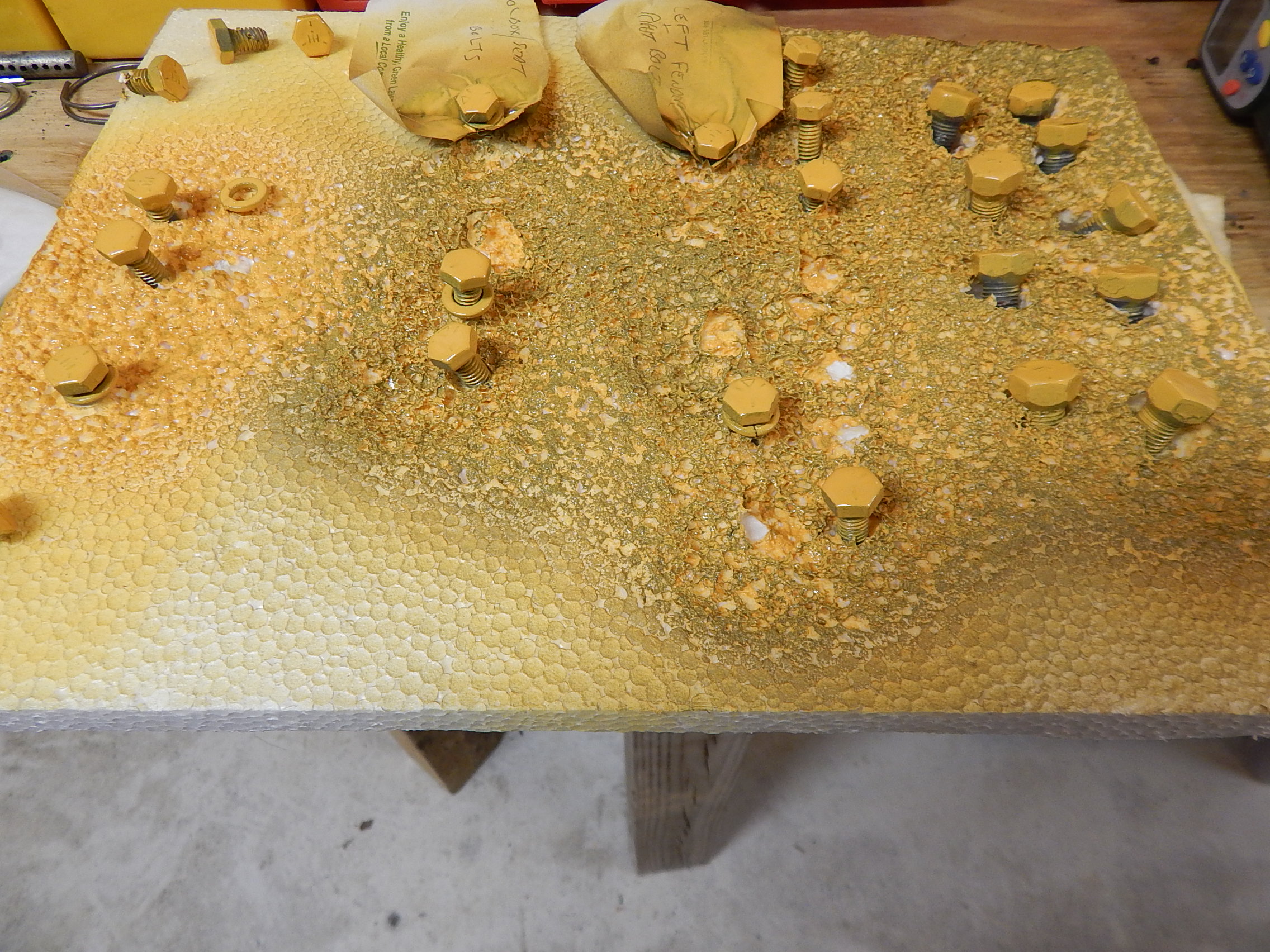

made some progress on priming and painting today. Challenging, had to heat up the parts in the woodshop, take them outside to paint,then bring them back into dry in the heat. Worked pretty well. Funny thing happened when I was painting some of the bolt heads. Usually I poke holes in cardboard and push them in the holes, but I had a sheet of styrofoam from a box and used that instead. Big mistake. The etching primer melted the styrofoam and lots of the screws fell out. I figured it had to be the acid doing it but no, even when using the final yellow paint, it still ate the styrofoam. Something for sure is reactive, going back to cardboard.

I got the bolt and nut for the steering wheel and sure enough it all screws in as suggested. Will have a big helper next Monday and he and I are going to get that wheel off. Meanwhile, a steady diet of PB Blaster. And lastly, took all those little painted bolts and pushed them into a sheet of cardboard for a final coat. But it was just too cold today to paint and not looking too good for a few more days either. Might even get snow tomorrow, pretty rare for here. This CC will sure never see snow.
Ok, now who knows the trick of getting those bolts in and tightened without wrecking the paint? A wrench might only chip two sides vs a socket that could chip every corner. Usually I have to go back and touch up but that's hard with a rattle can when you have color changes nearby, and you don't want to get overspray. Then all I can do is resort to tiny paint brushes. Better I'm sure to get the bolts on tight enough and then worry about making them look nice, not the other way around.
Really should be using my torque wrench anyway and the manual has the bolt specs. Why not, no rush on this. Though honestly on most things if I'm doing it by hand, I can feel "tight" pretty well now after all these years. So can most of you I'm sure. But torque wrenches aren't hard to use so I'm going to make sure the structural bolts are tightened properly. I'm not worried one little bit about the engine tin. Except to always be careful not to overtighten and break the sucker off in the engine block.
Best example I can think of is putting in spark plugs. You know you have to get them in tightly, but you know equally well that overtight is not good at all, and that nice little compression washer has a "just right" spot. Which without a torque wrench takes a lot of experience to get consistently. Which is why the pros use torque wrenches on critical builds. Which this doesn't qualify for. But I will put a wrench on every bolt and make sure all are "tight". whatever that is...

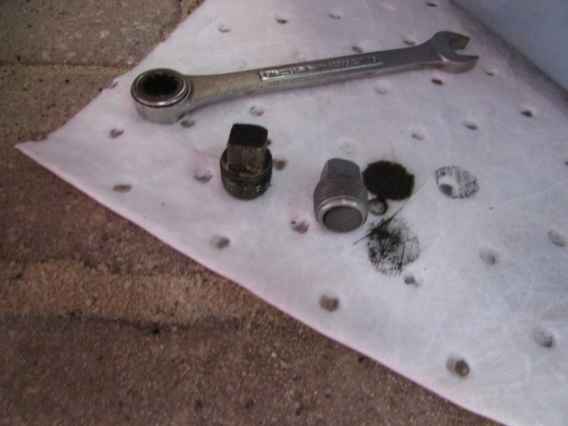

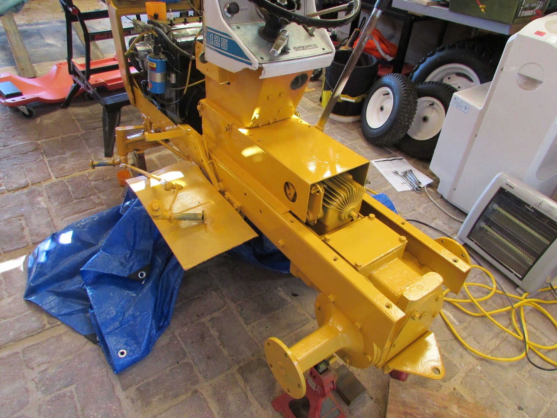

got some additional painting done yesterday, warmed up enough outside so if I heated up the objects in my woodshop, took them outside to paint, then brought them back into the warmth, it worked...Will be Sunday here before I have a sixty degree day but still not sure that will be enough to paint the main body of the CC. I have an IR heat gun and while the air might be warm enough, the tractor isn't. Usually condensation is a tell tale sign. I might put some portable electric heaters on it overnight and then perhaps sunday afternoon see if the metal is warm enough to paint. Usually a min of 65 degrees for this oil paint.
Changed the oil and now wish I had done it three years ago when I got the unit. Dirty oil sat in there that long, not the best...when the engine finally gets running I'll change the oil again when it's warm. Replaced the stock oil plug with a magnetic one.

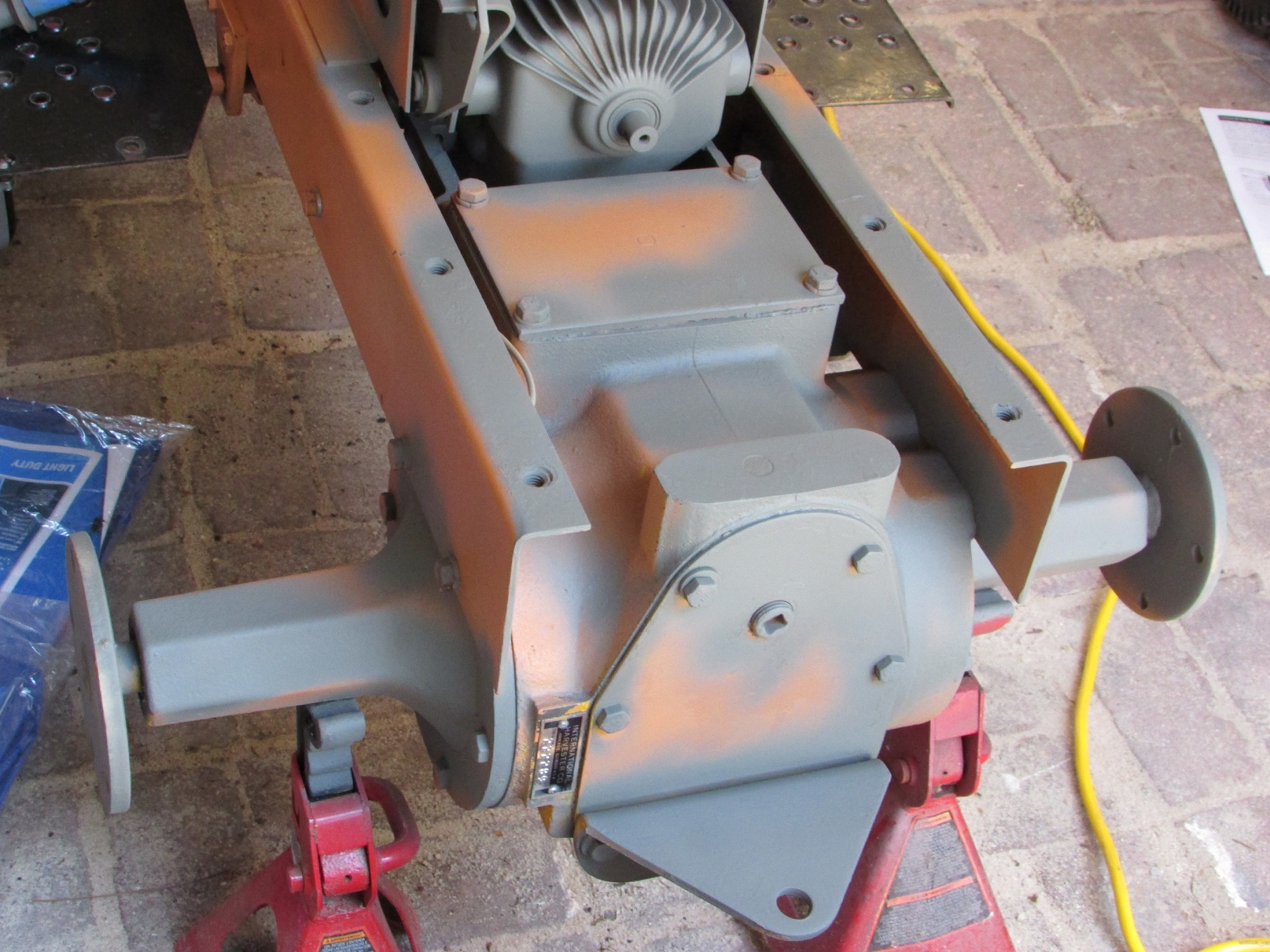

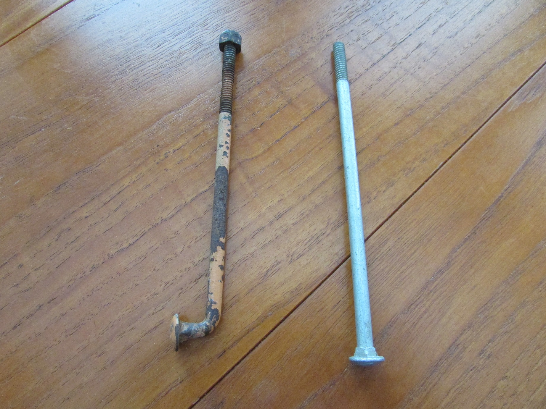

very pleased I got a warm enough day in to get some frame painting done. Still have the front and all the little details to do, but good progress.
Need to make a new battery hold down post; one got lost. I'll put this in a vise and heat it up and hopefully I can bend it.
Once I heat it up, any suggestions on how to bend this thing without ruining it? I'm thinking of a jig of some sort with vertical posts, like a bending jig.
The bend is right up near the head too.

/ 1968 CC 125 Renovation #19
You should be able to just heat the one area with a torch and use pliers or vice grips to bend the head 90 degrees. Another way is to slide a box wrench, just big enough to slip over the threads, onto the bolt and use it to bend the head. Obviously keep the wrench away from the area you're heating until you're ready to bend it. The torch would take he temper out of the wrench.
Bob B.
#20
Bob thanks, my challenge is that flared head; I can't get a grip on without deforming it. So I have to grip just below it and not much
room to maneuver. Maybe if I put it in the vise, heated it up, put that wrench on the bolt part under the crown, and beat on it carefully...,
perhaps it will bend nicely. I was also thinking of drilling two holes in steel, mounting bolts close together and building a simple bending jig. Without welding, not sure
I could get the verticals close enough together to work. I bet HF has a tool for this for five bucks...going to look this up.
update: HF has dozens of benders and they all look like they won't bend close to the flared head easily.
