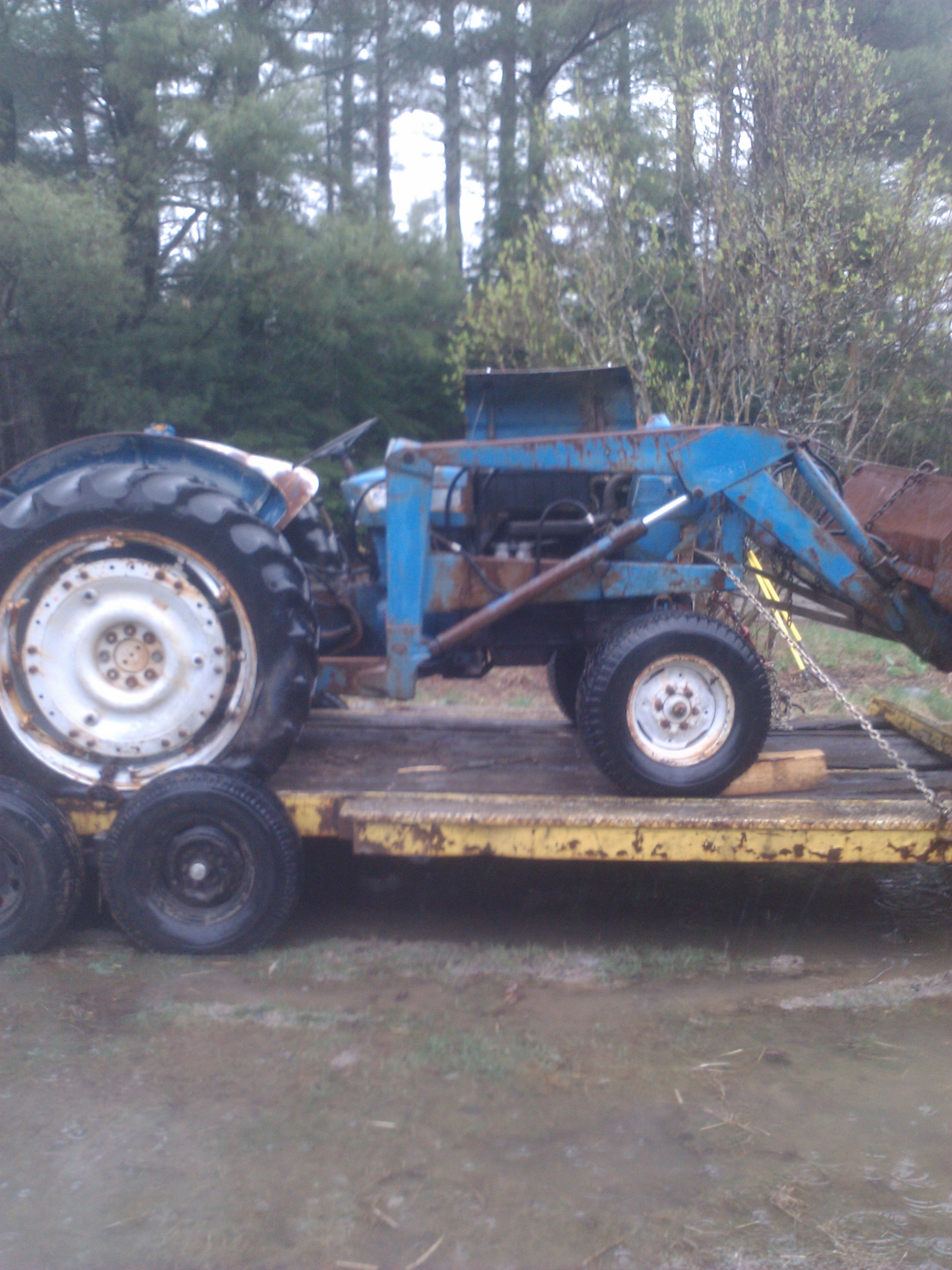

While at an estate sale The very nice widow mentioned that her husbands old tractor which had been sitting for 5 years was going to be picked up for scrap in the following week. I thought about this on the way home, the neighbor had said it had been a good running tractor so when I got there i looked up the vehicle weight, called her up and offered her $500 for the old Ford 4000 provided the motor was not stuck.
I brought it home yesterday.
I am attaching a picture as it sits on the trailer.
It needs new rims and tires as the calcium was put in as ballast without tubes.

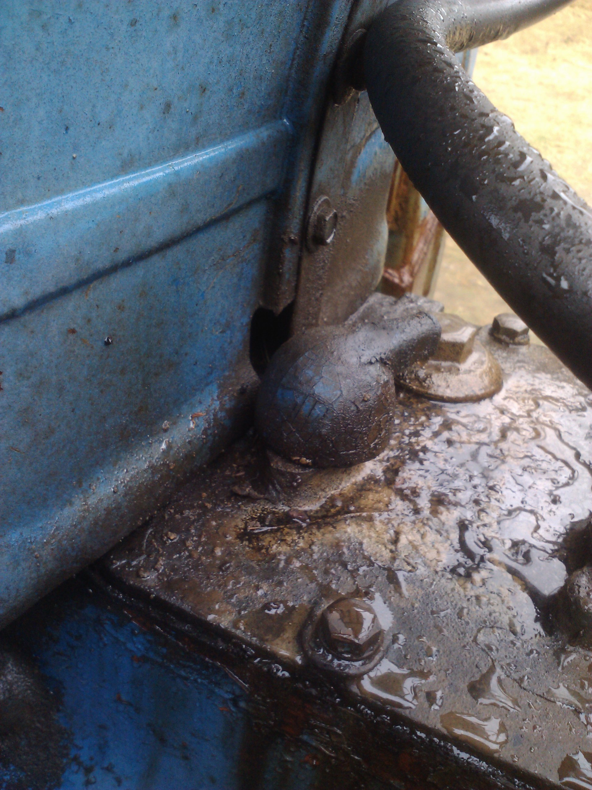

I am also attaching a picture of a switch that I do not know what it may be used for.

Welcome, nice find!
The switch may be a battery disconnect?
I'd drain the crankcase and check for water, antifreeze etc.
