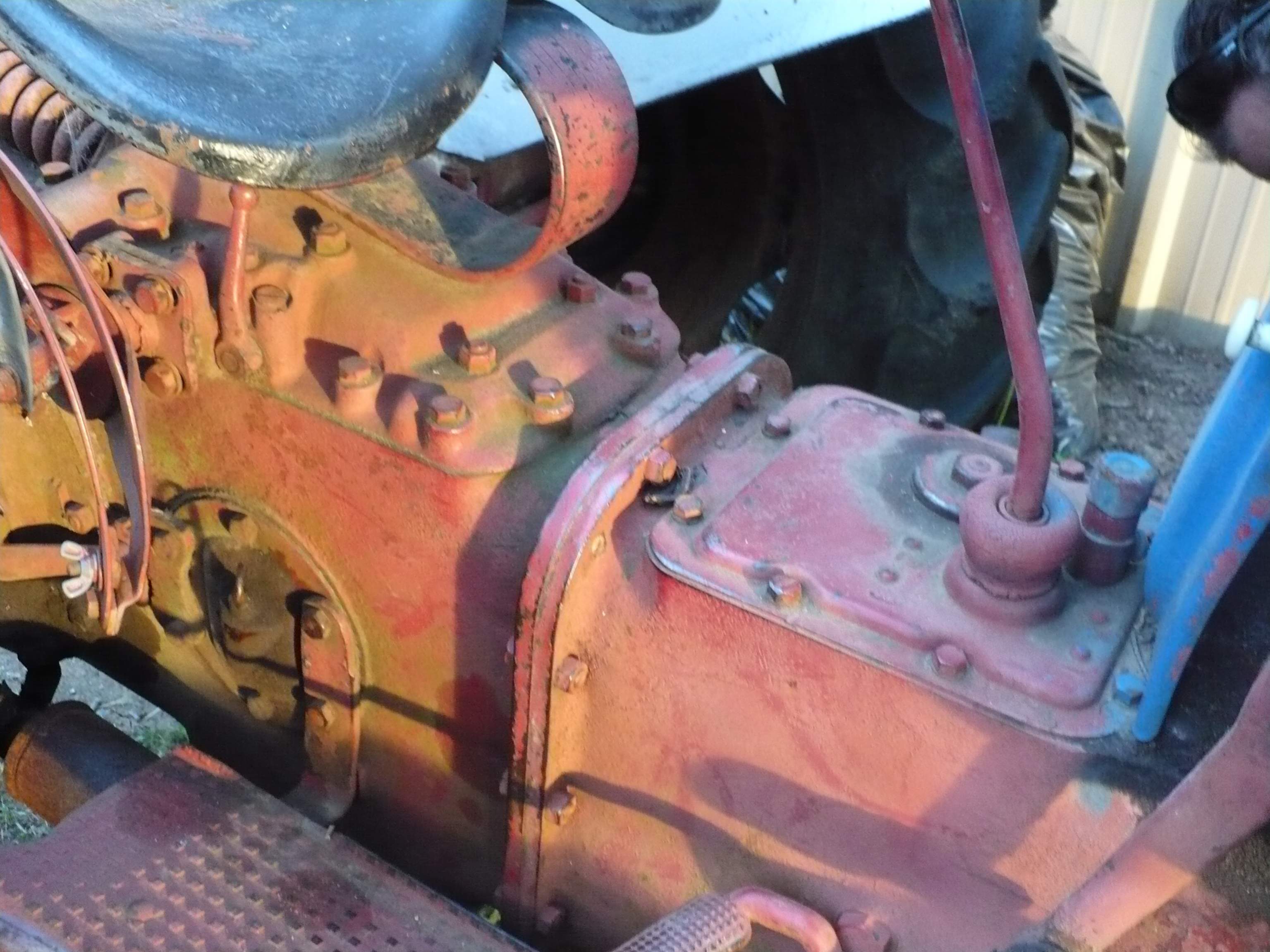

Looking for information on how to change oil and filter on PTO and tansmission a 1964 ford 8n tractor and also where is the filter located? My brother bought this tractor and this need sot be done.

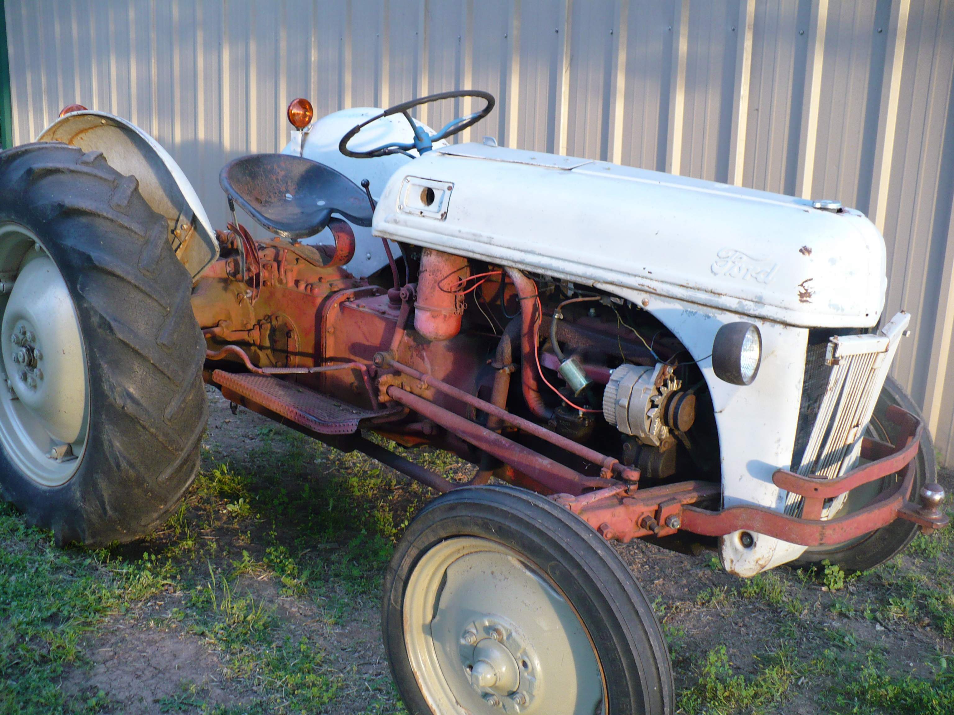

/ 1964 Ford tractor
Here is the photo of the tractor. Thanks for all your help.

What you have is a 1947-1950 8n. Serial number on the block would Give exact year.
Oil filter, fill location, and dipstick can all be seen in the 5th pic you posted just forward. The breather on the front is fill. The one behind that is the cartridge filter under that housing.
Rear axle and transmission fluid are one and the same. Use 90wt gear lube but make sure its yellow metal safe. Fill location is right by the gearshift.
I would also probably use non-detergent motor oil if it hasn't been rebuilt in the last 10 years or so. This can be debated, but modern detergent oil can break loose way too many years of built up gunk and wreak havoc.

Good info for the OP guys. HEY, she's been upgraded to 12 Volt!!!

fo4 service manual.
i personally would go with detergent oil. many better choices.
besides. an N is a bypass filtration system anyway.
i see it has a fire-bomb external filter scabbed in hanging over the manifold.
i'd loose that quick!

No gear oil in the transhydraulic system. Either SAE 90 GL-1 lube or UTF.
/ 1964 Ford tractor #10
The GL part stands for Gear Lube......
But yes, no modern "automotive" gear lube. MUST be yellow metal safe.

yep.. the ep adds in the lubes are generally sulfur compounds. add a lil water in and you get some acidic compounds.
thus only lubes listed as mild ep are normally ok. that gives you the mineral gear oil 90w gl1 and even up to gl3. past that in the gl4/5 territory.. best to find one that says yellow metal safe and carrying an MT1 spec . many people carry one.. sometimes even walmart does.
on the ND oil.
i don't doubt that years of varnish might start coming off.
here's what i have done on any real dirty engine i have found.. whether i think it was ND oil.. or just years of neglect.
go buy a bulk container of CHEAP oil... cheap as you can get.. can be an old s rating.
do an oil change with 4qts of that and 1.5 qts of type f or dex/merc3 atf. and put in a cheapy 3$ fram c3 oil filter.
run an hour.. then change.
the detergents in the oil won't make 50ys worth of sludge immediatly move.. it will start disolving and suspending it though.
i've done as many as 5 oil changes in succession over a couple days and good warm / hot running on a dirty engine.
ie.. go mowing for a couple hours and come back.
I had a jd b that was so dirty.. the first 3 changes came back with oil that looked like it came out of a diesel.
4th was tinged but better.. and 5th was 'normal.
I called it good there.
ont he N.. the c3 is a 3$ filter.. and I'd change it with each change.
then go to a better napa 1010 or the bettter fram c3P.
if the engine IS real dirty. a multi step oil change program is the best of both worlds.
no worry about it dumping lots of gunk on a premium oil change while waiting till next year for the next change.
