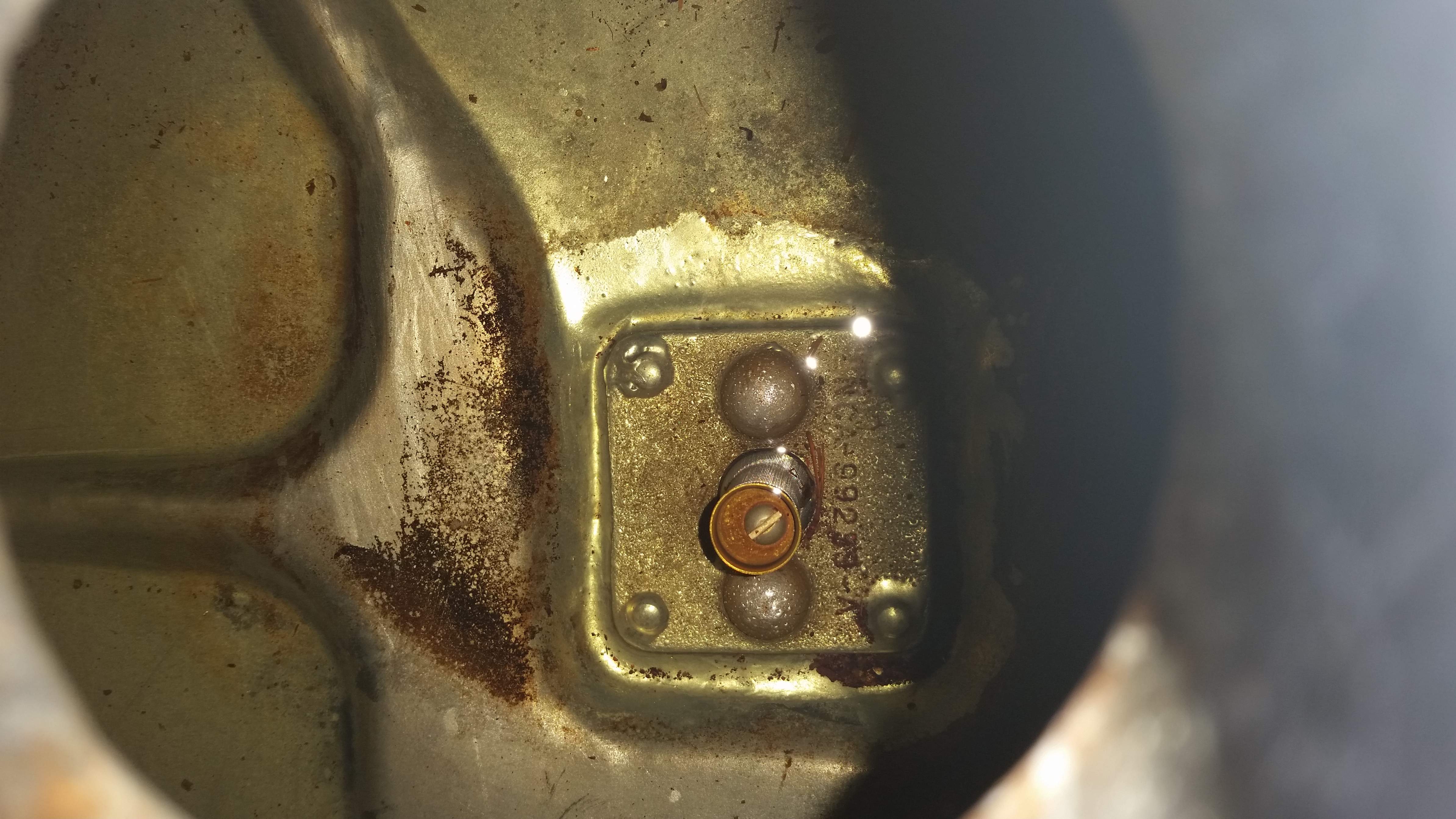

Thanks, I really appreciate that!! This is my first time working on such an old motor and tractor, so I have a million questions! Right now I'm stuck getting her to start up. It has good compression, all the plugs seem clean, and she'll turn over giving me a good woof whoof woof woof, but just won't fire. I'm thinking I might not be getting gas. There's a little glass bowl in front of the carb where the fuel line goes in. I expected to see it fill up, but it's not. The pickup inside the tank looks weird to me too, not sure if it's right or not.

pickup tube is completely correct with screw retained brass cap over the finger shaped screen.
mighty clean tank too.
under that is on the exterior of the tank wher ethe fuel line comes out is a screw in / out fuel valve.
it must be screwed out to get fuel to flow to the bulb on the carb.
the bulb is held to the carb with a banjo bolt. it is a bolt with hollow stem and a hole thru the shank. it IS possible to put the bowl on wrong and block the hole in the stem.
there is a drain on the carb you can pull the plug out to see if you can get fuel flow thru. if no flow, unscrew the stem from the fuel sediment bowl and se if you get flow from the tank.
a can of start fluid is a great help on a gasser.
tirn over and give a whiff int he carb mouth.. if ti fires then dies, you have spark and no fuel flow.
You can also simply check the coil wire held near the head or block and turn over to see if you get spark.
