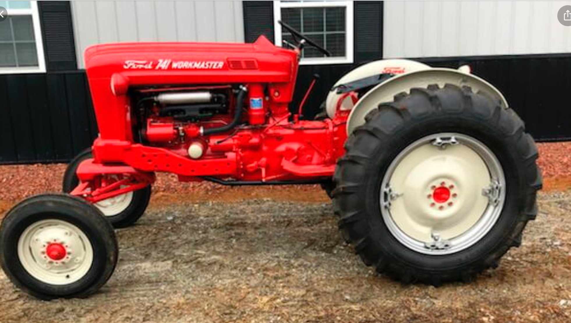

A 2000 prior all purpose would look like a 641. A 2000 prior row crop would look like a 741.
   / 1962-1965 Ford 2000 Row-Crop Wide-Front vs Utility ??? #6
Not aware have ever seen a 741. The most popular model here was the 601 and then maybe the 641. Only difference I think was the gear ratio. In my area flu cured tobacco was the money crop. All equipment was bought with it the driving force. It was raised on 52 or so wide single rows and the bigger row crop tractors just were not common here till maybe the late 70s. We did see some using really wide tractors being wide enough for two tobacco rows. Think those were all JD, well in my memory they were.
   / 1962-1965 Ford 2000 Row-Crop Wide-Front vs Utility ??? #7
The 741 had the same engine and hp as the 641 but in rowcrop style. To the OP, the 2000 prior rowcrop would look much the same as this but in blue.
