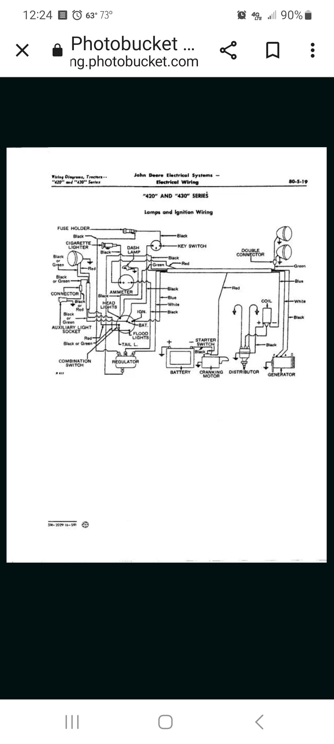

I have a 1958 John Deere 420w I am needing a wiring harness any suggestions where I can purchase one. I would also like a copy of wiring schematics or manual if anyone has one they could share with me. Thanks!

Steiner Tractor sells complete wiring harnesses for most old JDs. I see they have a couple of choices for the JD 420s.... Which harness to use seems to depend on whether it has been changed to a modern alternator or still has the old type generator/voltage regulator.
I've never put in a complete harness, but it seems like the nice way to go.
