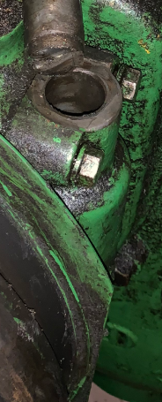

Hello! I need to replace the shift fork on my 1952ar John Deere. I removed the clutch assembly bet the clutch cylinder won稚 come off. What痴 the secret?
/ 1952ar John Deere shift fork replacement #2
Would it be possible for you to add some pics of what you are running into, and the "clutch cylinder" that won't come off? tks

Thank you for replying. I’m posting 2 pictures, the cylinder and the broken shift fork I’m trying to replace. 6C67CF6D-3F60-41C8-A66D-3182C11CF318.jpeg6B115CA6-8B56-4628-AAC1-99057BF7C38C.jpeg
My apologies. Yes it is the clutch fork. Still can’t figure out how to take the clutch cylinder/drum off to change the broken fork.
It’s the clutch SHAFT fork replacement

Remove the 4 bolts holding the clutch shaft housing & pull assembly forward exposing clutch engagement fork.

The fork comes out when you remove the 4 bolts in the housing right where the fork broke. Remove those 4 bolts and pull the housing forward and the fork normally pulls out with it.

Thanks for your reply. I have the fork shaft replaced.
