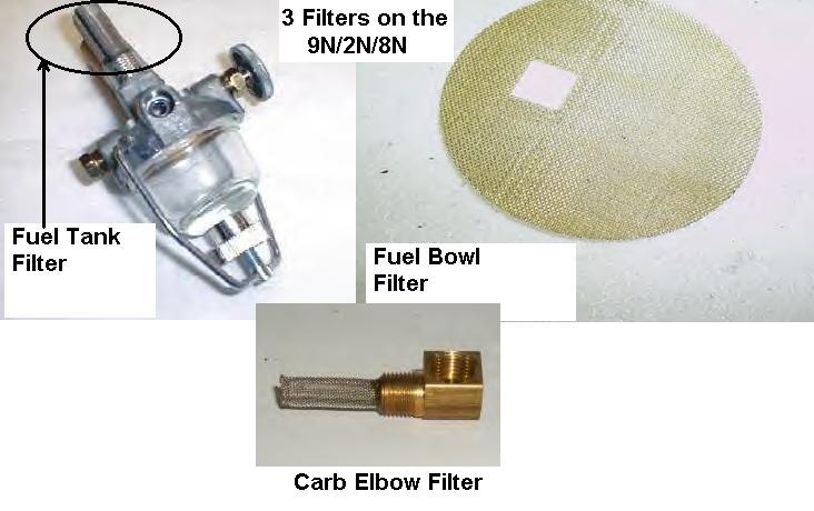

You said you "got gas" - how do you know it is enough and continuous? The way I test this is to take a pint jar, remove the drain bolt from the carb fuel bowl and you should fill the pint jar in about 2 minutes or less. If you can't fill it in that time, then you have a blockage. I'm assuming you made sure that the two filter screens in the fuel bowl are clear? How about the one at the end of the fuel line at the carb inlet?

New screen on the carb, cleaned the screen in the gas valve. New gas line to the carb. Clean gas. I did not remove a plug from bottom of carb. I replaced the carb and head gasket when I purchased the tractor.

I would recommend doing the fuel drain test to fully eliminate fuel as your problem. Fuel flow can be impacted by the gas tank vent hole getting plugged (loosen your gas cap to eliminate this as a cause). If your float is sticking, that will also affect fuel flow. Did you replace the carb with a Marvel-Schebler or one from China?

I checked the gas flow and it was quite brisk. I pulled the dizz and found the dust cover I was sent is incorrect as was the broken rotor I suspect. I'll take the distrib to the local parts house and fit a rotor, use the new cap if it fits and try over. Plus drill the hole!
