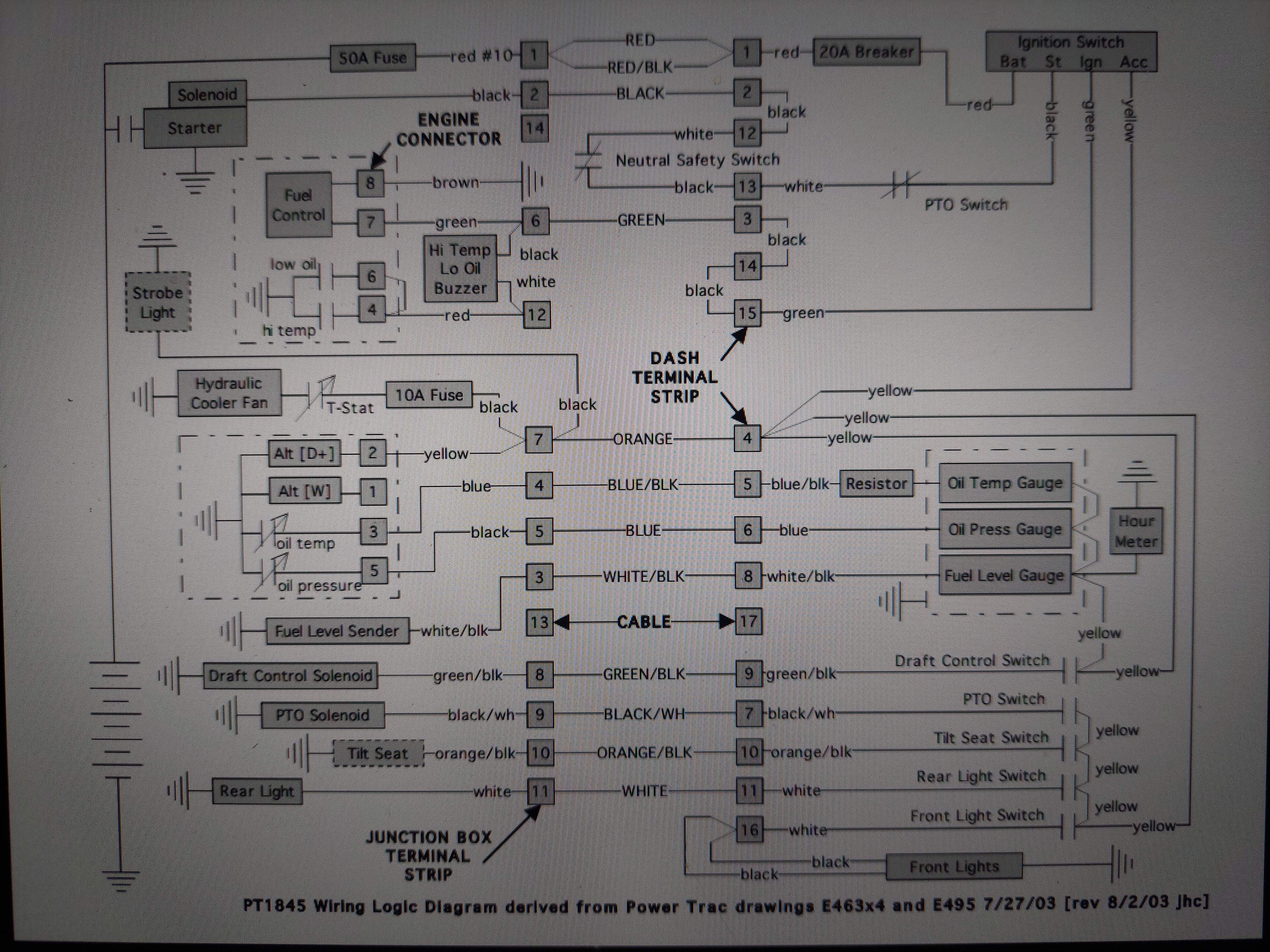

Found online from a combination of previous diagrams so not sure how accurate this is but its a start: Going to use this as a base to create a diagram for my PT1460.
By Coxontools:
/ 1845 Wiring diagram- #2
I think they may change with the serial number groups.
