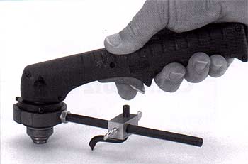

Lincoln makes the drag shield for my plasma cutter. I do have a simple circle cutter, and it works quite well. For small circle cuts, I bend some strong wire into the shape that I want. They can be made el cheapo. The way it works is this, drill a hole in the center of the circle you wish to cut. Bend one end of the wire 90 degrees 1/2 in long. The longer wire will loop around the end of the torch tip. The radius is determined by the diameter of the circle you are cutting. You then light off the torch, and push or pull the torch tip around the circle. You could make several of these for say, 1/2 in, 5/8 in. 3/4 in, etc. Picture below is a commercial circle cutter, for plasma or gas cutting.
For more info, search the internet for plasmawiz.
