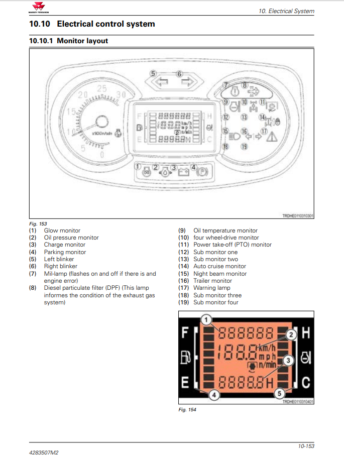

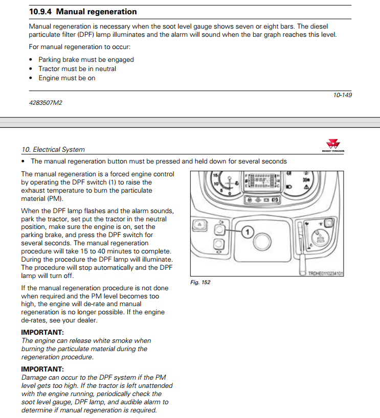

Biodegraded,
Since you had success initiating a manual region on your 1700 tractor, do you think you can initiate a regen whenever you want, even if there isn’t maximum bars showing?
Or do you think you need to have the “regen needed” light on?
I still can’t force a regen. I tried this morning with my tractor at operating temp. No luck.
Perhaps it needs to be at idle, cold, neutral and parking brake light lite?
