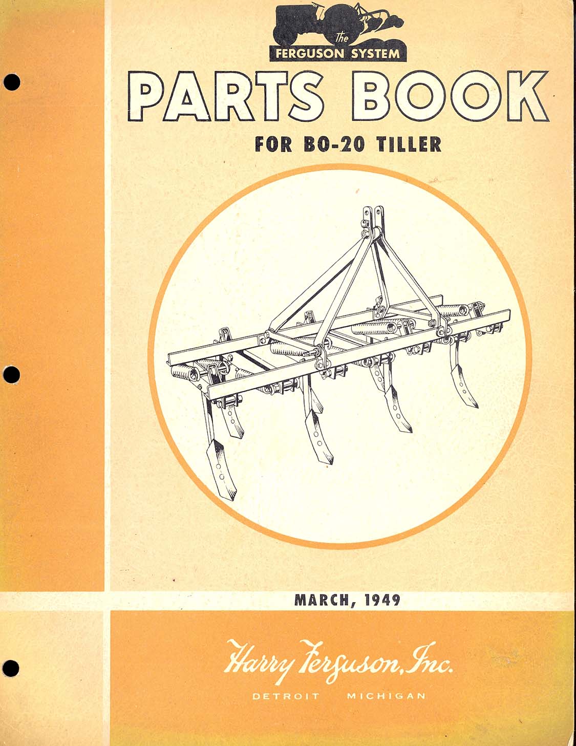

Field Cultivators have been produced by many manufacturers and have been marketed with numerous names.
The first Field Cultivator was produced by Harry Ferguson, the inventor of the tractor Three Point Hitch, about 1936. Ferguson called it a "tiller:. The Ferguson "tiller" was one of the first four implements produced for the tractor Three Point Hitch.
