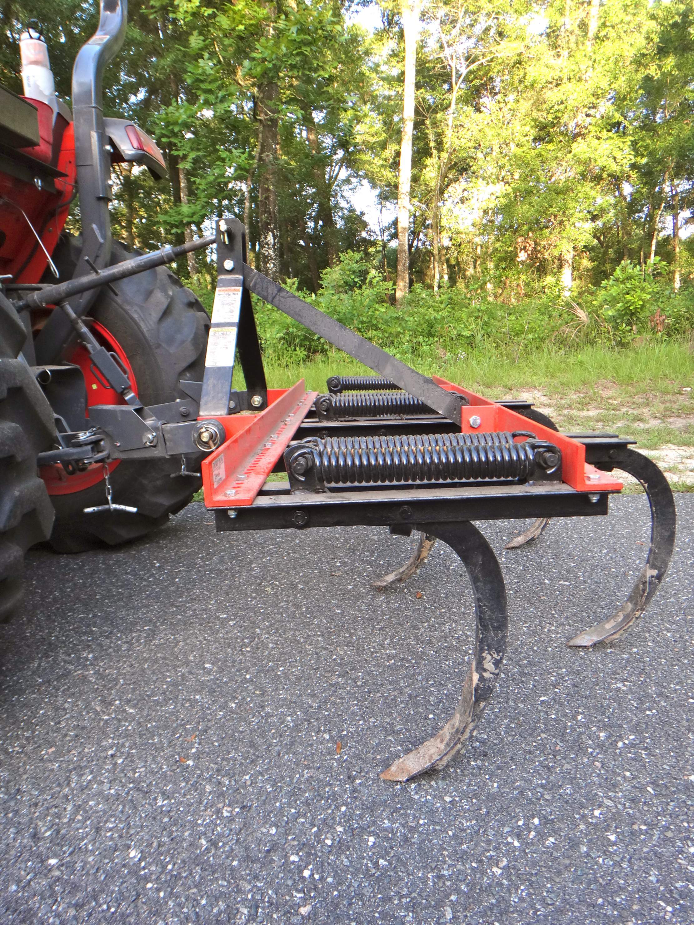

Another implement suggestion would be a $800 four or five tine Field Cultivator. Three draws in MOIST SOIL and some hand raking and you will be ready to plant.
You may need to purchase a five tine, remove one tine the first year when breaking the ground, then return to five tines in subsequent years.

A FIELD CULTIVATOR is medium weight and spring protected. It is a lightly built version of a spring-protected CHISEL PLOW but designed mostly for secondary cultivation in fields down to 12". However, will rip most moist loam soil, under most conditions, when number of tines and tractor traction are balanced. (I have NOT had success ripping hard packed pastures.) Available with 3-tines to 20-tines for tractors from 20-horsepower to 80 horsepower. Often used for soil aeration. A soil conditioner NOT a weed cultivator. (A good choice for game food plots.)
