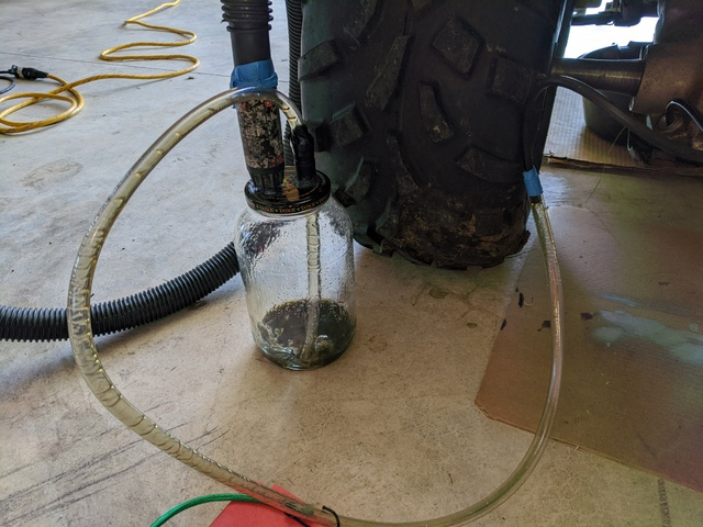

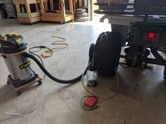

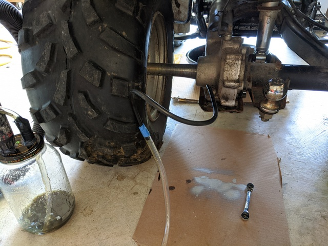

I accidentally found a slick way to clean out the bottom of SOME tanks. Take 1/2" siphon hose and start draining the tank, using it like a vacuum hose in a pool, slowly moving it around the bottom sucking up all the solids. I filtered it at the other end of the hose. Worked like a charm!
I purposely devised perhaps a slicker way. I call it operation "VacuSuck"😁 tool. it does real well to clean diesel fuel tank or empty out oil in in 4 wheeler rear drive as I can not break drain plug from the bottom without striping the threads. Pics are self explanatory. Shop Vac stays clean. This pretty much like medical suction that is done in an operating room or dentist's office.
