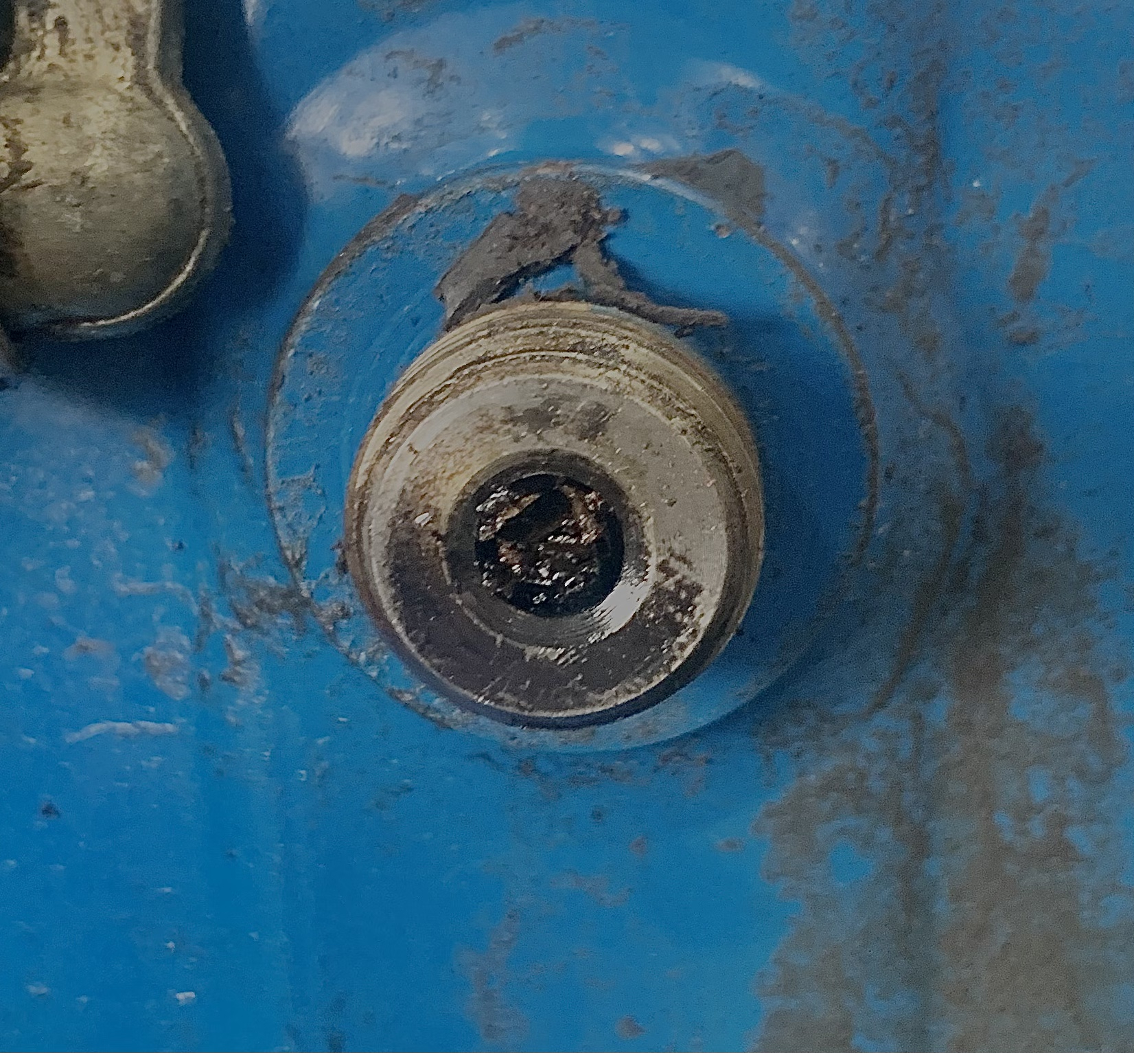

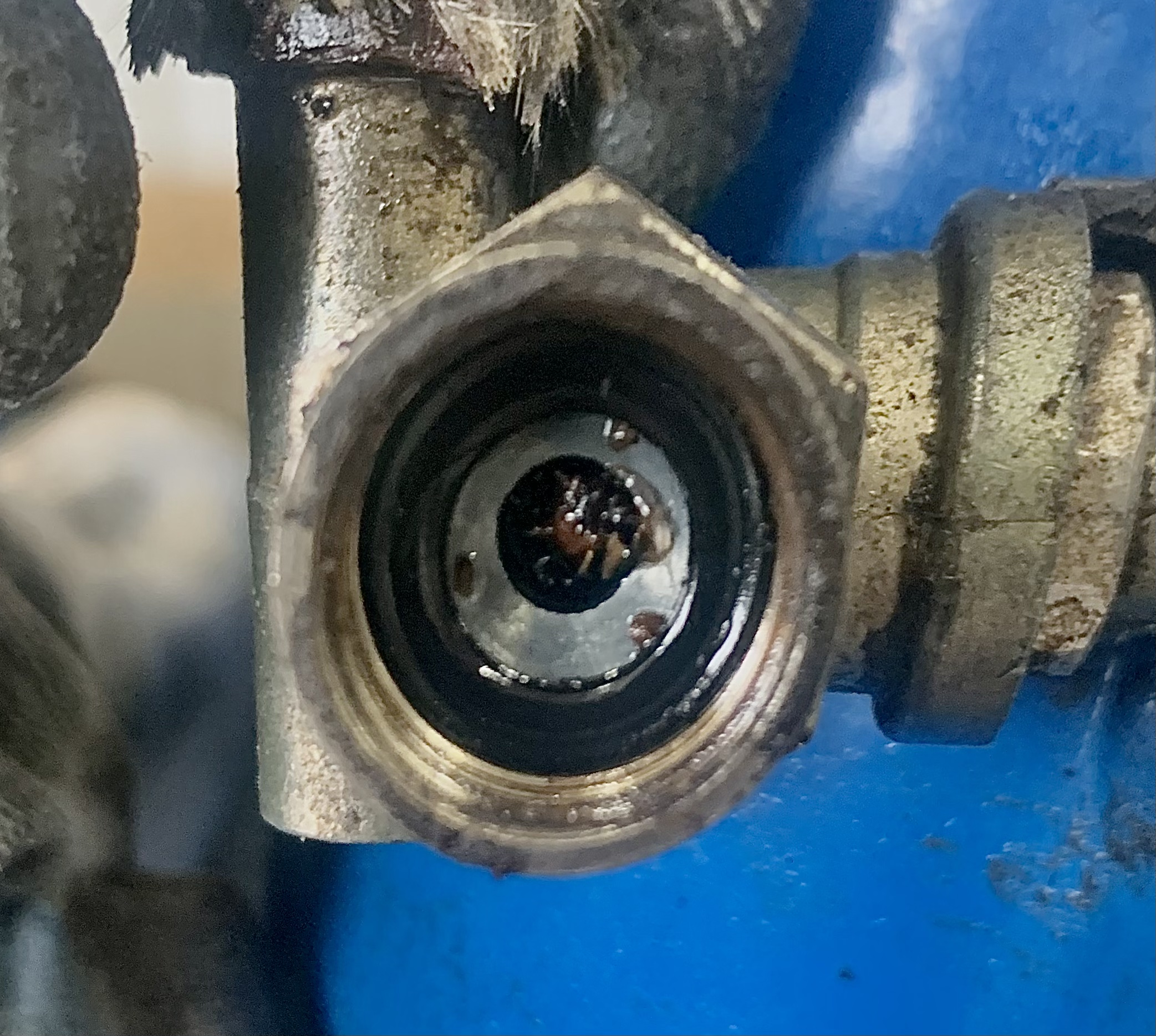

To all those that assisted THANK YOU !!!
I removed the gas tank, shutoff valve and fuel hose to the fuel filter and what did I find ……. THE CULPRIT
Taking the tank off, cleaning it and cleaning the fuel valve hose was way easier than expected. Overall it took me about 2½ hours to remove, clean and reassemble. A quick bleed of the system and prime;was up and running.
The tractor sounds better, more responsive at the throttle and feels more powerful since it’s getting the fuel it needs.
Thanks again!!!
Cheers,
Troy
no wonder it was stalling and starving for fuel View attachment 738173View attachment 738176
