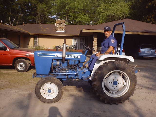

Hi Blue,Ford 1700s just run hot. It's the nature of the beast. The radiator is just too small. I had one for 9 years and it always ran hot when pulling a 5 foot rotary cutter.Just traded it for a Case IH and my over heating problems ceased.
