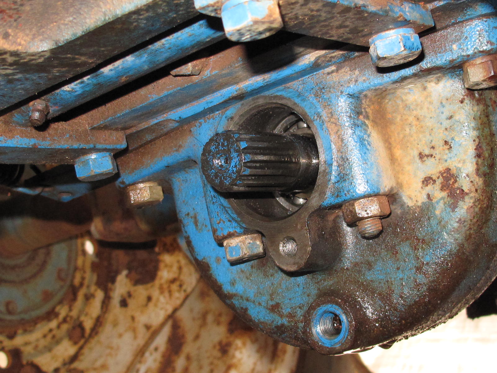

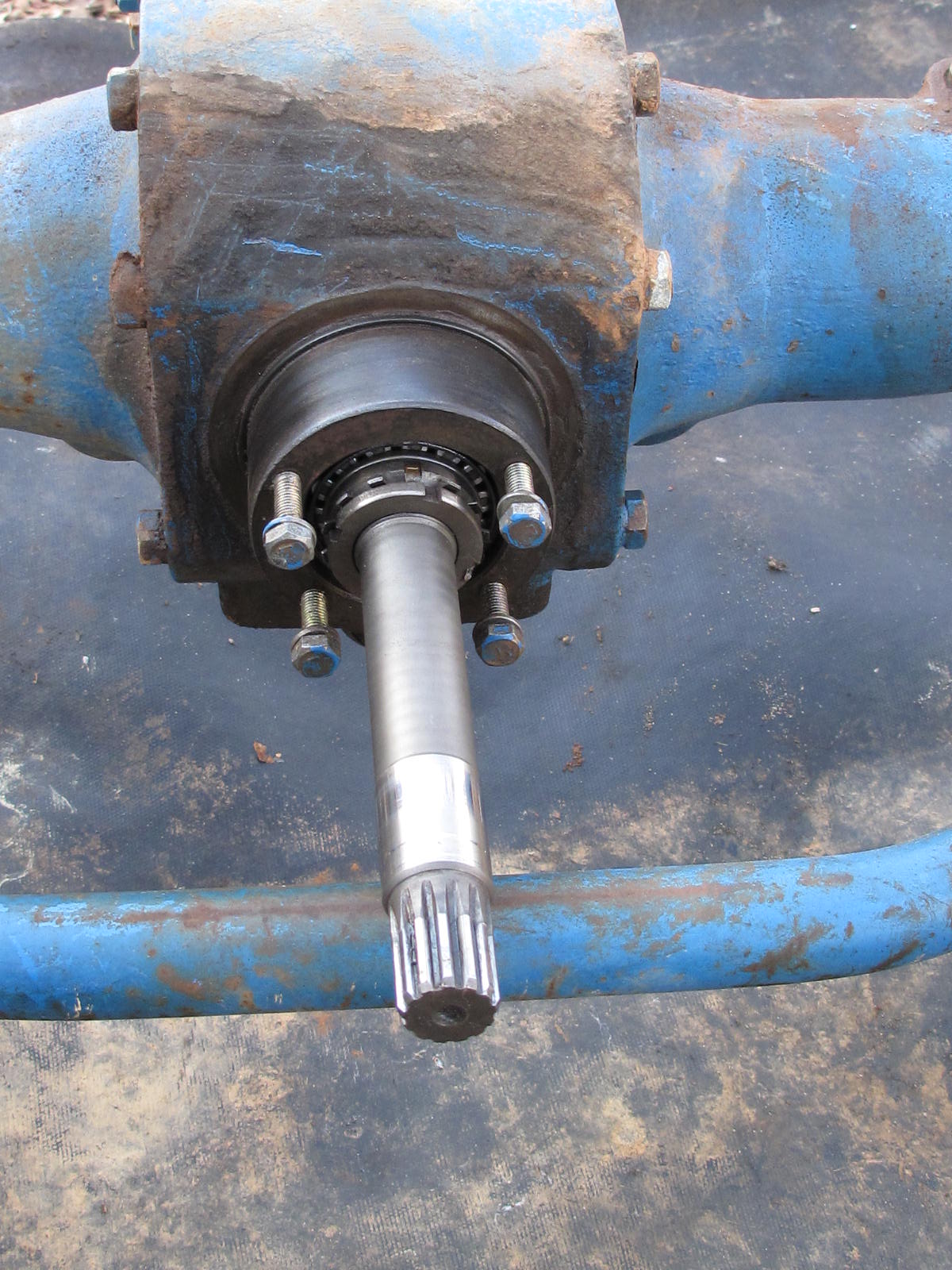

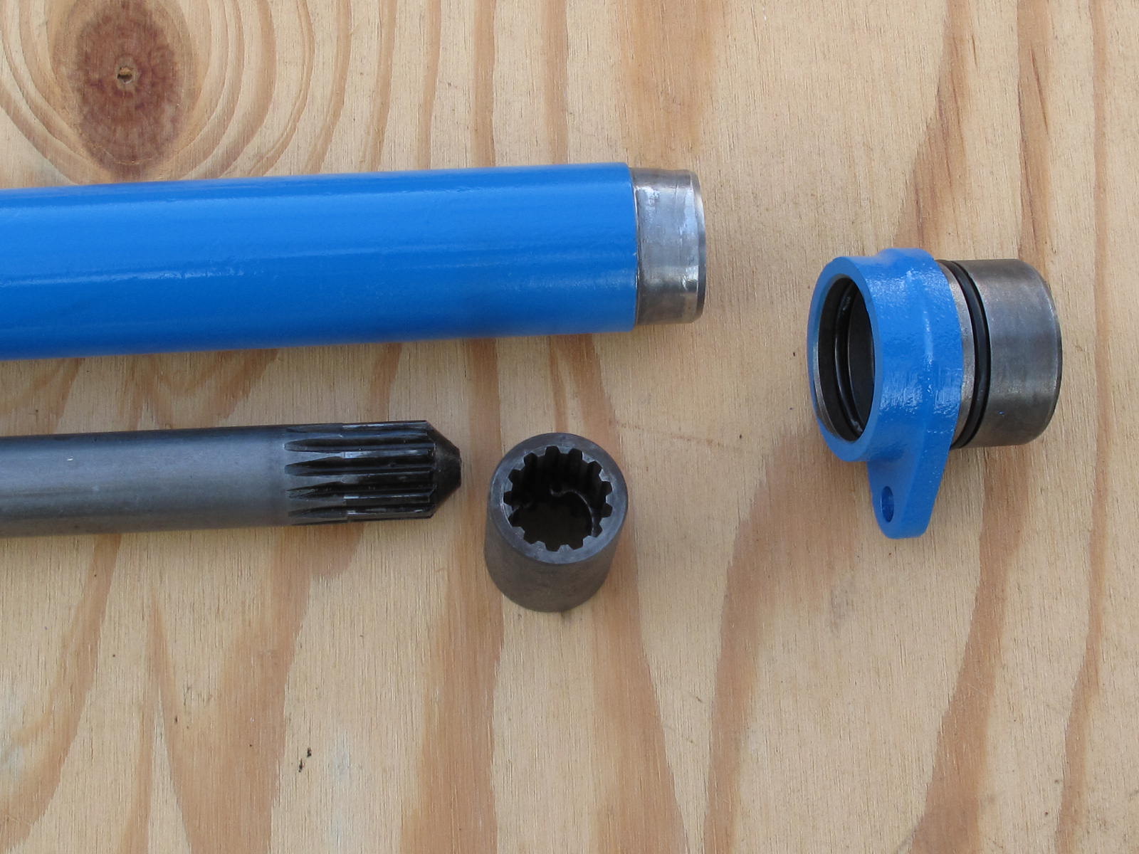

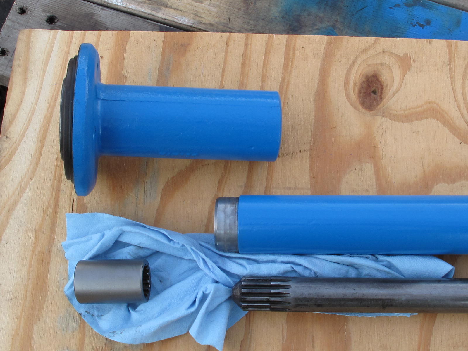

Here are some pictures of the front drive shaft. First is the output from the transmission, second is the rear end of the shaft assembly. The small flanged fitting has an O ring outside and a seal on the inside. There is a straight splined coupling on each end. Third is the FWD end. Large flanged fitting has the same O ring, seal but also has roller bearings. Last is the front axle.
Russell
