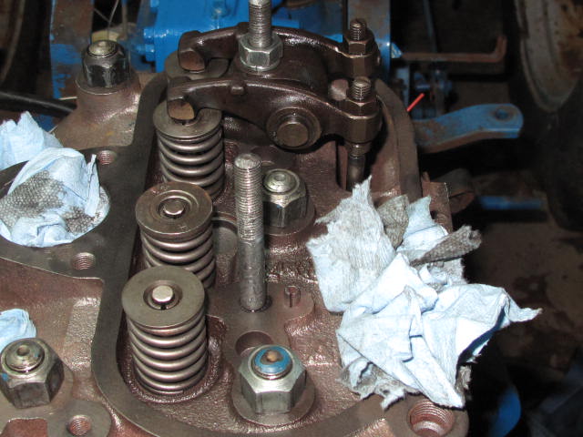

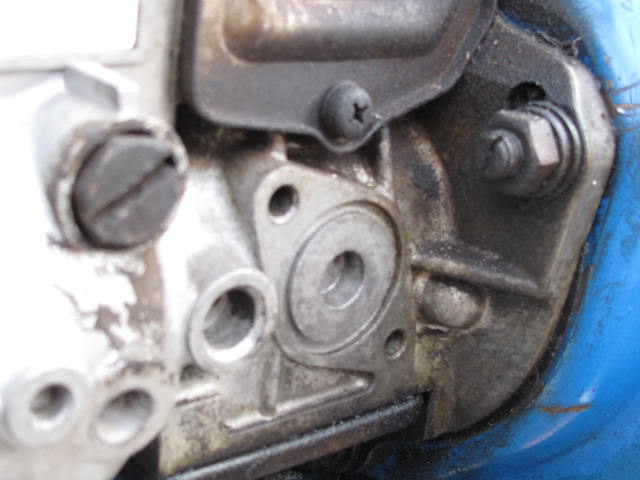

Here is a picture of the injector pump attach bolts, see the screwdriver flat?

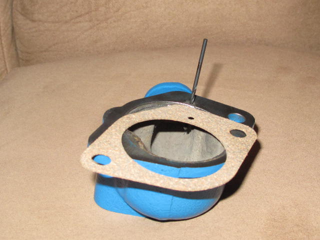

While getting ready to install the thermostat, I noticed an extra hole in the gasket. Sure enough there was a hole in the housing that was blocked with corrosion. I took a drill bit and cleaned it out. In years past we used to punch a small hole in the thermostat for an air vent. This tractor comes with a built in air vent. What this hole does is allow air/coolant past the thermostat so it will fill completly without warming up the engine until the thermostat opens.
unk
Russell
The slotted threaded stud that you have seems to be different than what I have, or in my case the slot might have completely been filled with gunk. Next time I'm there will check it with a pick. Your stud seems to protrude more as it seems longer. My impression was that the injector mount is somewhat like an alternator as you loosen the pivot bolt to adjust and tightening bolt to keep all in place.

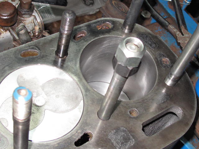

Russell, awesome pics.

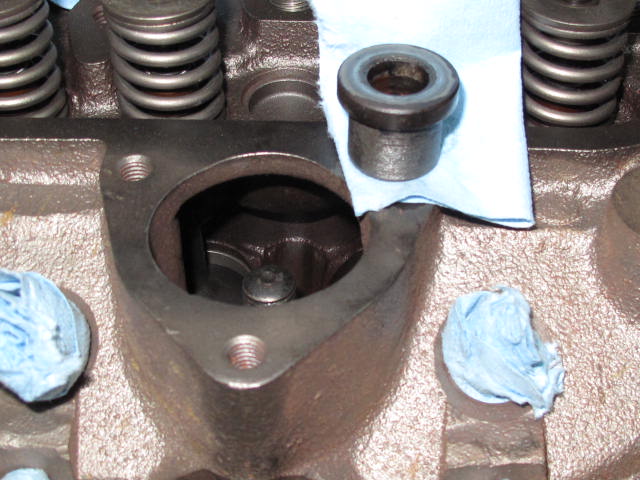

Looking closely at the repaired head pic, I have some questions.
Looks like a 'plugged' crack repair, whats the story behind that ?, what caused the crack ?
Why didn't they plug areas marked arrow #1 ?
Arrow #2, that looks nasty. Is that a repair plug ?
/ 1700 Engine Rebuild
#24
Willl
The tractor was run hot to cause the cracks. That is the way I bought it. Yes they are plugs or as the machinist called them "Pins". The crack does not go into a water jacket and are just to stop movement/spreading cracks. Yes #2 is a plug as well. Both valves were bored and new seats installed. The machine shop assured me that this is a good fix but, I will watch it close when I fire it up.

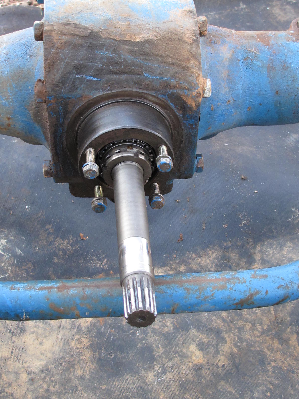

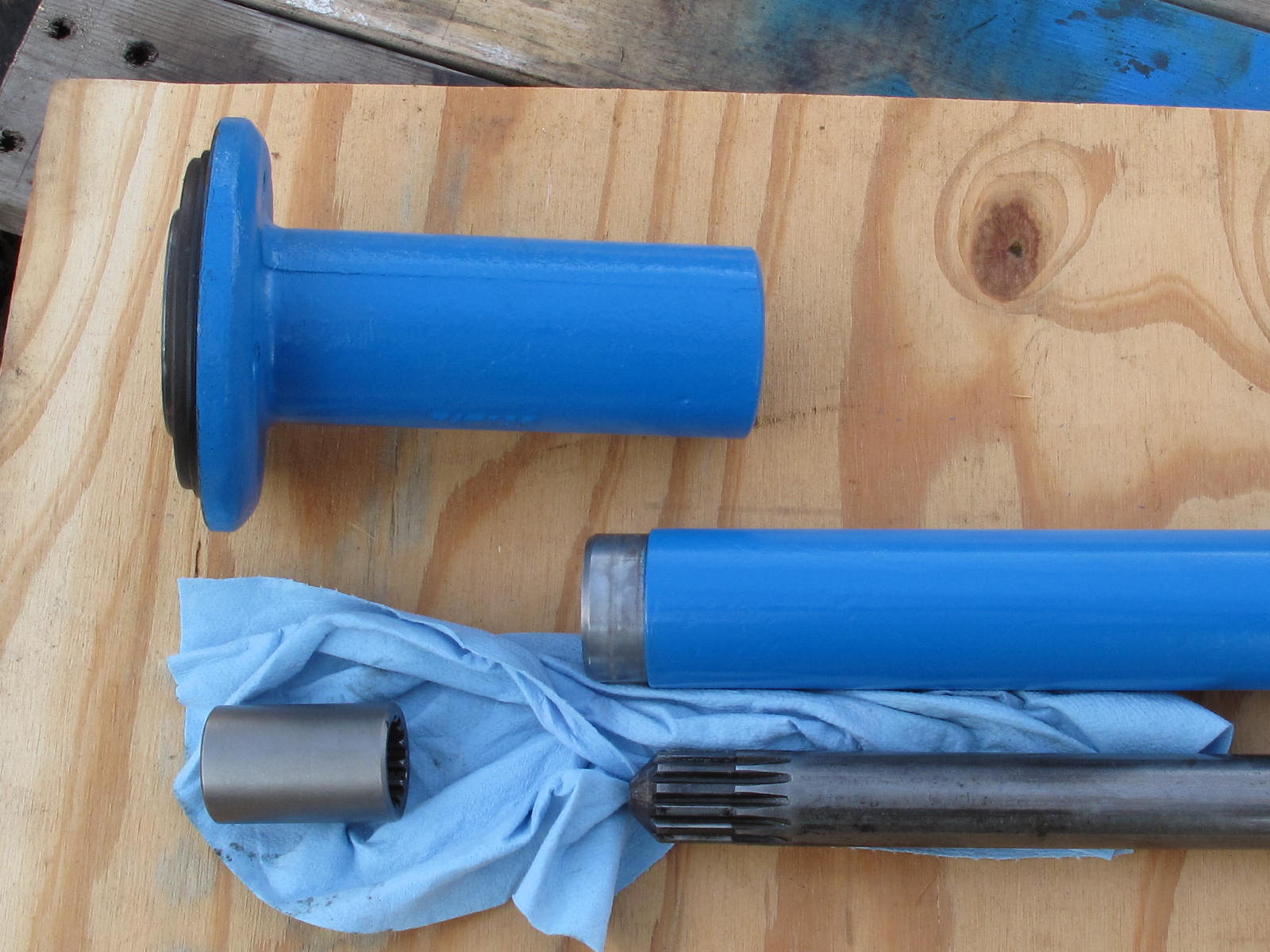

Here are some pictures of the front drive shaft. First is the output from the transmission, second is the rear end of the shaft assembly. The small flanged fitting has an O ring outside and a seal on the inside. There is a straight splined coupling on each end. Third is the FWD end. Large flanged fitting has the same O ring, seal but also has roller bearings. Last is the front axle.
