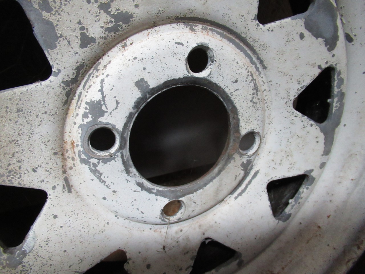

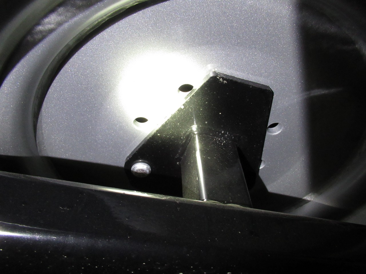

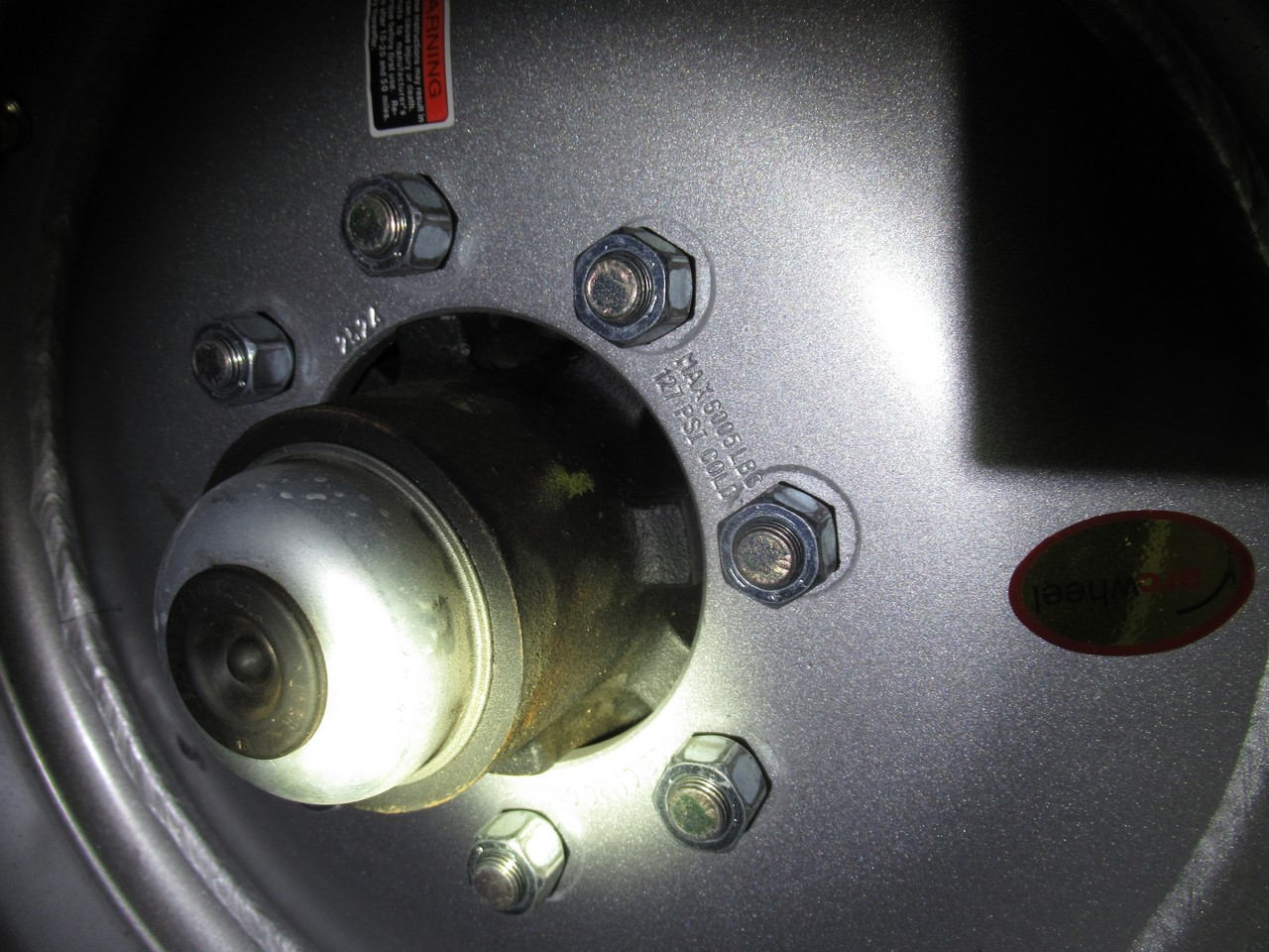

I have a new dump trailer that I had 17.5" wheels put on. The dealer took off the 16" and put on the 17's meaning a different hub, rim, and tires. My understanding is that the 17's come in both hub centric and lug centric versions. The saleslady said these are lug centric, but they don't look like it to me because the holes for the wheel studs are not tapered. I also asked about the 1st, 2nd, & final lug nut torque specs and she said they were for the first 10miles, then 25 miles, and 50 miles. But, the 1st torque setting was just 25 ft lbs. :shocked: That can't be - can it? especially when the final torque is around 140 ft lbs. I think the 1st, 2nd, 3rd means you go around tightening all the nuts to the 1st number, then do it again to the 2nd number, and the 3rd time to the 140 ft lbs.
So, I'm not convinced the saleslady knows whether they're lug or hub centric. So how do I tell, because if they're hub centric, I think I've got the wrong lugnuts on there. Hub centric should have a flat washer style instead of the cone nuts.
Here's a picture of the wheel mounted on the axle, and a picture of the spare showing that there is no cone in the wheel stud holes. and a third picture of another wheel off a different trailer showing the cone.

It looks like a hub centric wheel and hub but is it the matched pair and fit tight?

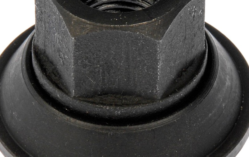

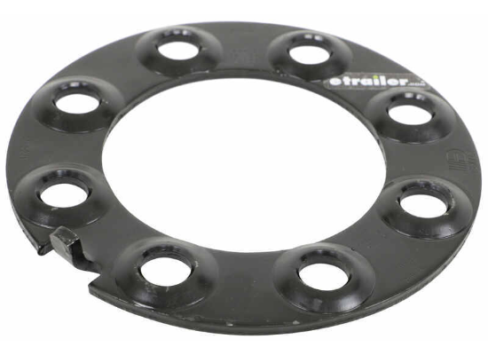

Yes, you are correct, they installed the wrong nuts. You can use a clamp ring and your cone nuts or get flange nuts. Some have the solid flange or a swivel flange. Your studs might be too short for a clamp ring. I assume they are 9/16's? Some clamp rings will work on 9/16's or 5/8's studs, some are 5/8's only. Yes, you are also correct on nut torque and sequence.
Flange nuts are probably the cheapest solution. Here is a picture of the clamp ring and some nuts.

The way I understand the upgrade, hubs with at least 9/16's" studs are required, that the 1/2" studs will not work. My guess is you have the right hub. By looking at your picture, it appears that your cone nuts are 60 degrees, so they wont even work with the clamp ring.

Tension Ring for 5/8" Cone Nuts

Lug Nut, 9/16" Swivel Flanged Flat Wheel

Today I pulled a wheel just to see if I could change it on the side of the road. What I found was that after the lug nuts were loosened and away from the rim, they still needed a wrench to remove them. They should be able to be turned by hand at this point. I found metal shavings that had been pushed into the hub and the threads on both the stud and nut on all 8 were damaged. The nut could not be threaded back on. So now I have a trailer with 3 wheels and the 4th is in the barn until we get this next part resolved.

The hubs do not appear to be set up for a 4.75" pilot in the rim, so that's the reason for the cone lug nuts.
You are correct. If the machined surface on the hub is not the same size as the ID of the wheel it is not hub centric. The only fix is stud centric wheels (tapered stud holes and tapered nuts), nothing else will work. No clamp ring or flat faced nuts at all. The fix is all new studs, nuts and wheels. PJ is not going to want to fix the dealers mess, since they did the conversion, not PJ. They will probably tell you to take it back to the selling dealer. My guess is, if you do take it back (and you need to) they will want to re-install the 16's. Hopefully, fix the studs and nuts and give your money back. They will not want to buy new wheels on their dime.
