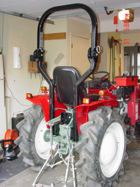

I understand the ROPS, and the clutch switch (My 1602D has one from the factory) but why change the throttle? It's perfectly intuitive to me the way it its............ similar to an airplane, pull out for more throttle, push in for less.........
Here's the ROPS on mine, I built it.......

I like it.

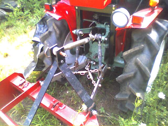

The toolbox was just resting there, it's now mounted on a bracket between the uprights of the ROPS, behind the seat. Really comes in handy as a place to keep the odd hitch pin or crescent wrench. You can see the bottom edge of it in this photot, along with the bracket it's bolted to....

I noticed in the picture that your sway braces cross over to form an "X". That looks more stable than the way the dealer installed mine on the brush cutter. I'll have to see if mine can be done that way.

That's the only way I could envision using them (crossed), there are no outboard places to attach the clips that are in the same plane as the draw pins. This doesn't really look like a 3 point set up to me, more like something someone cobbled together, and I've just been trying to work with what I have..........but it seems to do fine now.
