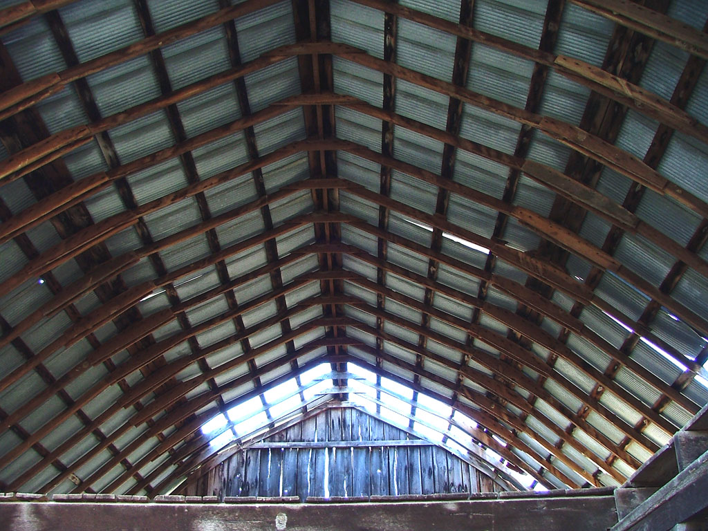

He hasn't logged on in over a year so I don't think he's around anymore, but what I did was study his pictures to try to copy the design. He did mention that his would have to pass code-mine would as well since I live in New Jersey, but from what I heard the inspectors are very willing to work with a homeowner that at least has an idea of what they're doing and how to do it the right way. This is the most helpful picture from the thread:
attachment.php

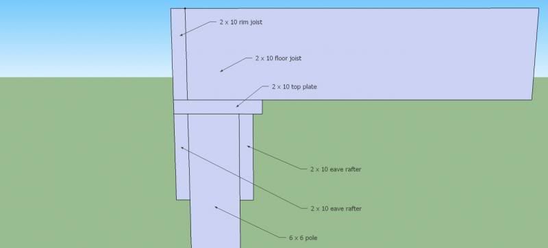

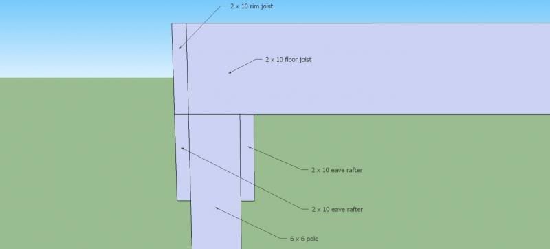

As far as the pole barn portion itself that's all pretty standard, 6 x 6 poles (though I've read that 4 x 4s are adequate for an 8' wall-can anyone comment on that?), 8' spacing, girts 2' OC, etc... Where my design starts to deviate is the second story. It looks as though he used 2 x 6s for his floor joists. I plan on using 2 x 10s. The reason is because as you can see he has a center support girder which I don't want in mine. I looked up the maximum span for a #2 Doug Fir 2 x 10 16" OC and it gives me 14' - 11". The span between my inside eave rafters (I think that's what they're called?) will be 14' - 7", so I should be good there. I'm not sure of the best way to tie in the floor platform up top to the poles though. Obviously I'll nail each joist into all four eave rafters, but I'm thinking that there must be some better way. Here are two different details:
Now the same idea but with a 2 x 10 top plate over the poles as a more substantial nailer for the joists:

4x4's are strong enough, but tend to twist and turn too much to be reliable for anything. I would only use 6x6 posts. I would notch the beams into the posts so that the wood is resting on wood. Hanging wood required brackets and bolts. Never use just one or the other. And in some places, bolts alone are not up to code.
I don't think I would try to save a buck on the floor joists with 2x10's. I think 2x12's are well worth the extra expense.

4x4 is more than adequate for 8' wall, but the example you show looks as if he is adding the new loft/roof to an existing shed. And he has that center beam you don't want. Go with 6x6. I assume you are gonna fill that loft with heavy stuff.
   / 16 x 24 Pole barn planned for the spring #5
IHDiesel73L,
Best advice I can give you is to follow Eddie's advice. He is an experienced builder and well respected here. Just for fun I ran 2X10's on a span calculator and I only hit 16" once. That was with Select Structural Spruce-Pine-Fir with 40 psi live load and 10 psi dead load. If you switch to 2X12's you can go 19'6" with the same grade and loads and you can go 17'10" with #2 grade. It's a no brainier, meaning go with 2X12's and you don't have to think about it.:2cents:

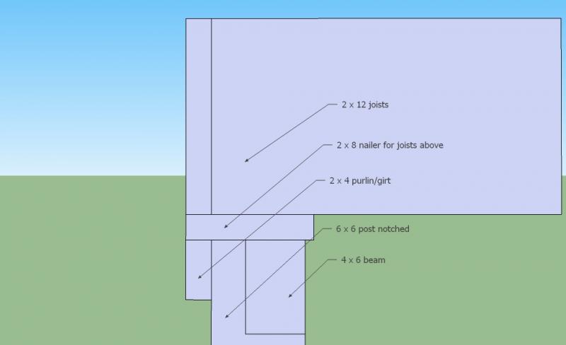

Makes sense-would it be better still to use 4 x 6s like this?
More on this later.
Do not build your roof out of 2x4's!!!! This is going to give you too much movement over time and lead to issues. I like half inch plywood for your gussets. I use liquid nails and deck screws to hold it all together. I don't like nails and try to use screws as much as possible.
I like the liquid nails and screws idea-would 2 x 6s be adequate?
FWIW the interior span was only going to be about 14' - 10" (16' would be the exterior dimension), but ****, with 6 x 6 poles and a 2 x 12 supported loft I can put a heck of a lot of weight up there :thumbsup:
