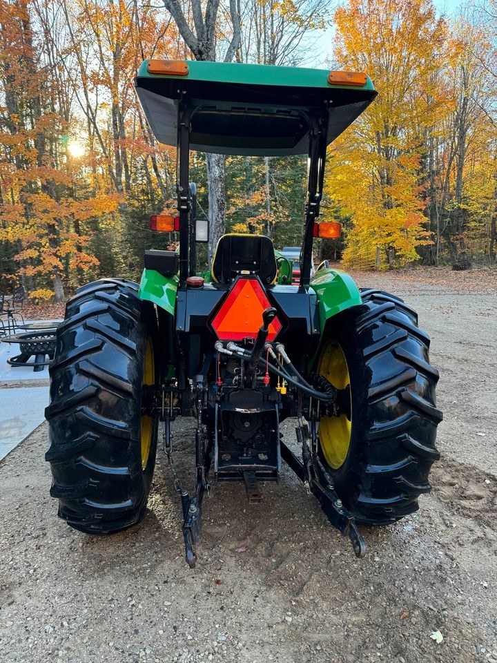

Last week I bought a 1998 John Deere 5410 tractor (MFWD Front) for my homestead here in Northern Michigan. The tractor is in really nice shape, but I'm a bit concerned about the existing tire's traction in sandy soil and the snow we get here during the winter. The tractor has rear 16.9 x 30 R-1 tractor tires on Titan-USA 30xDW14 8 position adjustable rims and front 11.2-24 on Titan-USA 24xW10 adjustable rim. The tires are Firestone's Tractor Field & Road Bias ply and they are original. Although the tires are in decent shape, I'm a bit concerned about their traction in my area. Yesterday, I used the tractor to move some round hay bales and do a little front end loader work, and a few times I noticed the tire's traction was not the best. I have areas that are 100% sand and the tires occasionally did spin in the sandy soil. I'm also a bit concerned about the tires when used during the winter. I'd be using the tractor to plow/clear snow on an 1.5 acre corral for my cows.
I local is selling a set of relatively new (50 hours) Firestone Performer 85 radial 18.4 x 30 R-1W rear tires and 12.2 x 24 fronts and I'm thinking of buying and using on my tractor. It appears I would be able to use the 12.2 x 24 tires on my existing 24 x W10 front rims, but I would need to find and buy rear 15" or 16" rims for the wider 18.2 x 30 rear tires. My research indicates that the existing 14" wide rims is not ideally suited for the wider tires.
Was wondering what the guru's think about migrating to wider radial tires? It's going to cost me a couple thousand dollars, and the time to find wider rear rims, so I would like to have some idea if it would be worth it. I've never used a large tractor with R-1/R-1W tires in the snow so any input or recommendations would be appreciated.

Tires look fine to me. One thing to keep in mind if you do change them is the 'lead-lag' ratio in as much as it's FWA. You must stay in the proper ratio or you'll destroy the front drive axle. If you have an owners manual or if you contact a dealer, they will explain the 'lead-lag' ratio to you.

Yes, I found info about the lead-lag issue you are talking about. My manual says I can use 18.4-30 and 12.2-30 on my tractor, but I want to do the calculations as well. I have the vin numbers and other info for my front axle and transmission as well as the Firestone tire specs. Thanks for the info!

Did the tractor have an implement on the back when you observed the slippage in the sand while loading the bucket?
It doesn't take much weight in the bucket to displace a little sand bareback. I'd save the bigger tires money and get some tire chains for the snow clearing and hang something heavy on the 3pt for the sand.👍

The tractor only had a 3 point hitch empty bale spear on the back. I have a box blade, maybe I'll put that on the back and see how well it does with some weight on the back.

When I did round bale work for our horses I had one on the 3PT for ballast and moved the ones I needed the FEL. Then I dropped the one off the 3PT hitch for the last bale I needed to feed. Made it feel a whole lot more stable.

You should be able to purchase cast weights for the rear rims. What I run on my Kubota's. They each weigh about 700 pounds each.

Like I said in JD forum I have no problems with R1's in snow and would have the rears loaded or buy chains instead of another set of tires

If your unit is FWA, traction on any surface should not be an issue, I don't follow your reasoning. If it's not, then I can understand. For what I do, R1's are the only tires I'd run.

When lifting moving heavy weight with the front end loader (bucket or forks) make sure your front axle is engaged. That's what I have to do with my Kubota or the rear tires just spin. If whatever you lift is so heavy the rear tires are coming off the ground then put something heavy on the 3 point hitch.
