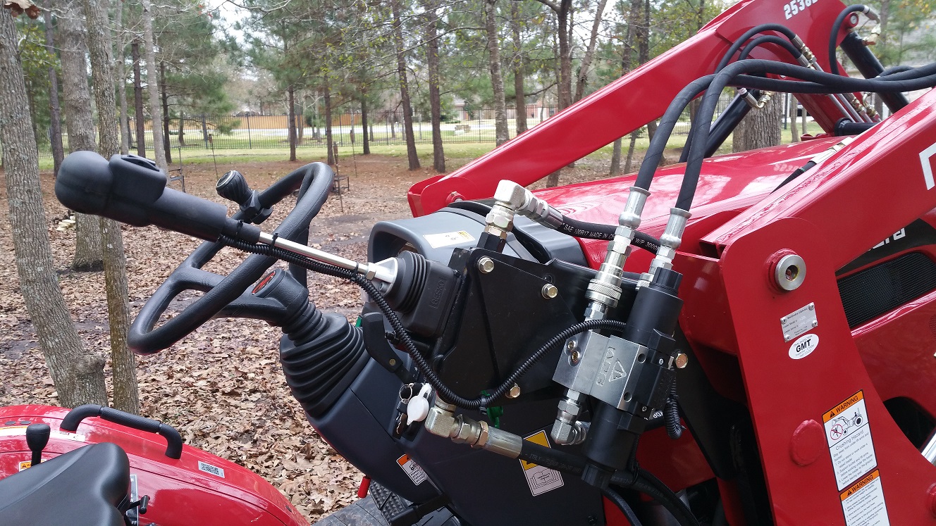

Here is a pic of the 3rd function valve and it bolts right onto side of loader control and then uses power beyond to route new power circuit to the front. Switch is easy to use with index or middle finger while utilizing other loader functions. The only other things you might need if DIY are some back zip ties and maybe caps for your hydraulic hoses on the front when you have the grapple off and are using a bucket. I put $5 male and female strapped caps on the tractor side of the front connections, and then just connect the grapple hose ends together to keep them clean when it is not in use.

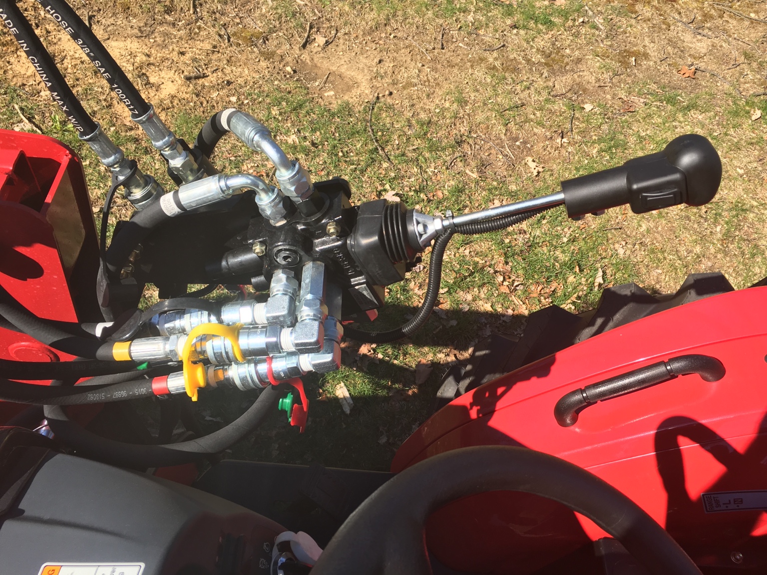

Image1462242760.836083.jpgImage1462242784.734666.jpg True third function right from Mahindra.

Nice setup Jgiannini! Roughshod - I think that there controller is the WR Long 3rd function. J5 Tractors here in Conroe was going to use it as well in tandem with the Mahindra grapple if I'd gone that route. Rather - I just sourced them both from EA. Looks like Jgiannini's dealer also used a WR Long unit... your concern about making sure folks are not sold a diverter is appreciated by guys like me though - so thanks for that. Take care all!
   / 1526/1533/2538 HST Price check #15
Agreed Snowback, that is a WR Long 3rd function for sure. Unless of course Mahindra just started buying WR Long 3rd function kits and reselling them, but I tend to doubt that. More likely is that the dealer implied it was a Mahindra branded 3rd function, and instead installed the WR Long. It's a pretty common practice. As evidence I would point to the 2538 online parts catalog, which has only one 3rd function kit for the 2538. http://parts.mahindrausa.com/dealerview/illustrationview.aspx
Look up this in the above link, sorry I can't directly attach it.
FIGURE SEARCH
=> Attachments => Loader => TYM-2538 LOADER (2538L, 2538CL) => 3RD FUNCTION KIT(TYM-2538L/CL FIG 10)
They only offer one 3rd function kit, it is from TYM, the same folks who made the tractor and loader, and the valve mounts on the loader cross arm. Out on the arm like that the only hydraulic pressure source and return is downstream of the FEL control valve work ports, and that makes the only OEM kit a diverter, not a true 3rd function.
But hey, you got a quality 3rd function kit from a very reputable source, so don't worry about it. Just don't think it is Mahindra branded, because it most certainly isn't. Believe me, I tried to buy one too and it didn't exist circa two months ago when I bought mine, and that is what led me to do the parts research. I called Mahindra corporate office and asked them about it, and they confirmed that the only kit was the TYM made unit referenced above. So go out and enjoy it, I know I love mine to death. In a little under two months I've already put about 60 hours on it, most of it pulling up trees using that same 3rd function kit we are discussing here. Love it, and I know you'll love yours!
