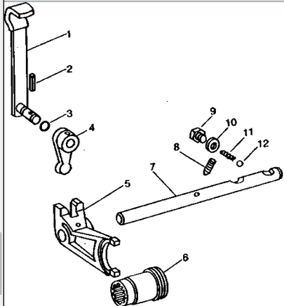

I agree there are only 4 reverse speeds all in low range. Lever(key 1) that resembles a question mark must be in forward position for pto to operate. Changing pto speeds if equipped which BTW I never seen(540 to 1000 & vice versa) is accomplished by changing rear pto stub shafts """"not by moving lever on LH side of trans case""".
HTH's,Jim

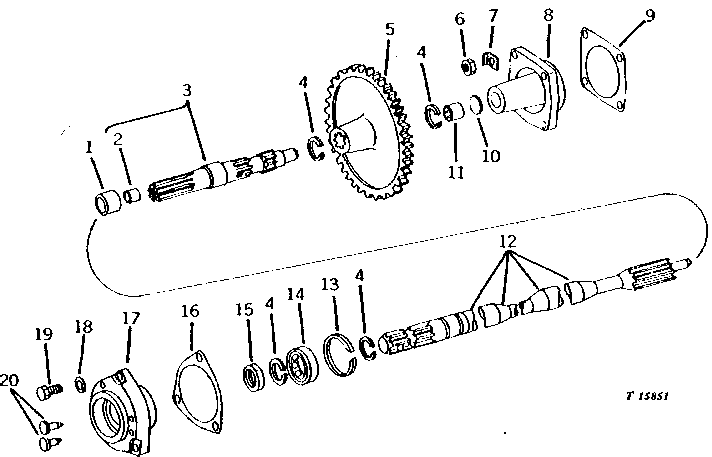

I thought the 1520 has several combination/options of PTO (Including no PTO at all - a blanking plate could be fitted): Rear 540 RPM, Rear 540-1000, Rear & Mid PTO, Rear Independent PTO with/without Mid-PTO...
It had optional hydraulic Reverser clutch as well.
For interest all the options are shown in the Parts Catalogue under Section 50 (Power Train) from where Jims pic of the "Question Mark" Lever is shown in Section 50 Page 73 (Rear Power Shaft Shifter Linkage).
In the same Section 70 Page 65 we can see the 540 RPM PTO Driven gear and shaft:
Gears & Shafts (540 RPM PTO) ( Less Independent PTO) T15851_________UN01JAN94.gif

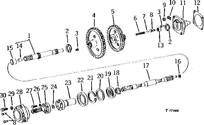

The 2-speed 540-1000 RPM PTO Gear-set is shown on S.50 Page 66:
Gears & Shafts (540 - 1000 RPM PTO) (Less Independent PTO) T17900_________UN01JAN94.gif

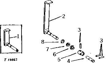

Mid-mount PTO was engaged from a lever on the opposite side of the trans to the "Question Mark" lever:

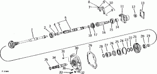

Independent PTO 540-1000 RPM with Mid-PTO:
Gears & Shafts (540-1000 RPM) (Independent PTO) (Mid-PTO) T17891_________UN01JAN94.gif
from S.50 Page 71.

The question mark shaped is to mechanically engage and disengage the PTO shaft. Internally there is a sliding collar that connects two shafts that "butt" together, making a mechanical connection.
It is NOT to change PTO speeds. IF the tractor has the 540 & 1000 rpm PTO option it would have an extra PTO shaft you swap after removing a snap ring. Easy way to tell is if the housing for the PTO shaft rear most bearing is triangle shaped and held on by 3 bolts, its a single 540 rpm PTO.
If equipped with a mid PTO, the mechanical engage/disengage lever is on the SAME (left) side as the rear PTO engage/disengage lever, just forward of it.
