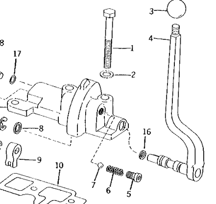

My husband has a 1520 John Deere tractor that he just purchased and it has an independent PTO lever between the gear shifts. We bought an owner's manual but there is no reference to how to operate this lever. I have searched the internet and cannot find any answers on how to operate it. Can someone please help us? Thanks in advance.

One can move the pto lever forward or up to engage at any time moving or sitting still,move lever opposite direction to stop pto. Be sure lever by left heel when sitting in seat is moved forward when engine isn't operating or no load on pto shaft.

I'm not trying to be rude BUT I thought I previously explained how pto lever(key 4) controlled pto. Move lever forward to engage & rearward to disengage pto. There is/was no hyd mechanism so tractor could be used as a two stage clutch. 2 stage clutch utilizes 2 clutch disks held in place by pressure plate to engine flywheel BUT your husbands tractor has only one(1) clutch plate in this area and this single clutch has no relationship to this tractors pto.
PS: I sold 1520's when they were NEW. I was employed by a JD dealer from '66-'87.
