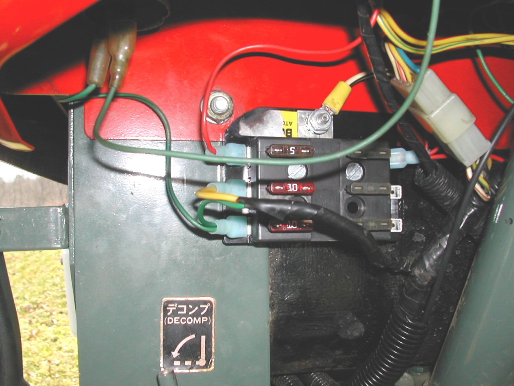

Anyone replaced the fuse block on a 1500d or similar? If so, what'd you use? Do you think there is one I can get at Napa? The one on the tractor doesn't look so great these days. It seems pretty crude, the "fuses" are more like open filaments and if it blows I probably would't know where to get any.

Not sure whether napa sells a generic fus block or not.. but you couls always take a trip to a junk yard, and pull one outta a junker.. just root around and find something you like.

Yes NAPA does. I put one in a 6x6 ATV I had. If NAPA's doesn't work for you, Radio Shack also has some.

I used a fuse block that I got from NAPA to replace the one on my YM1700. Unfortunately, I did not keep a record of the part number. I have attached a pic that shows how it looks. The mounting holes were the same as the old. The only change I had to make was to grind off one corner (visible in pic).

There are six fuses on the block, but only 4 are used. If you look closely, you will see wires connected to 4 terminals. I had some old fuses that I used on the right side, which are not as colorful as the ones on the left side.
