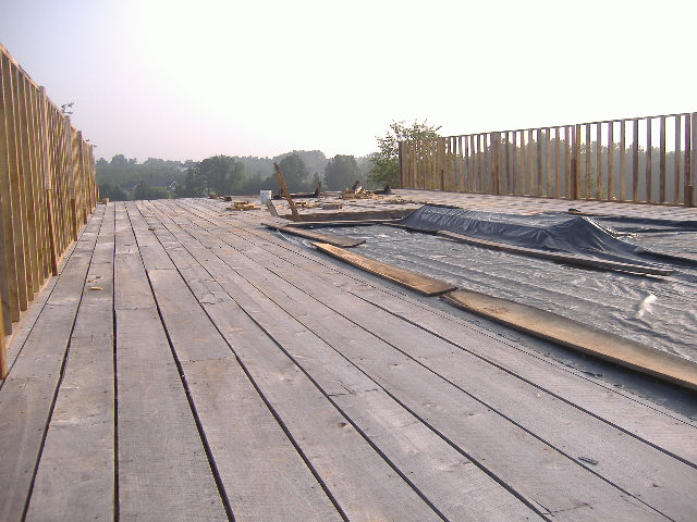

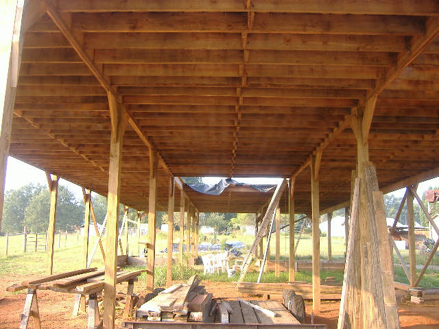

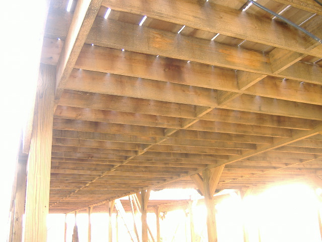

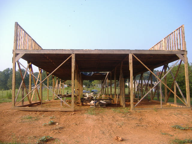

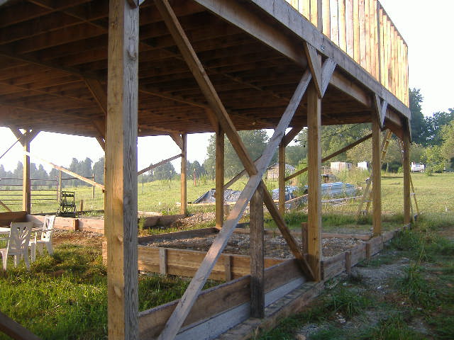

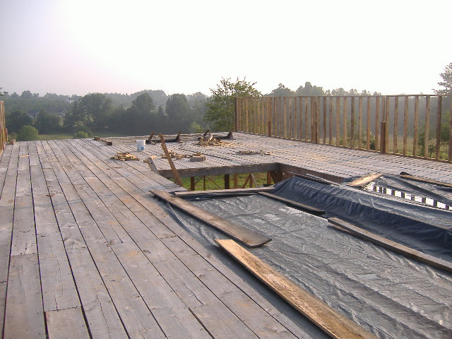

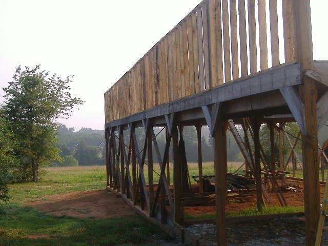

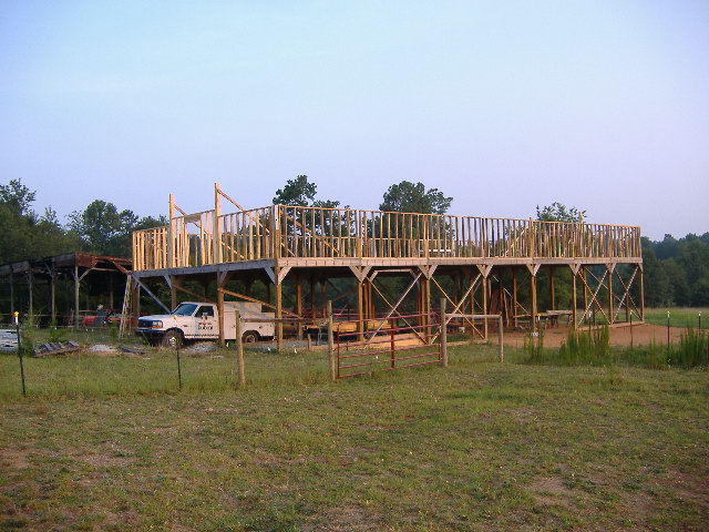

OK. I've been promising photos and finally got a camera handy. This project is being done by my friends and family. All the wood is rough sawn except for the posts which are 6x6 treated.
Here are some of the Specs
Each post is placed 12' square. Each stall will be 12'x12'.

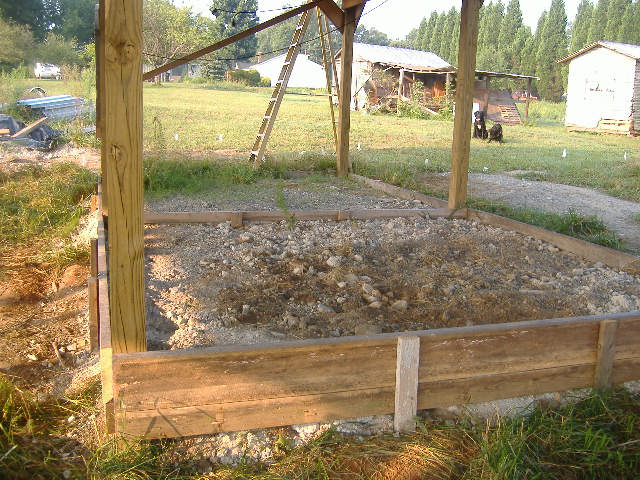

Only the tack room and wash stall will have concrete. The rest will be compacted clay. Each post is set 4ft deep with 2ft diameter of concrete.
Girder is 2x10, Floor is 2x8 and 16" on center, floor boards are 1" popular. Knee wall is 6ft high and studs are 16" on center. the roof pitch will be 4/12.
I'll add more info later as things develop. Sorry I didn't get initial photos. Expecially before the grading started. That was 60 dump loads ago:eek:

One suggestion - Your poplar hay loft floor will forever rain chaff and dust on everything below. If you could sheath the floor now with 1/4" plywood your barn below will stay a lot cleaner. My hay loft is floored with oak boards and it's a big problem.

Thanks for the input. I've considered the sheeting idea because the tack room will be covered in dust, hay etc. Since 1/2 osb is so cheep I've considered that. I really like to look of the floor. I'm just a nut for woodgrain.
I finished the front and back walls that will support the gable and frame in the hay access for the second floor. I don't have the photo handy so I have to post it tomorrow.
We have had a really hot summer and has caused a lot of headache with the green boards. They have a mind of their own in the heat. It's been a real challenge to keep things straight and plumb. Since this entire project thus far has been done on weekends I'll have to rethink how to tackle the roof with all this heat. I don't want to put so many boards in the air for the Sun to warp. Best plan this far is to take enough time off of work to complete the roof. That would be all rafters, center posts, beams and roofing metal. I'm thinking with the 3 man crew I have that will be at least a week. I hate working in the air. The height from loft floor is 14' at the peak. That's 22' at lowest point and 28' at the highest point from the ground.
Also an interesting note is that I have developed a really good swinging arm after driving all those 20 penny nails. Nail guns don't hold much even with the longest nail. They are too thin. I also had to buy a bigger hammer.:eek:

OK Here is the latest pic of the latest progress on the second floor of the barn. From the last pic this now includes the front and back hay loft walls. It will be two weeks before the lumber is cut for the roofing system. Time for a break.
Actually I thought the floor you put in is a better choice. The grooves will let the air through and keep it dry up there. Last thing you want is a bunch of hay in an area that can't breathe.

Tim, I've been trying to keep a balance between venting the barn and keeping the cold out. As you said the hay that will be stored up there will be a problem if not vented well.. If you notice from the pics I left a 12x12 section of the floor open to vent to ground level. The plan is to let the hot are move up and out and draw air from the ground level doors.

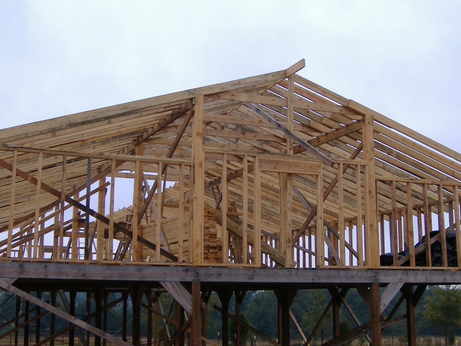

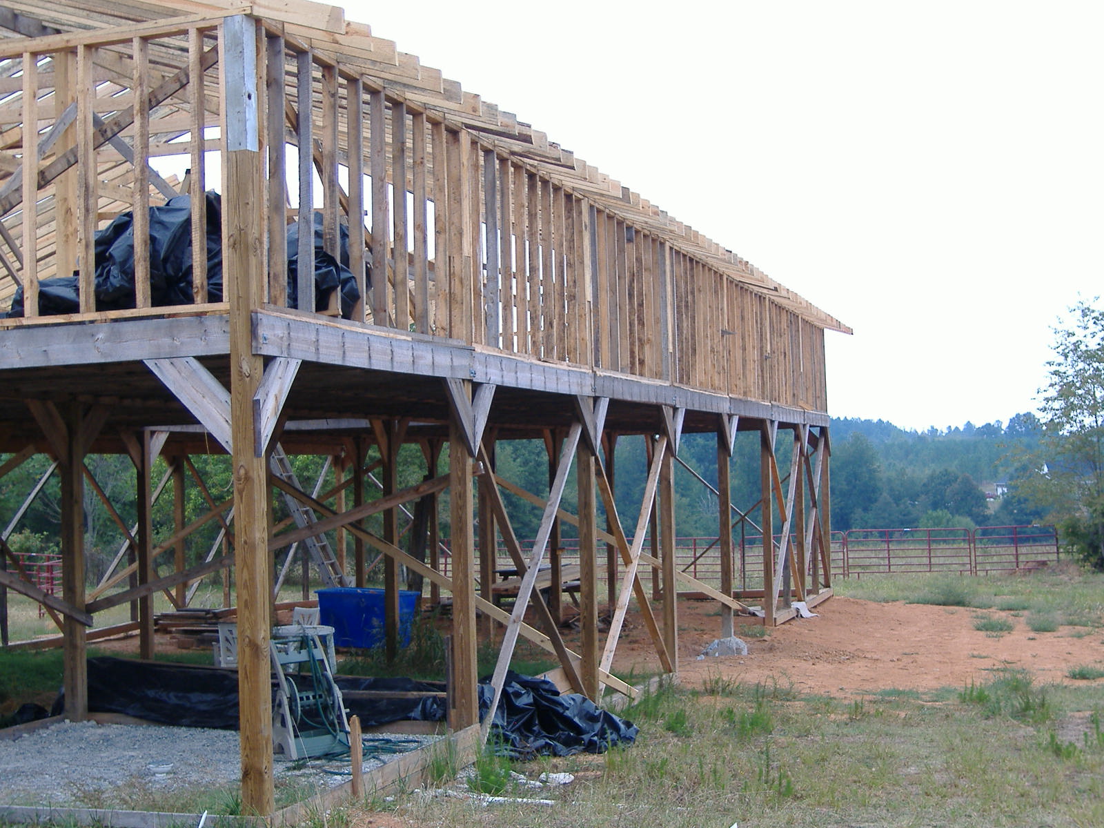

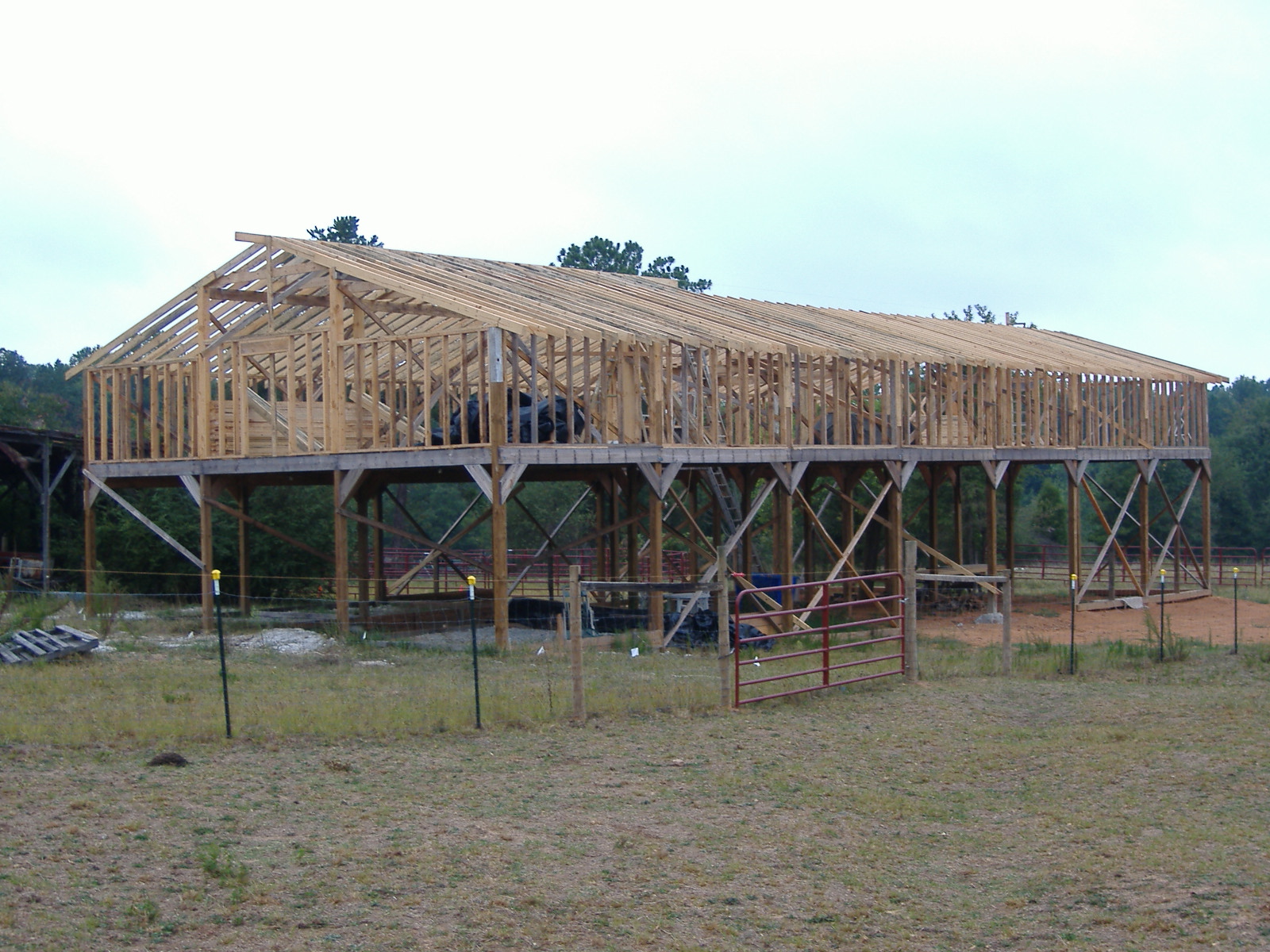

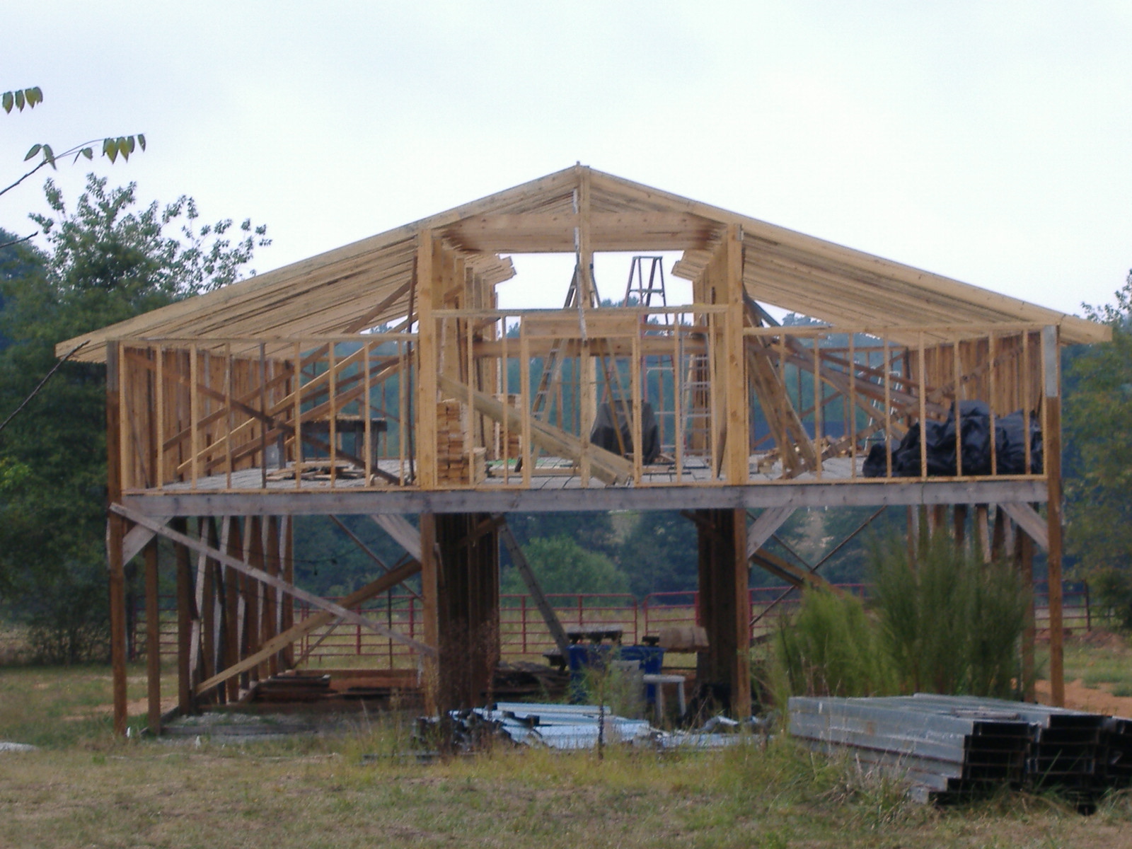

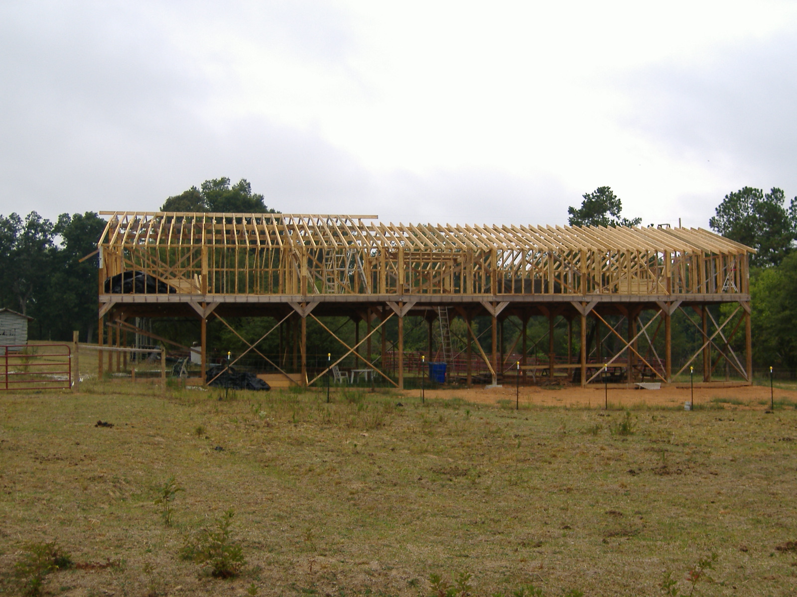

OK. It's been a month since I posted but here is the latest status on the barn. Most of the roofing system is done. Next is slats and metal.
Installed 6x6x10 posts on hay loft and tied in with 2x8x12
Next the 2x6x16 truss on either side were installed then the center ridge was installed with 2x6x8ft truss. Now this was a lot of lumber:eek: . I don't look forward to building another one. Hope it lasts. After this stage I called the insurance company to get it insured. Just too much labor to lose.
Enjoy. Metal will go on this weekend.

I'm a little confused on your framing. You said you are putting metal siding and roofing on, but you framed the walls a and roof for sheething. Metal goes on purlins, and you don't have any. What are you going to attach the metal to?

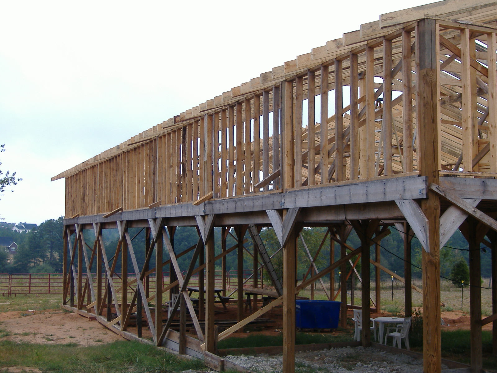

Hey Eddie, Purlins I think of wood that goes between studs,joices or trusses. But I think you mean slats nailed across the framing.
I haven't nailed all the slats on yet. I'll update with a photo Sunday when I get the rest of them on. The roof and hay loft will be slatted with 1x6's for the metal and the lower level with 2x4's since the span is longer without support. The cross bracing I used because I wasn't able to finish framing all the stalls before moving up to the hay loft and roof. You really don't want this thing falling down with all the lumber invested. My biggest fear.
