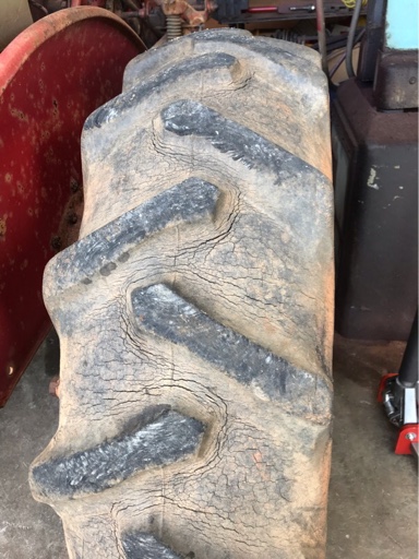

These were the condition of the tires on my 2004 L4630 when I bought it in 2014 and sold it in 2018.
Filled with rim guard and still no leaks. Sat in the Florida sun for most of its life
