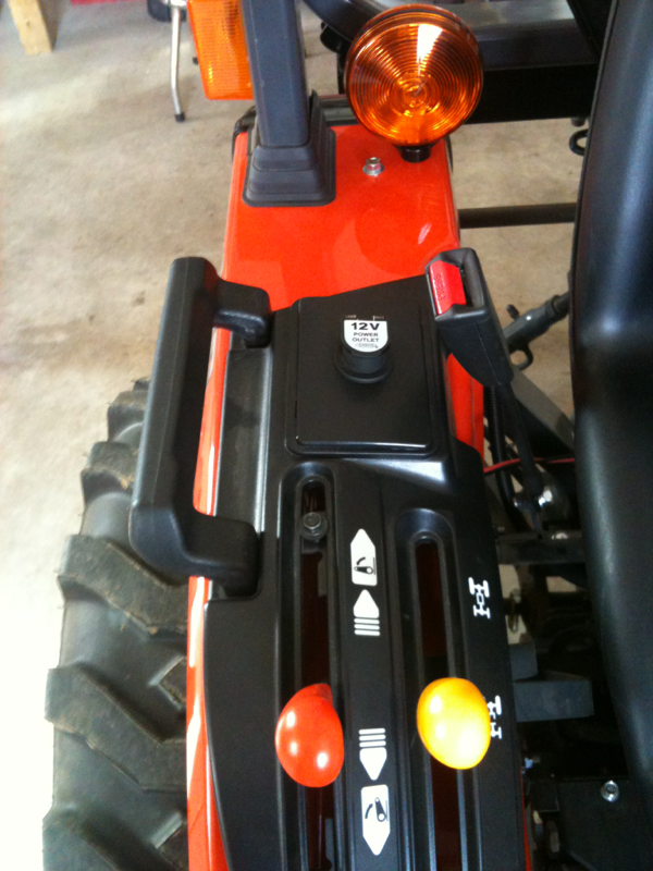

Not sure what to use it for.......possibly a cell phone charger or something, but I had it laying around the garage and decided to mount it. I used the dead plate next to the PTO and 3 pt hitch levers for the location.

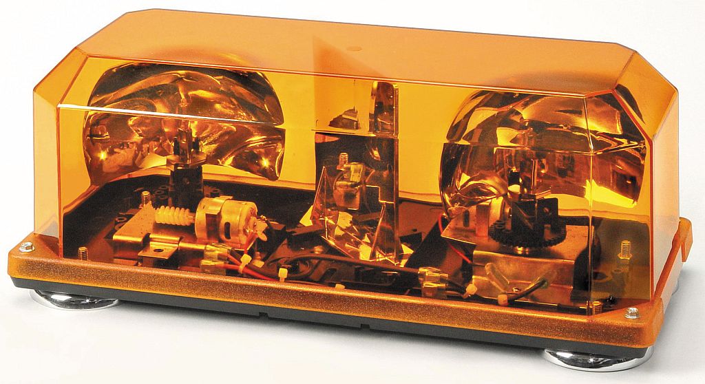

I added a 12v outlet to my Deere 4400. The first use will be for a warning light to be mounted on my ROPS. See the attached picture.
I'm sure I'll find other, occasional, uses...

You'll find many uses for a 12V outlet. Is it fused? I would think 5 amps minimum and no more than 10 amps. What gage wire did you use? I think it's a great idea, but as you can tell, I have lots of questions.;)

I used an inline fuse (10 Amps) and ran from the battery to the panel just below the ignition switch.
I did a thread on this:
http://www.tractorbynet.com/forums/john-deere-owning-operating/217876-adding-12volt-outlet.html
I used a Marine type outlet and plug for making it as weather proof as possible. You can buy automotive style inline fuses at any hardware or auto parts shop.
One thing I would have done differently is use 12 gage wire rather then the 14 gage I did use. All terminals were crimped and the run of the wires is in a heat resistant sheath. I wiretied the sheath about every 10-12 inches.
My installation is to power a warning lamp (see post #2).

At ten amps, 14 gauge is plenty, for that matter you could fuse 14 at 15 amps with no problem. The male portion that you plug into the power outlet may be another matter. Most are either meant for short heavy loads Ie cigar lighter, or lighter long loads such as cell phone charger. Buy the best you can find if you are making something up....

For an inline fuse, all the ones I found used 12 gage wire for the pigtails (as I'd previously written). Probably better to use the same wire gage throughout and especially if the run needs an inline splice (inline fuse pigtail to the rest of the wire) like mine did.
