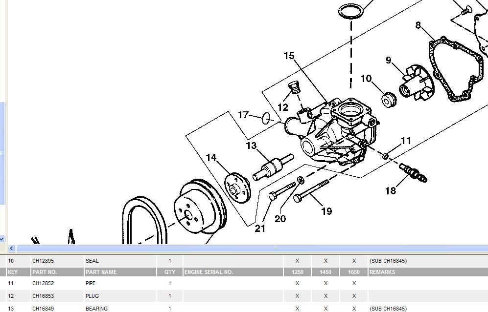

What does Deere want for one?
What is worn....the bearing, impeller, housing, or something else?
/ 1250 Water Pump
John Deere wants' $400.00 for one.
I haven't gotten it apart yet the countersunk screws are frozen and I'm soaking them in penatrant and going after an inpact driver to see if I can get them out. From the way it acts I think the impellor is either rotted off or slipping on the shaft because I'm getting 0 circulation of water. I know one thing for sure this will be my last 1250 to rebuild. Parts are entirely too hard to find and way too high when you find them.
/ 1250 Water Pump #6
Parts diagram.
/ 1250 Water Pump
Thanks' Beenthere!! Could you e-mail me that exploded view and parts list please? I cannot get to view properly off of the forum. Also is that a John Deere parts list or Yanmar?
