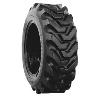

If you go to the Firestone(Bridgestone) website, & go under tires > agricultural > tirefinder > tiresize > 12.5 x 20. This is an R4 that might work on your current wheel size.
Its overall width is 12.7", overall diameter 40.0", & rolling circumference 121".

Thanks 73jeep I'll check it out.
