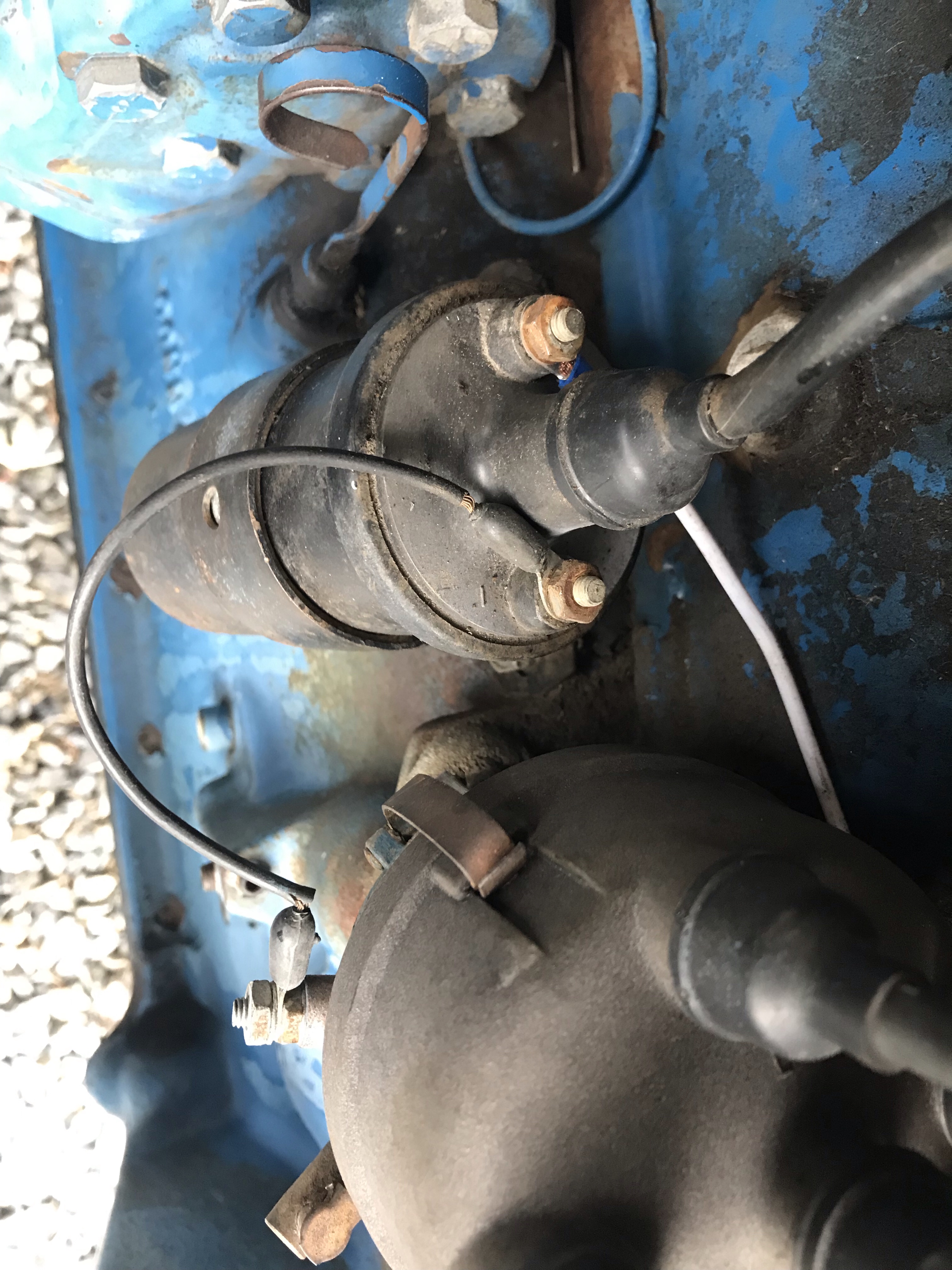

Disconnect the wires to the coil.
Reconnect the distributor wire to the NEGATIVE side of the coil.
Points make a connection to ground. You are switching to a Negative ground.

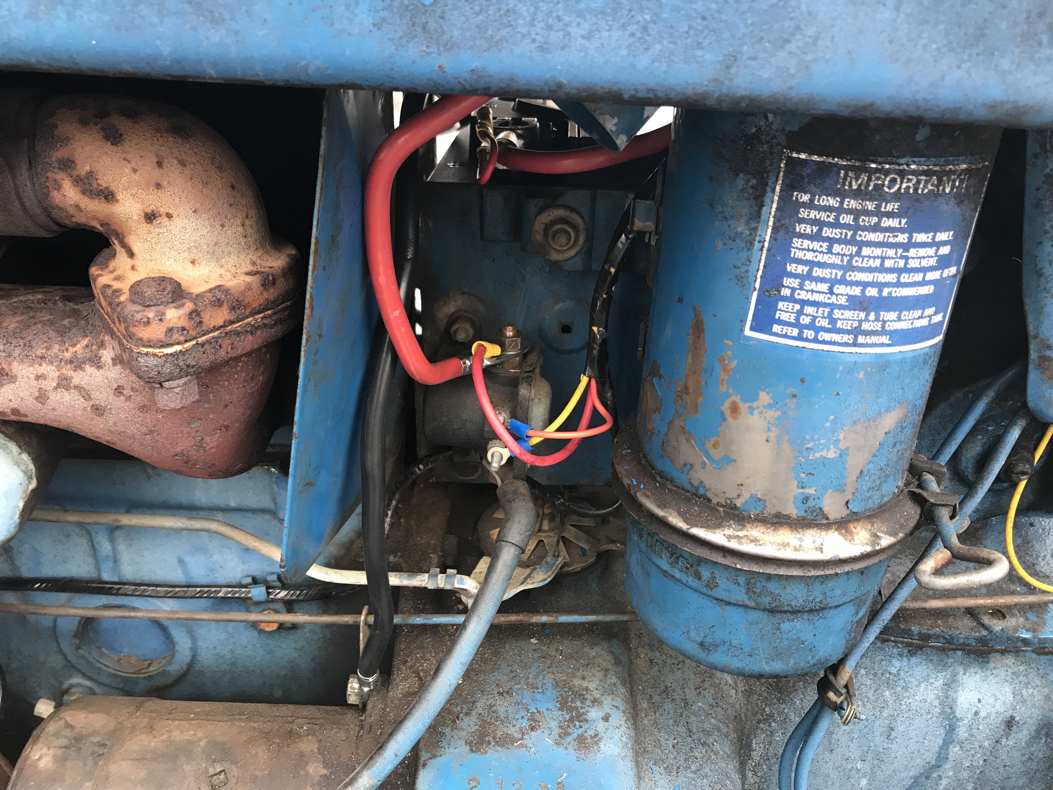

Now we are at the solenoid. Mine is a 4 post. This is NOT the average 4 post ford solenoid you get at NAPA though they look similar. One terminal goes to the starter switch push button on the transmission. Pay attention to which one that is. Mine was on the bottom small terminal as a single wire. (The YELLOW one)

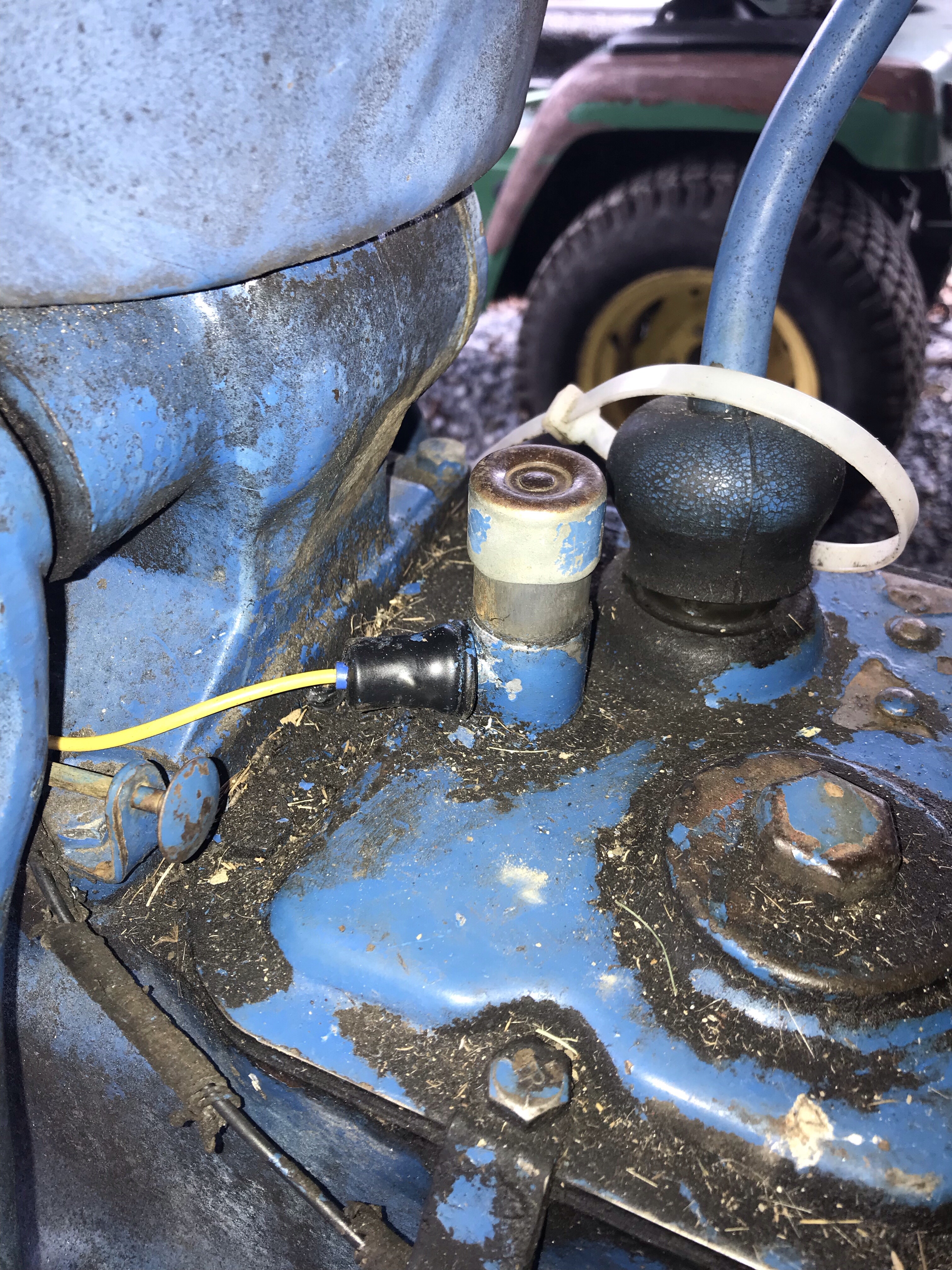

The other end of that yellow wire goes to the starter button. That rubber boot will be hard and crack when you try to get it off. It pulls straight back sliding on the wire to reveal the screw terminal connection inside. I’ll edit this when I find a replacement for that boot. IMG_1297.jpg
The POSITIVE battery cable goes on that top large post. I used 24 inch battery cables so I could move the battery out to connect and disconnect the battery terminals easier. Since you are doubling the voltage the current will decrease so you don’t need those huge stiff 6 volt cables any more.
This large top terminal is also where another wire (RED) goes. The other end of that wire is going up under the dash to feed the terminal block and key switch. We’ll get to that shortly.
The other small wire (my original had 2 tied together) on the top small terminal goes to the terminal block under the dash (we’re getting there) IMG_1298.jpg
EDIT My original wiring had two slip on terminals for the two small studs on the solenoid. I had to go find nuts for the ring terminals on the new harness.
#10 -32 fine thread was what I needed. Your mileage may vary.
The Orange and Yellow wires are discussed later in nauseating detail. Stay tuned.

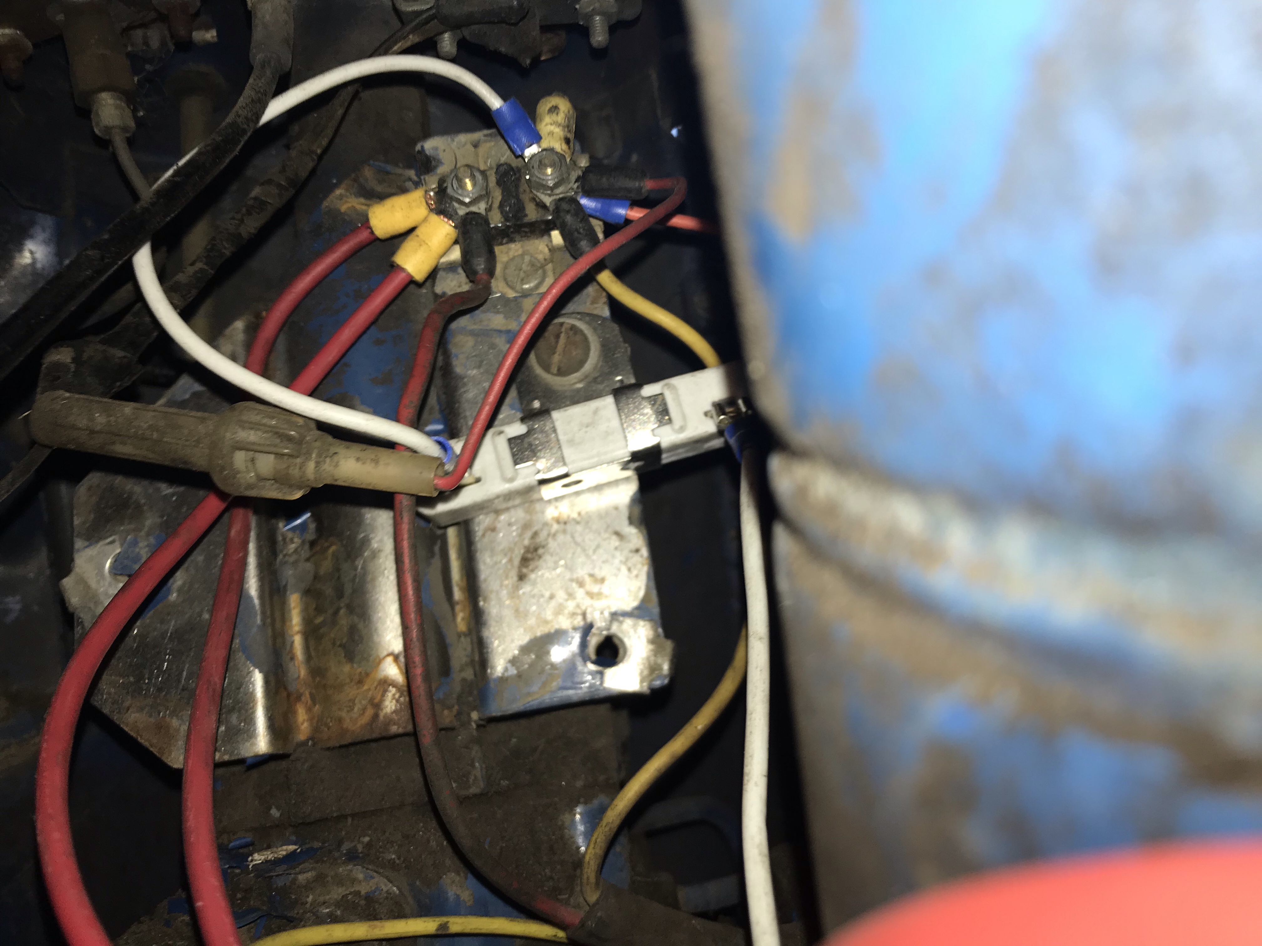

The old regulator is in there with 3 flat tip screws to remove it. Disconnect all the wires and unfasten the regulator and set it aside. Don’t be scared. And don’t lose the screws. We’re going to need them. We’ll get it all connected back up. (Hopefully)
There is a small terminal board above the regulator. Those two nuts come off too BUT PAY attention to what is connected to which one. Some we will have to put back on.
(I missed the before picture of this. If someone takes one, I’ll add it later.)
So whether you have an ammeter, a voltmeter, or a warning light, you are probably going to have to disconnect that particular thing and you will be ready to remove the harness from the dash. I have a light so I just twisted the socket from behind slightly and pulled the socket bulb and wiring out.
One side of that terminal strip is going to be hot from the battery positive connection on the starter relay. And it will have a wire going TO the key switch. The other wire coming FROM the key switch will go to the other one. This is how the key switch powers everything it should when ON.

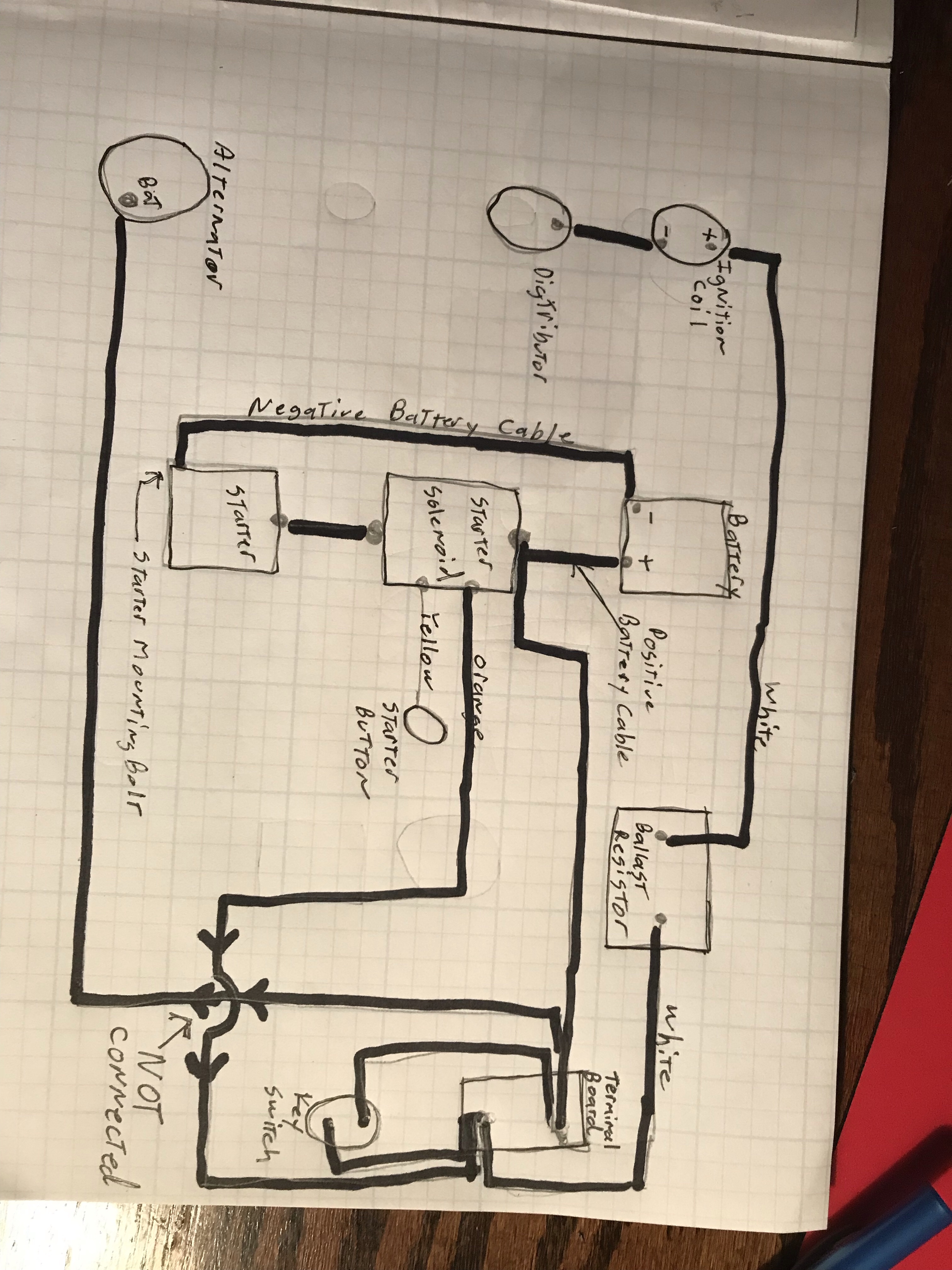

This is what we are working towards.
This doesn’t show the accessories like fuel gage, lights, indicator lights, etc. We’ll add them back on later.

Part 4 Under the dash
So. Looking at this picture the rectangular white thing is the ballast resistor. This cuts the voltage down from the charging voltage down to an acceptable level to feed the primary side of the coil. (The WHITE Wire)
It is mounted in one of the original holes where the Regulator was with one of the original screws.
White wire goes from positive side of the coil > to one side of the resistor (doesn’t matter which side). Opposite terminal of resistor with short White wire goes up to the Terminal board for the side that only has Power when the Key Switch is ON.
The Terminal board.
One side is Hot from the battery at all times. This is powered from that small wire (Red) that we put on top of the solenoid large terminal with the positive battery cable.
That old looking original red wire is going TO the key switch to supply power. That old looking Yellow wire is returning FROM the key switch to power everything on that side when the key is ON.
Next part describes more of the wires.

So now looking at the picture, there are two larger gauge RED wires on that left side. One of them is connected to the alternator output terminal. ( over there where I have the red lead of the multimeter attached.) completely off the subject you can see the White wire going to the coil from the ballast resistor routed behind the alternator and around the front of the engine.
The other one is connected to that large terminal on top of the solenoid with the positive battery cable aforementioned.IMG_1290.jpg
Here is where confusion could come in. That circuit is “supposed” to have the ammeter in it. I don’t have one and actually prefer a voltmeter. I haven’t got it yet.
The proper way for this circuit would be from the battery positive > to large terminal on solenoid top>Red wire to Ammeter terminal. Then from opposite Ammeter terminal that other Red wire goes to that alternator output (batt) terminal on back of alternator.
(Whew, clear as mud.)
You are in effect cutting the wire and inserting the Ammeter in series so it reads amps going to Battery (charging) and amps leaving battery to feed something like starter, lights, etc. (discharging). My kit harness was made for the Ammeter so I used the Terminal board for a convenient place to connect them.
By the way. If you managed to understand all this convoluted information and get it hooked up and the Ammeter is reading opposite of what it should be, just swap the wires on the back of it.
Remember to unhook the battery though! Let’s not make sparks near the gas tank (or anywhere) from that on always Hot wire connected.

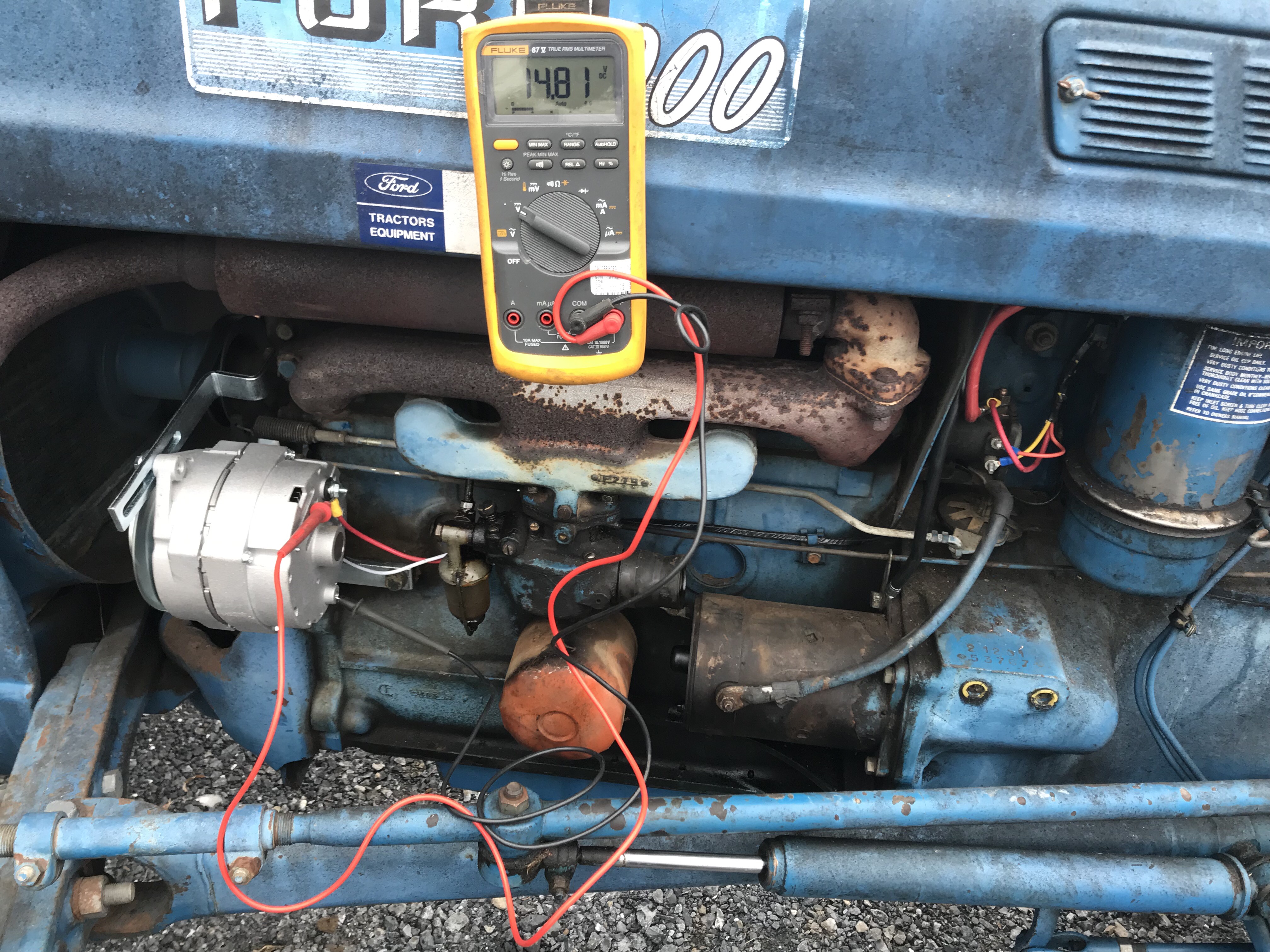

On to the physical mounting. We will come back to the wiring in a bit.
As said before, this was straight forward. Remove the old generator top bracket bolts, bottom bracket bolts and remove the generator. Now remove the brackets from the engine block but keep the bolts.
My kit came with brackets. I have read that you can flip the original generator lower bracket, shim the alternator in line with flat washers and bolt it with a long all thread or stud with nuts.
I didn’t do that.
I have power steering so I had the extra step of removing the power steering belt in order to replace the generator belt with a new slightly longer one for the alternator. I don’t have id numbers for this or length. When I find that info, I’ll add it here.
I pulled one cotter pin and used a pin punch to remove and replace the mounting pin on the power steering pump. IMG_1339.jpg
Fairly easy stuff. I pulled the belt back with my hands “good nuff” and tightened the bolt.
