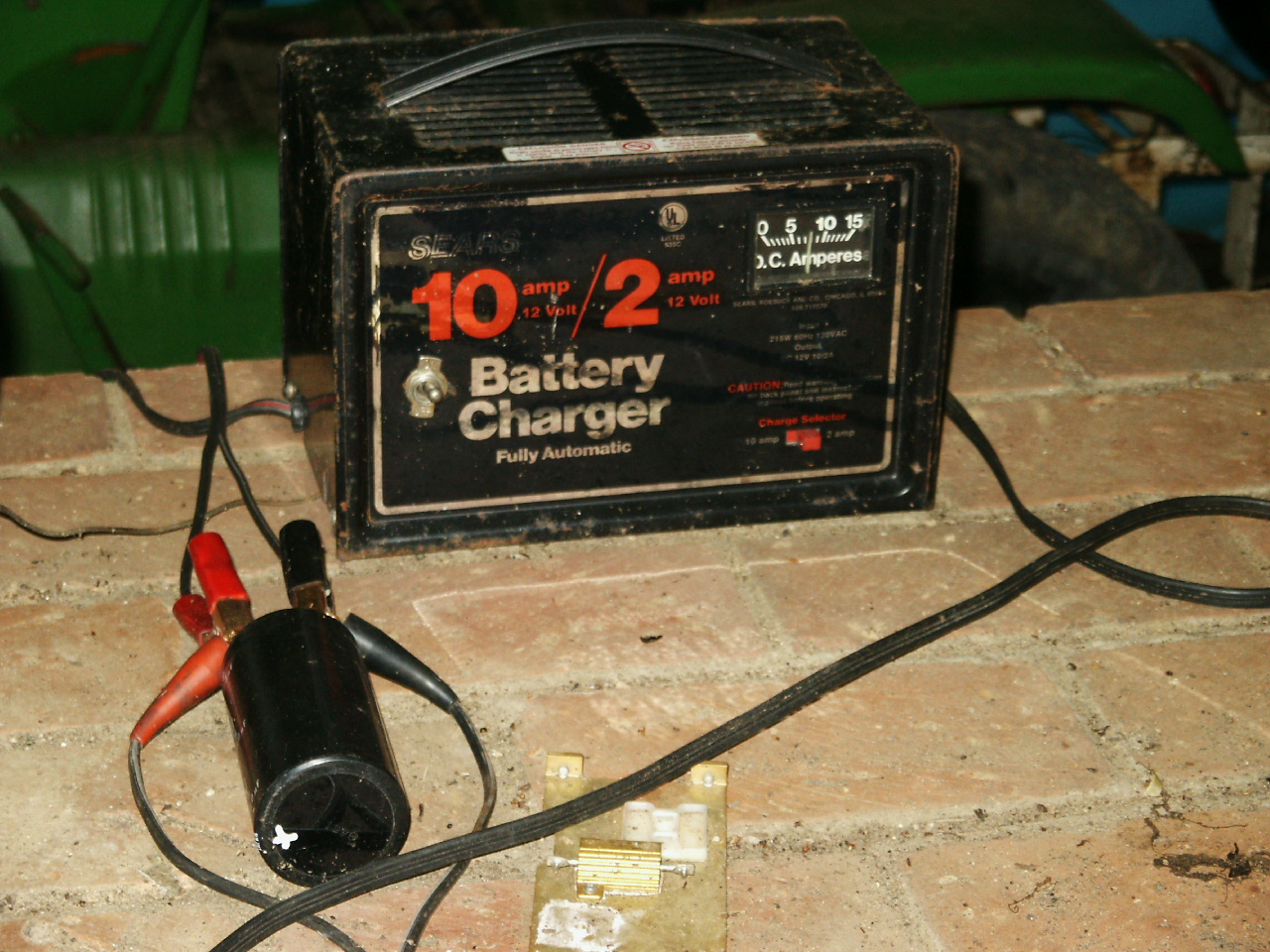

It works extremely well. Get an old bucket, barrel or tank, a battery charger, some sacrificial metal and have at it. Just make sure you get the polarity right.
M.D.

As Tom said a battery charger works fine. I use an old sears 12/2 amp charger. I use it on the low setting most of the time, draws about 6 or 7 amps. I started out with a 5 gallon bucket and moved up to a 100 gal tank. I've put tractor rims, parts and whole engine blocks in there to de-rust. In the big tank I put 2 boxes of Arm & Hammer washing soda. I didn't want to use that much water from my well at one time either so each time a load of laundry was was done I pumped the used water to the tank. For my sacrificial metal had had 4 used brake rotors that I welded to 1/2 rod. They're pitted but still working after 3 years. To keep the rod from being consumed by the process I just let the crud build up on them and don't clean it off. It insulates them from the process. Oh yeah, the tank in my pictures is a Rubbermade tank. It sprung a leak. Get one of the 110 gal rubber stock tanks from Tractor Supply.
M.D.
