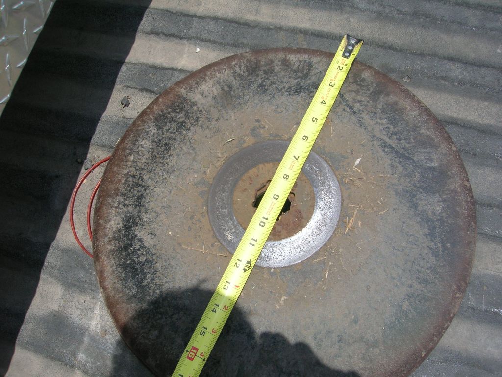

Here are two pics of the axle taken apart. Sorry they arent too clear, the camera I have has decided to only taken fuzzy pics now.
As you can see the axle is round, and the spacers hold the thing together when tightened with the large nut on the ends.

Last couple photos Ive got. These are the blades I took off. The axle is round. The blades appear to be 1.5" centers, varying between round and square with the points.
I have no idea whatsoever which set of blades I am supposed to get. As you can see the 1.5" is uniform, but the type and everything else is different.
Do those spacers between the discs actually tighten down enough to hold these things from spinning freely on the axle?
The concavity appears to be 2" on the round discs.
Can anyone tell me how this is supposed to be, and whether or not something is not right here?
I just want to get some new discs, and have this thing cut nicely.
Thanks!

   / 12' Disc NEED HELP #16
Also rule out Ferguson/Massey Harris/Massey Ferguson. I've been through machinery brochures from all three back to the 1940's and no disc like that'n!
   / 12' Disc NEED HELP #17
Thanks!
When you tighten them down with a 1" impact, and then tighten them just a tad bit more with a 6' cheater bar, that should get you about 2000lbs of torque. That should be plenty tight so as the disks will not spin at all, let alone freely.;)

Alright, well I think Ive got it. The 1.5" center seems to be way too large for this disc. I couldnt even find a new disc blade with a 1.5 center axle.
Looking at the pics, I can see that each disc has alot of space around the axles. So Ive decided to go with an 18" Notched front discs with 1 1/8" round center,
18 4.5MM Notched Disc Harrow Blade - Agri Supply
Im going to replace the front gangs with these, and then reuse the best circular blades on the back...they are all about 17-18 inches, so I reckon it oughta work alright.
Anyone see any problems with that?

I've never seen a disc of that size with anything but 1" or 1-1/8" axles. So you're on the right track.
Often times, 1-1/8" SQUARE axle disc blades will have an 8-point star shaped center hole that will also work on a ROUND axle. They can be a little confusing.
What you're talking about doing, putting new blades on the front and the better used ones on the rear is a common practice.
If you get down to picking from a few odd sized disc blades for the rear gangs, put smaller ones at the extreme outside ends of each gang. That actually HELPS with leveling. It somewhat eliminates the "furrow" that the outer disc can leave.
When you re-assemble, tighten the gang bolt (axle) as tight as you can possibly get it. After a bit of use, go back and re-tighten. That creates an integral strength throughout the axle, spools, and disc's. With the axle loose, you stand a MUCH greater chance of breaking disc blades. (Not to mention "spontanious disassembly" while in the field :eek: )
