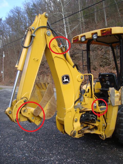

The thumb would require the 7 function backhoe hydraulics which is easy to spot, you would have a set of auxillary hydraulic couplers mounted on the dipper stick. This operated by a foot pedal on the left side of the platform floor. I use this circuit to run a hydraulic auger (PA30). I don't have the thumb and am sure it could be handy to have but you dont miss what you don't have.

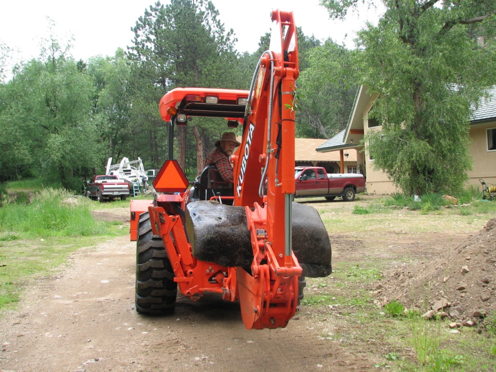

I would call it a Deal Maker if it has one but not a Deal Breaker if it doesn't. But if it doesn't I would argue the price down enough to add one. Find out from JD how much they are. Yes, a thumb can be added to any hoe. For the JD110 I think it best to stick to an OEM JD thumb that is made to fit. The geometry is tricky and the JD hydraulics are different from others. Stick to JD on JD.
As to why you need one I'll just say that you need to listen more to people who have a thumb on their hoe rather than people who don't. And ask them if they would consider having a hoe without one. It's sort of like changing from gears to a hydrostatic transmission. Us old guys didn't want to change. We had to use one for a year to finally convince ourselves that a clutch and gearbox might work, but basically there was a better way.

as you can see in this photo the backhoe has the 7 function hydraulics, the foot pedal and auxiliary hydraulic couplers with red caps,
it would be easy to add a thumb to this one.
