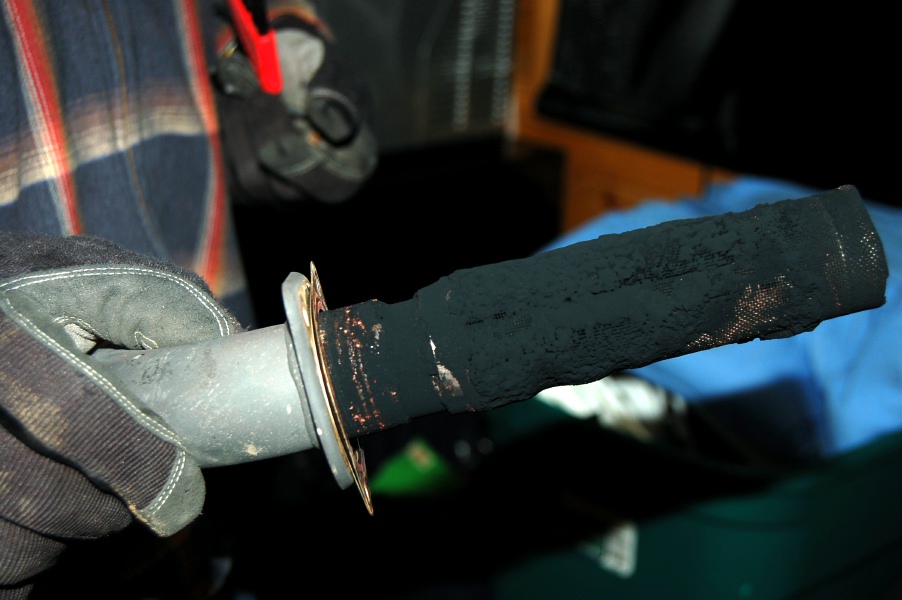

Thanks to Mikeyd,
Friend found the spark arrestor, it was a internal style !!! he has only a few hours on his unit. I'm attaching a pic of this thing >>>> it's so clogged up, I don't see how this machine even run >>>> And on top of that, he's running tracks in the mountains >>>>
Done some research today, and found out that the new 900's will have the internal arrestor system like the 1100 series, not just the screen caps.
So seeing what I've seen on mine, and seeing this on his, I would advise folks to remove these things, so their engines a work at their best performance.....

/ 1100 >>> arrestor Gone !!!!
Removing it is really easy....
And from talking to a Kubota production engineer, and sending him the photo, he & Kubota knows of the situations, but the goverment make 'em install them for reasons on running on goverment property. By law, any equipment running on gov. property, will have a spark arrestor on it ....
Does not effect the warranty at all >>>>
And it's all up to the owner / customer to remove them. I know on my 900, just within a few hours, mine was clogging up. And I removed it, and instantly, you could tell the differance in performance, but of course, it could breath better. And didn't get any louder at all >>>>>
Now if a man wanted to keep it on, he has that option, but he would have to keep a watch on it , and clean it often ~~~~

I know is my case, think it was somewhere in the 10-13 hour of it being new, I notice my performance making a dive, someone stated, " check the arrestor " I did, and it looked just like that one in the picture, but smaller.
Mine was the cap on the end of the tailpipe, I removed it, and like to have passed out. Ripped out the screen and re-installed the cap. And my performance JUMPED right back up. Heck, all them arrestor systems do is slow down the diesels....
I know it's not Kubota's fault, it the goverment making them install them ....
