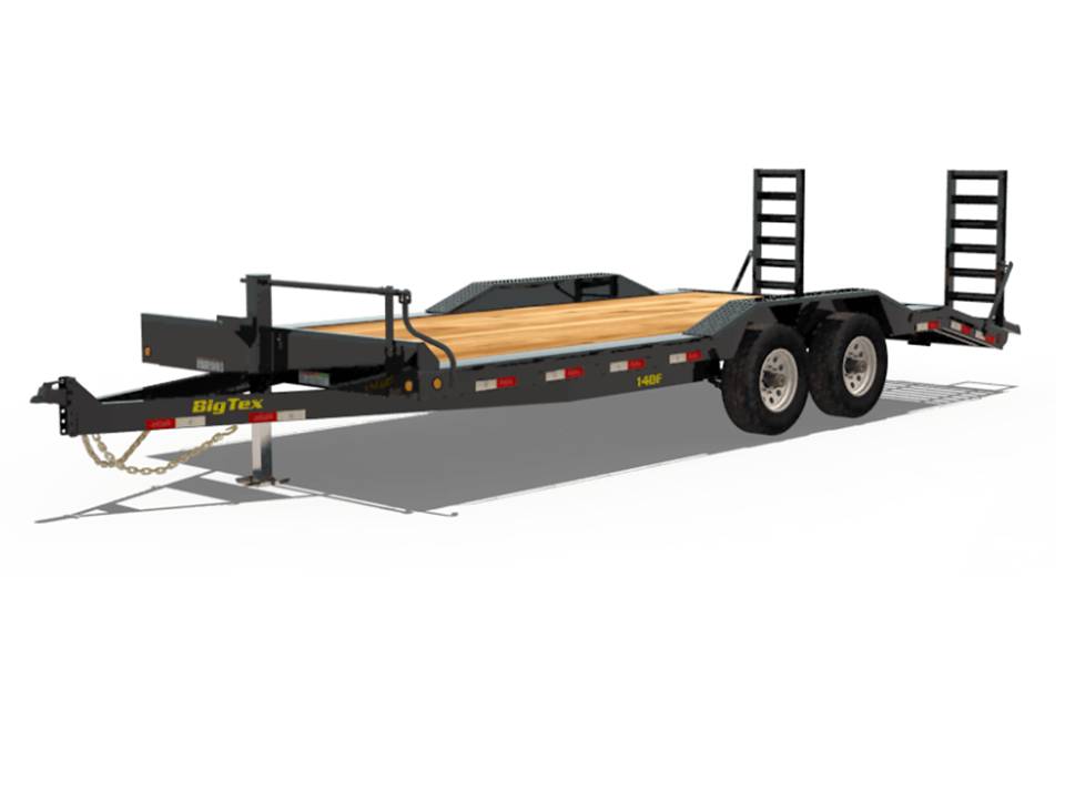

Have to many trailers and need more then my car trailer. Going to buy a tractor (60 to 80 hp) which will be in the 6K to 8K load range. May get some other attachments, but for right now, just trying to figure issues with two different type trailers. Plan to use a 2 5/16 or pintle but like 2 5/16 better due to less wobble/noise.
The tractor will fit between a 102 inch width trailer with fenders but a tilt trailer could make things easier in one area, but may have issues in another. What issues have been found with these different types?
I do have a 10 Ton pintle hitch trailer, but it is real heavy and would need to haul using the dump truck with a large load. I want to haul using the 2500 pickup
I prefer a deck over tilt, no fenders when loading pallets, tanks, odd shaped stuff. Mine is a hydraulic tilt with wireless remote, so I can adjust angle on demand. A 60-80 hp tractor can load on most dovetail trailers without using ramps. I prefer a pintle for ease of attaching but a back up camera and 2 5/16 ball are pretty easy too.

BigTex (I'm sure also others) have drive over fenders an can get them in 10 and 14K GVWR an lengths 18 to 22 feet
   / 10K Deck over tilt or with ramps #29
They might fit your needs, I wrote them off for me as the fenders still interfere with side loading. They seem to be popular with wide vehicles like rock crawlers where they need the extra width but dont want a deck over. I'd rather have a full deck over for my needs personally or go with a regular low bed tilt.
