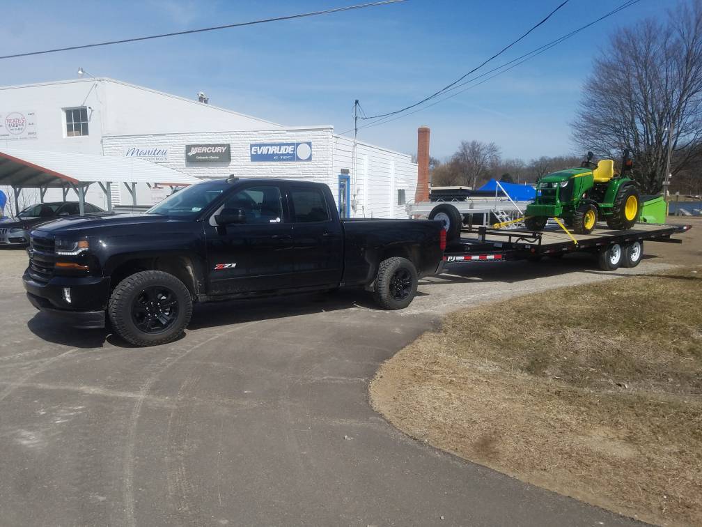

83" is the widest you can get on a tilting deck between the fenders & be legal. I ended up going for a deckover power tilt to avoid fenders. 10something inches wide. Its nicer for loading any thing put a tractor on (over the sides). But the deck is a fair bit steeper for loading a tractor or vehicle on due to approach & departure angles.
It has a pair of 7k axles & pretty heavy construction. It weighs in at 4k lbs. My 40hp L4060 weighs in at a little over 5klbs with loader & loaded tires. I could only barely haul it on 10k trailer. That doesnt even factor in 1-2k of impliments I usually have. A 60-80 hp machine is going to be noticably heavier & might not even fit safely on a 14k trailer.
