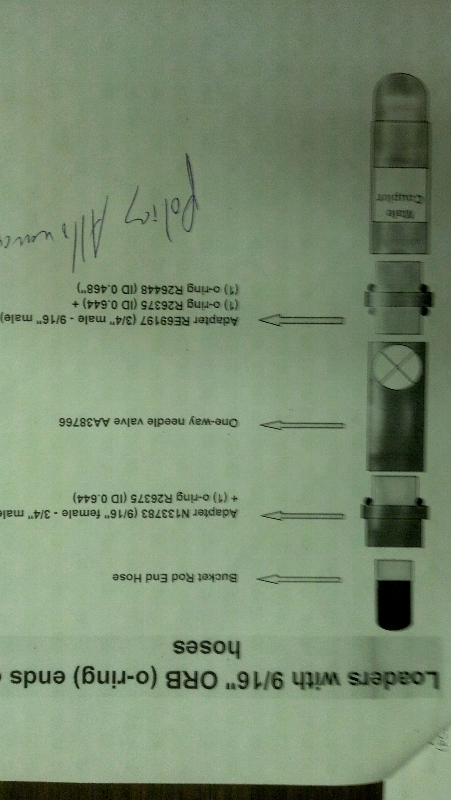

Has anyone had any problems with their bucket not holding down pressure? I have been using mine alot lately to move dirt and every time I tilt the bucket to back drag with it, it just goes flat. It acts as if it has air in the hydraulic system, but it never does it when I'm breaking dirt out of the pile. I thought it saw this topic brought up but was unable to find it. The dealer has been out and are working on a solution, but I figured I'm probably not the only one having this issue so I thought I would ask.

So I just got back from the dealer and found out I'm not crazy. They have had other complaints about it and they do have a fix for it. If I understand it correct they will be installing a check valve in the rod end of the bucket hose and that will prevent the problem. I probably shouldn't post this but I will, the DTAC solution number is 35065, so if you talk to your dealer reference that number. Here is a picture of the diagram they showed me, sorry its poor quality.
Looks like what they are installing is a one way flow control that I suspect will prevent the bucket from "running away" (dumping to fast) and cavitating the curl cylinder.
Regenerative mode is supposed to reduce or eliminate this. NOTE: I do not know if your JD has this feature or not.
Regenerative mode description: Oil from the rod of the cylinder is directed back into the cap end of the cylinder which increases the cylinder extend speed and reduces the cylinder extend force.
/ 1026R loader problems
Oldnslo_ thank you. Your description of the problem was almost word for word of the DTAC solution. They dealer called the valve the "back drag valve". Also thanks for explanation of regen.

Your diagram is upside down. Can you fix it and repost?
#12
#13
Im not for sure but it keeps rotating it upside down
