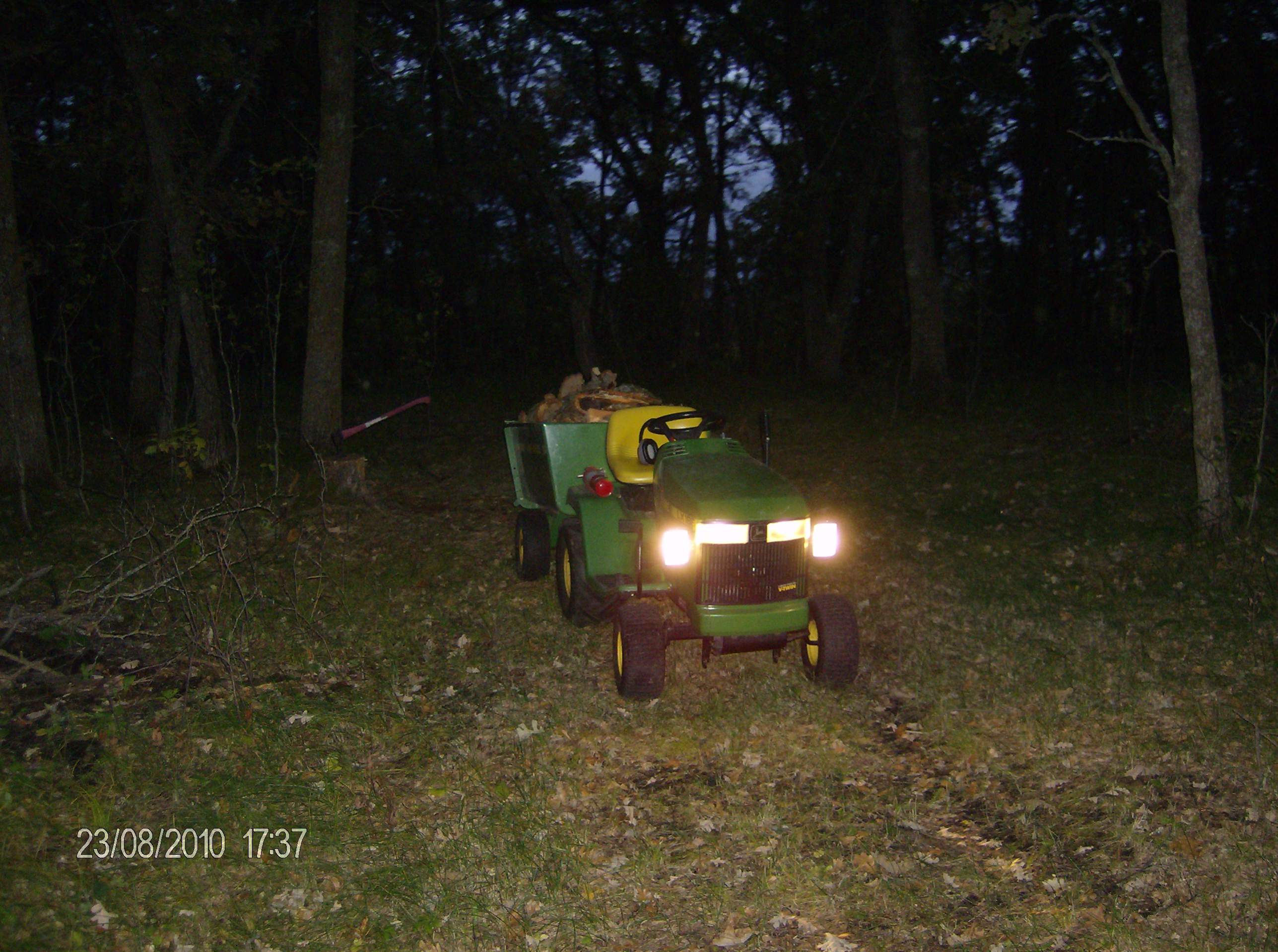

For an LX188, I needed to know how many 50-amp flood lights a 12-volt 15-amp alternator on the Kawasaki engine could supply before I ran down the battery.
I used an online conversion, similar to this one"
Volts/Amps/Watts Converter | Supercircuits
One thing I have found out is that the little crimp butt-connectors just do not hold that well. They were especially troublesome where I wanted to wire a 12-gauge and 16-gauge (on the light) wire together. A mechanic friend of mine showed me this little torch that he uses for soldering wires. He always used the solder type connectors with this little "pen torch"
I pull the plastic off the connectors and slide a piece of shrink-wrap over one end, crimp the connector on, and use the little butane torch (1/4 to 1/2 inch blue flame) to melt some radio shack silver solder in there. Once it cools, I give a slight tug on the wire to ensure that it is a solid connection and wont pull out. Then, I slide the shrink wrap up and use a Makita heat gun. The only problem was when I did not leave enough slack in the wires under the hood and pulled them loose when I closed down the hood.
I went battery-direct, with in-line blade fuse and heavy-duty 12-volt switches on the dash. I fasten the wires out of the way under the deck for the rear light and sprayer connector with plastic wire grommets. Holes in sheet metal have the rubber grommets, which do not always seem to stay in place.
I ran two 50 watt flood lights to the front and one to the rear. There is also a switched 2-wire trailer connector for the 12-volt trailer sprayer.
The difference between the "factory" lights in the hood and the flood lights is like car headlights verses holding 2 candles out front.
