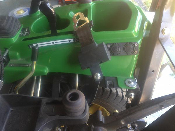

I heard that the 1025r was supposed to have plugs at the base of the ROPS for adding extra lighting, but I can't find anything obvious. Can anyone help?
/ 1025r extra lights plugs? #2
On my 3320 they were bundled under the seat pan even though the instructions said they were supposed to be tied to the ROPs.
/ 1025r extra lights plugs? #3
1025R has a 12V outlet on the right side near the cup holder.
Thanks everyone.
Mine doesn't have those 12v outlets in that location.
I will look under the seat pan.
I found them! They look like little black tubes at the end of wires two on each side that aren't connected. They have a crease as though they come apart, but so far I haven't opened them up yet. Worst comes to worst, I can cut them off and splice directly to the wires of the new lights.
