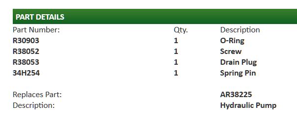

To eliminate hyd possible hyd pump problem I would recommend to purchase and install a hyd pump destroking screw(AR38225 which subs to the listed PN's[parts key #4]) if one is not already installed. If hyd pump load isn't the problem then I suggest to attempt to turn engine utilizing a bar. Might also pull injectors to check for hydro locking. If it still won't turn over then I'd suggest to pull engine oil pan for a visual inspection of brgs and liners.
