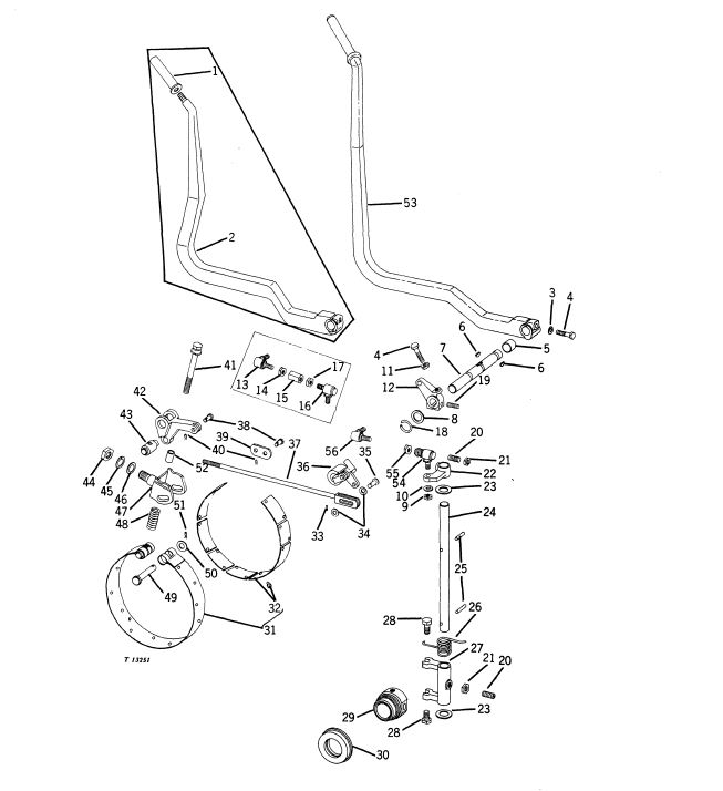

i know this is an old post but did the 2010 have wet steering clutches..i know i got a 1010 and it will start and run all day long but to get it to steer or keep the tracks on is a different problem...the tracks are worn out so i understand that ..but i've replaced seal upon seal and you have to take the whole side off to do that ..and the stealing clutches are always soaked ..bought new clutches too..i'm just wondering if they have the same clutches as say a 350 b...now that was a good dozer
DRY steering

yes you are right ..i call that the break band but its also the steering band ...i'm talking about the drive clutches that hook the axle to the final drives ..they always slip they are just a mess ...the 350 jd has more a set of clutches in there that work like a limited slip or posi track truck rear end ..i should be more clear when i explain myself but to tell ya the truth i don't understand how to hahaha i see it in my head but no way of showing it
