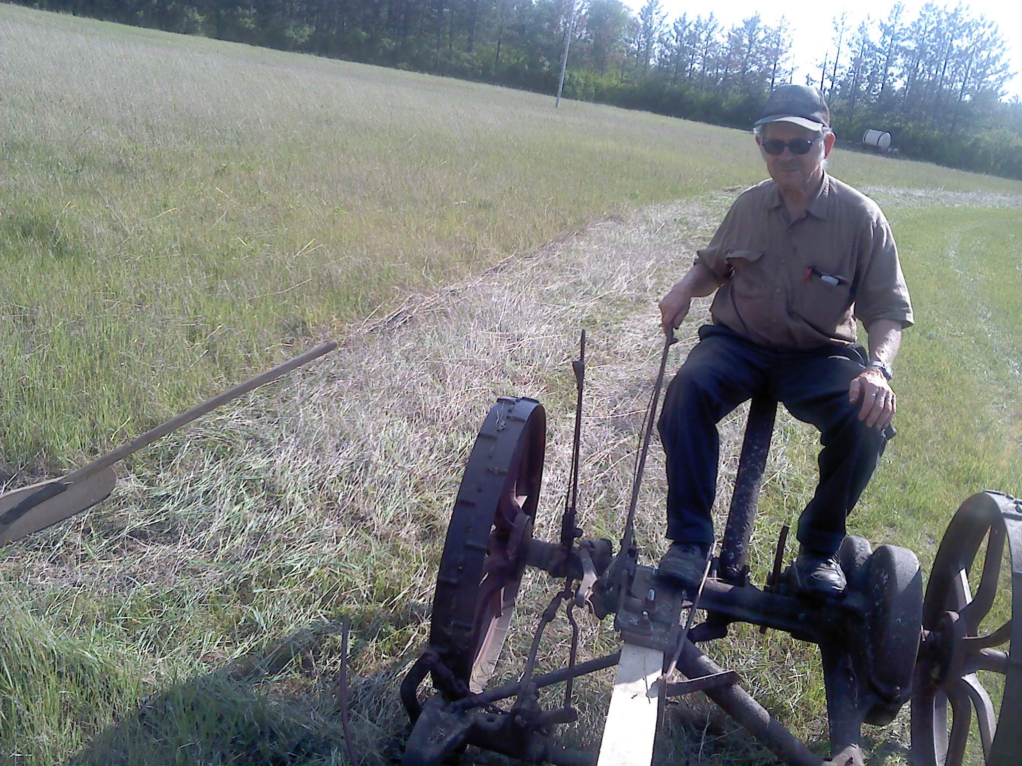

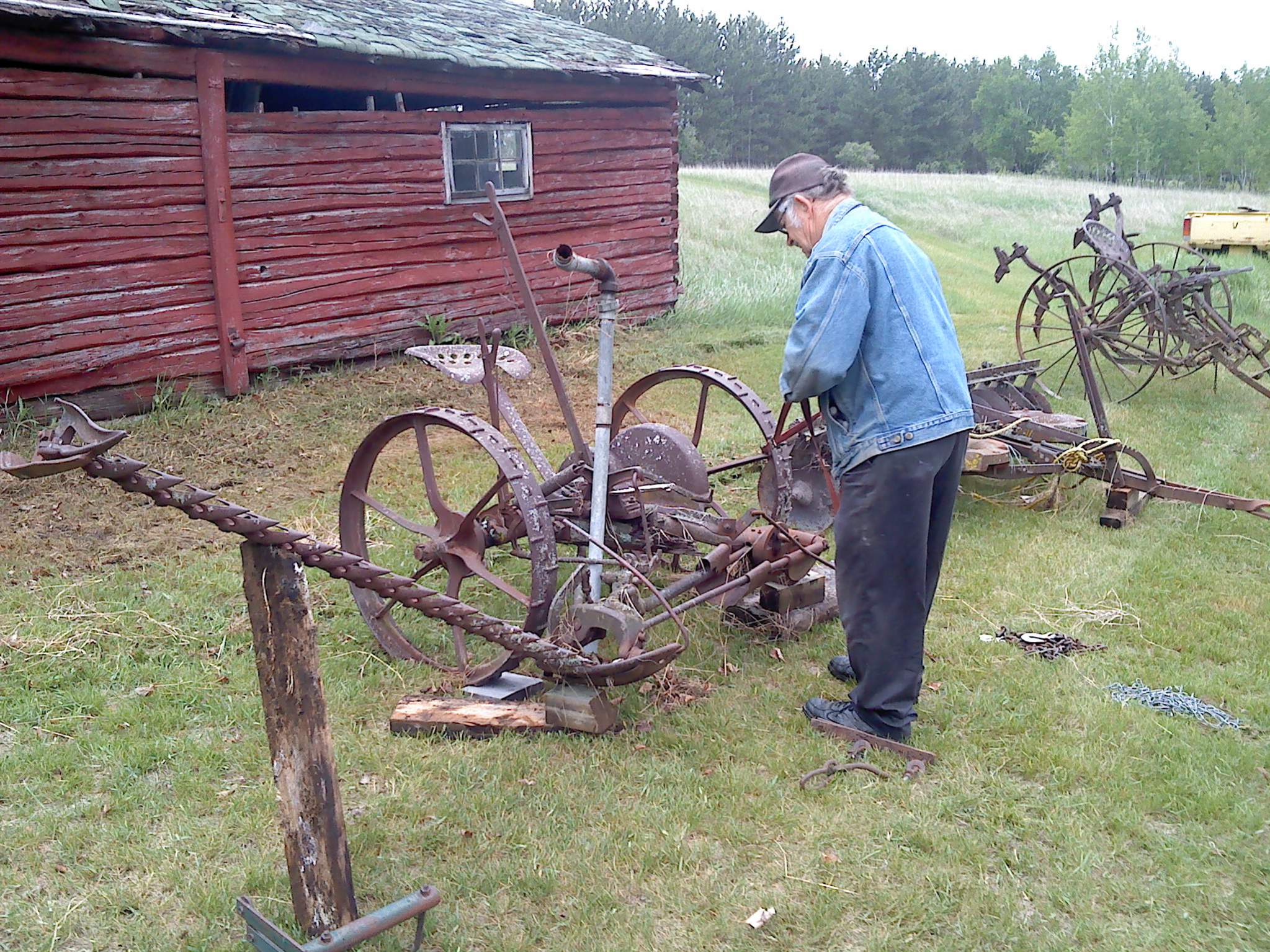

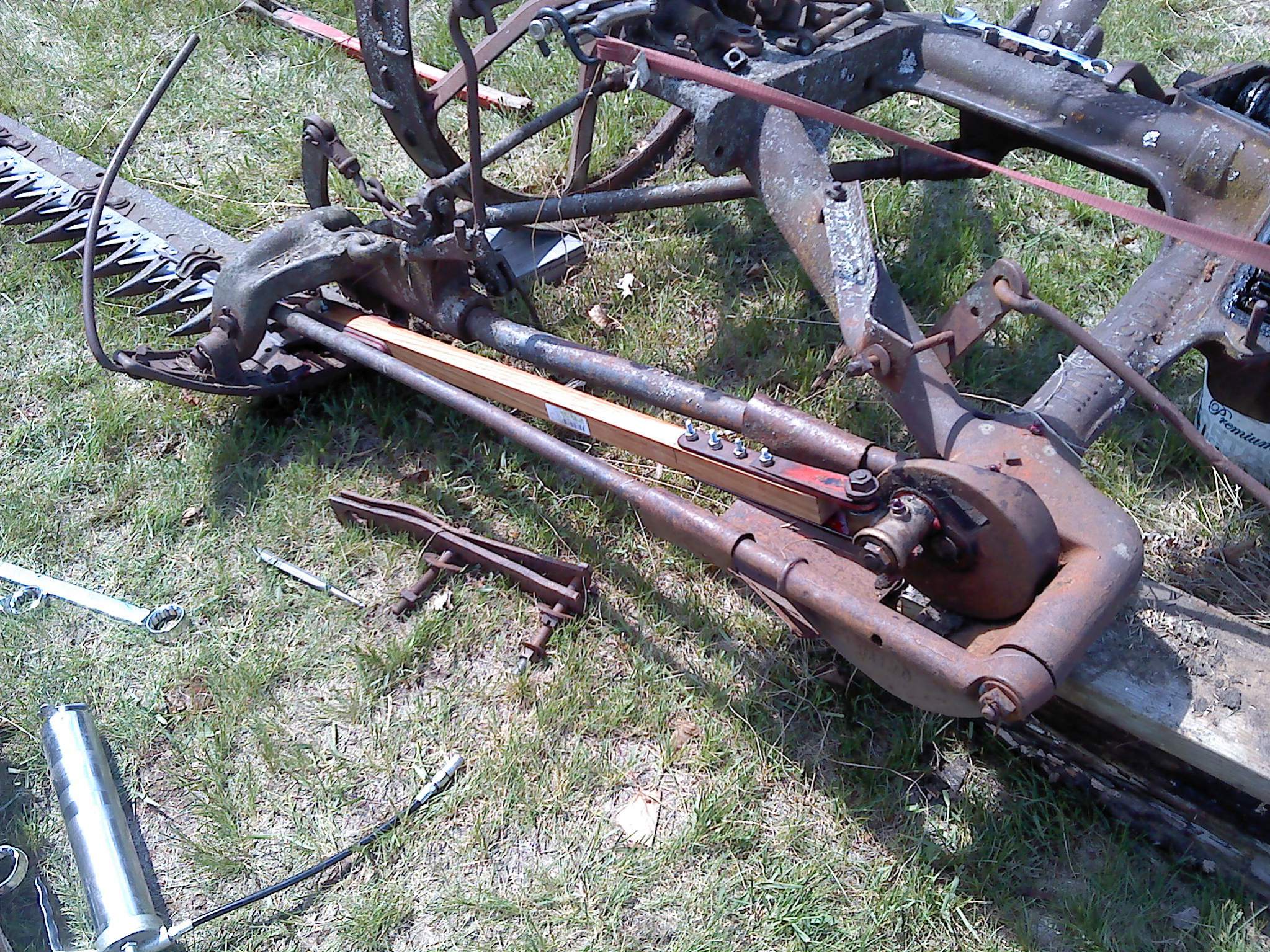

Two years ago, my dad and I pulled an old Minnesota No. 4 mower out of the woods. It belonged to my wife's father and grandfather before him. It just seemed right to restore the beast, seeing as it's been in the family so long. We've spent the last couple years searching for a supplier o sickle sections that will fit this beast and were happy to find we can get them locally, as well as a replacement Pittman arm. The draw-bar was made from a piece of ash, taken from a tree that fell in our yard a couple years ago. We then welded up a couple of pieces and freed up and lubed all moving parts. The result is we now have a working 5' sickle mower!
My dad was very eager to relive his childhood and climb on the mower and operate it for our initial test run. Everything worked without a hitch. I think he felt like a kid on a carnival ride!
Next, we have an old dump rake to drag out and tackle. After this, it wil be a piece of cake!
Yes, everything will be painted eventually. First, we get them running, then we worry about cosmetics.
Joe

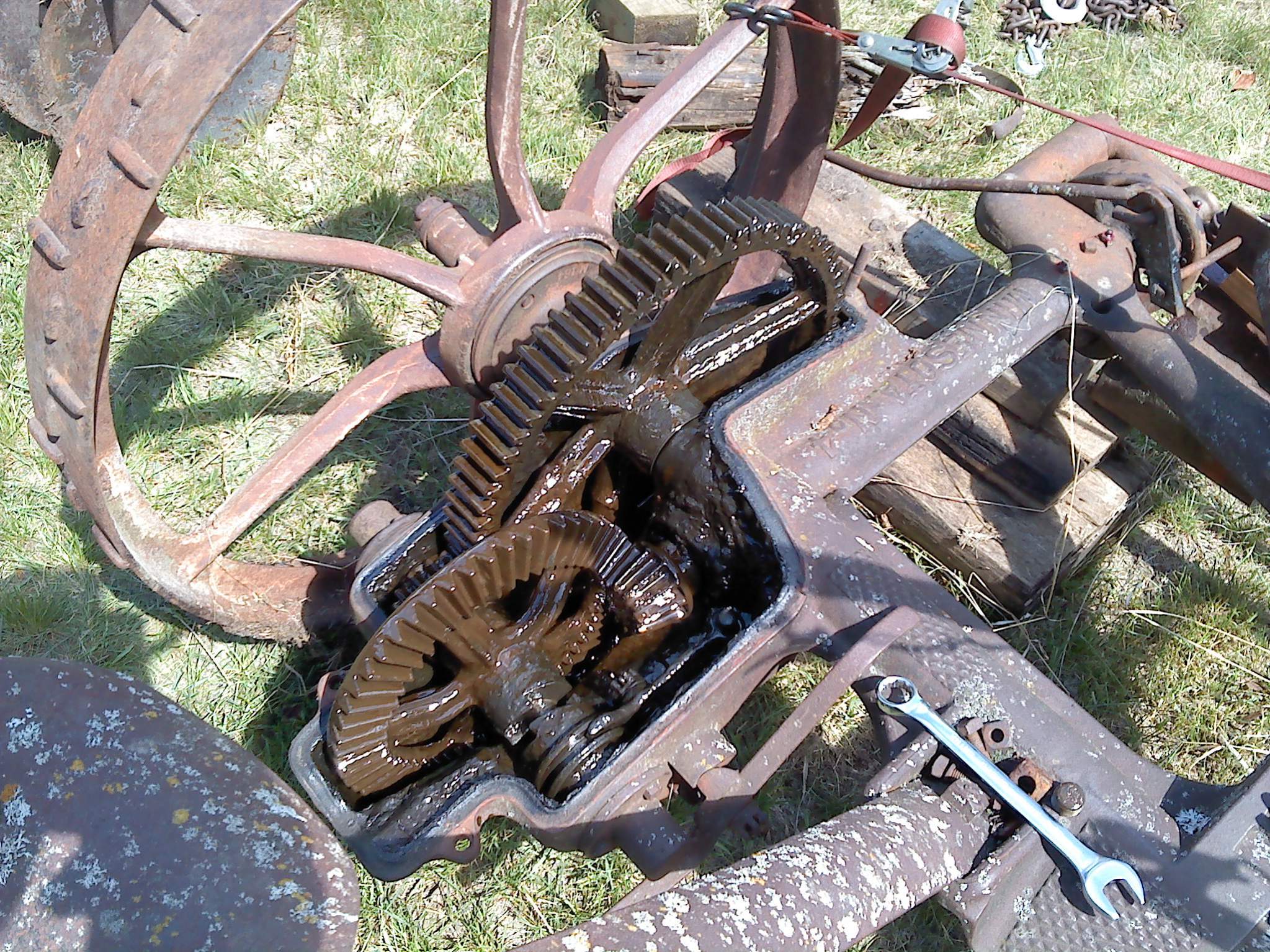

Thanks!
All the zerks were shot up with lithium grease. The oil ports were filled with 40wt. motor oil. The only odd thing we did a little different was the gearbox. It was found filled with a slurry of oil, water and sludge. We drained off most of the water (all we could separate, at least) and filled the gearbox with old diesel oil, as it will clean and lubricate at the same time. We'll run it in diesel for a bit to really slosh everything inside real good. Once we're satisfied with that, we'll open it up, take a parts brush to whatever we can reach, scrub it as good as possible, drain it, and fill it with gear lube.
The mower will be painted to as close to original colors as we can manage. Horse drawn implements were often quite colorful, and Minnesota mowers were no exception. Pictures of original paint jobs are incredibly rare, but we have a catalog reprint with colored ink drawings, so they will have to suffice.
