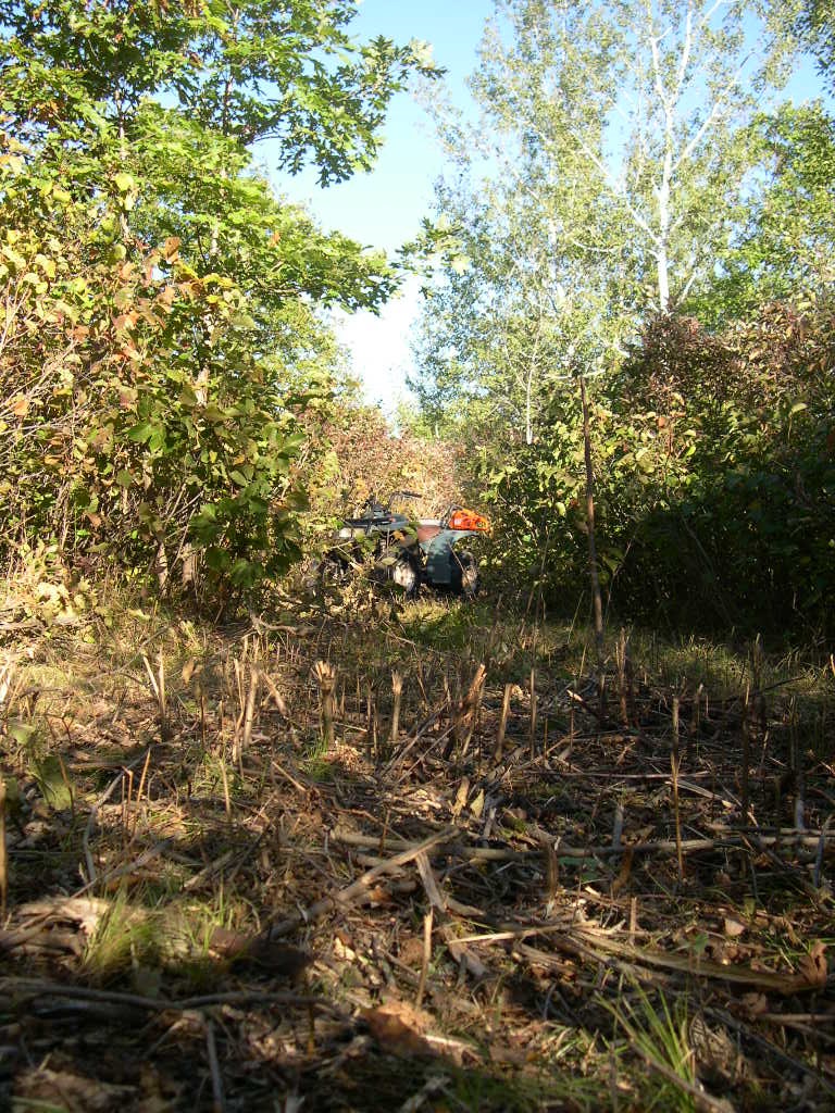

I cut 8' tall brush with a 15hp tractor. I think you should be able to do what you need with a 35-45hp tractor.
