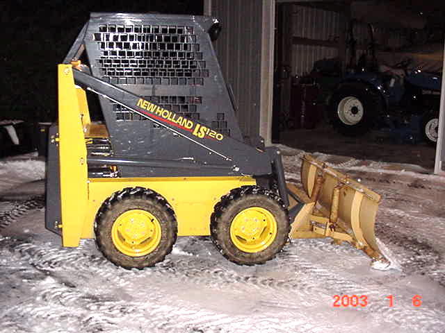

Attached is a picture of the snow blade attachment I made for my NH skidsteer..........I started with a $50 myers plow I found behind the storage lot at a local towing facility. Bought $30 worth of 1/2" plate and bar stock and fabbed up a plate to fit the quick tach bracket on my ss loader. I cut 12" off each end of the blade due to the small size of my skidsteer leaving just over 5' of width.....I cut the A frame bracket on the plow shorter and added vertical reinforcements to each side of the shortened A frame..........I use the plow with the loader valve in the float position...........If you built a similiar attachment for a FEL you could use the original snow plow lift chain setup attached to the quicktach (at the top of the bracket ) and use the curl valve (bucket control) to raise/lower the blade.... All in all an inexpensive solution to the snow removal problem

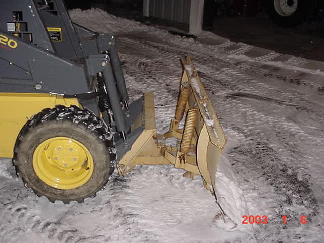

Close up of mounting bracket

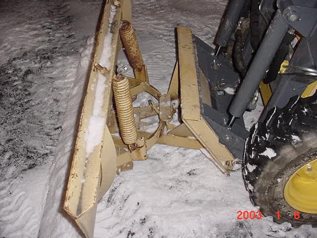

3rd view

Certainly looks like that should move some snow.
