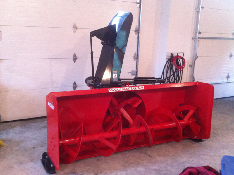

I know the rules, no pictures , it did not happen! He is my new blizzard rad 84. I just ensured a snow free winter for all of central Massachusetts.
Dave
/ 1 auger or 2 ? #13
Nice unit...!!! You might get lucky and scare the snow away some, but if not..... YOU ARE PREPARED.. !!! :)
